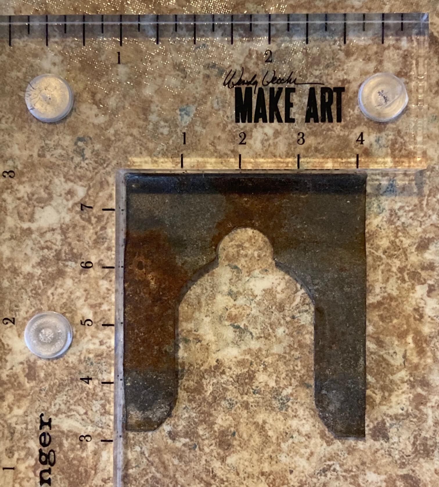

I do have this one, as you can see it is the largest clip on the car. A little clean up needed.
2 hours ago, Terrapin Z said:
That one you linked to at ZCD is too small for the hatch lock. It is for the early Series One fuel door latch.
Apparently ZCD didn't offer one my bad ^^   I tried MSA and they list one but it is out of stock. (discontinued, same at Nissan)
