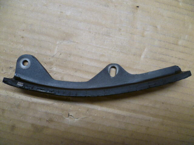

What about the timing chain guides (not the valve guides)? Did you replace those with new or are they the same ones that were in the engine when you started? This is one of the guides I'm talking about:

Figures, guess I didn't think about that with the head gasket. The guides are new so yeah I replaced those, the old ones were worn. Okay, guess I'll have to either have to ask my friend to hold onto the car a little longer or pay a really expensive tow truck fee.
