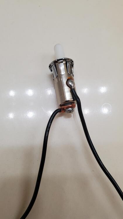

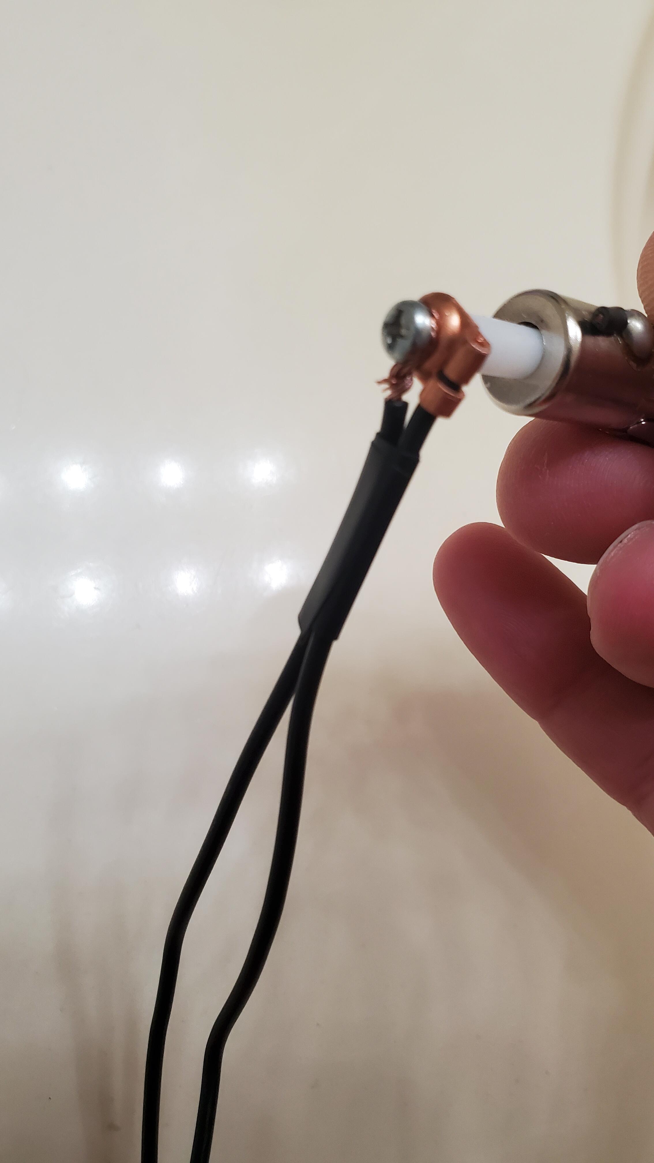

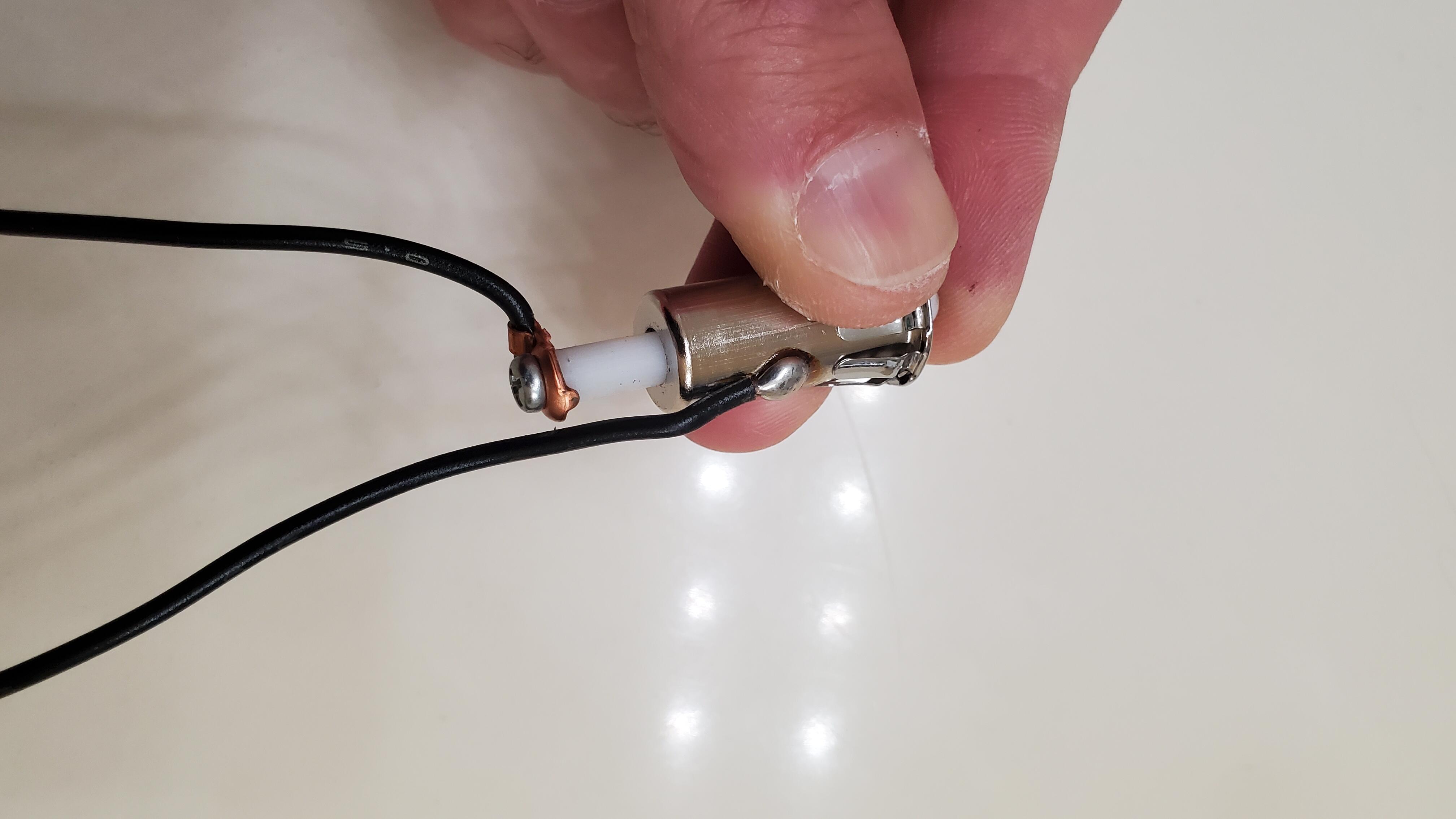

Just wanted to finish up what I started.  My issue was the new door switch the PO put in.  To recap, it was a two wire and both wires were connected properly to the ground wires for the dome light and the buzzer circuit.  What the issue was, and I can't understand how the PO didn't address this, was that these new door switches have one wire on constant ground.  That was the wire he had connected to the buzzer.  He had the switched ground luckily enough connected to the dome light.
So all I did was change the second wire to switched
All is right and the buzzer that is straight from hell works as it should!
Ah, that makes sense. The housing of the door switch doesn't need it's own grounding wire as it is grounded on the sheet metal as it is pushed into the hole on the door jam. The dome light, door switch circuit has always baffled me, thanks.
I'm thinking now these new switches come with the one wire attached to the housing for applications where the body ground isn't available by contact with a metal surface like the door jamb.  So if you insert this in some plastic piece you can supply ground to the switch via that soldered wire to complete the grounding circuit.
