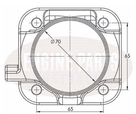

Hey guys! I am away from the car at the moment and I wonder if anyone knows the throttle body bolt spacing for the N42 intake manifold on the 76 280Z. I am looking at an aftermarket 70mm throttle body with 65mm bolt spacing. I seem to remember the stock throttle body was 60mm...?

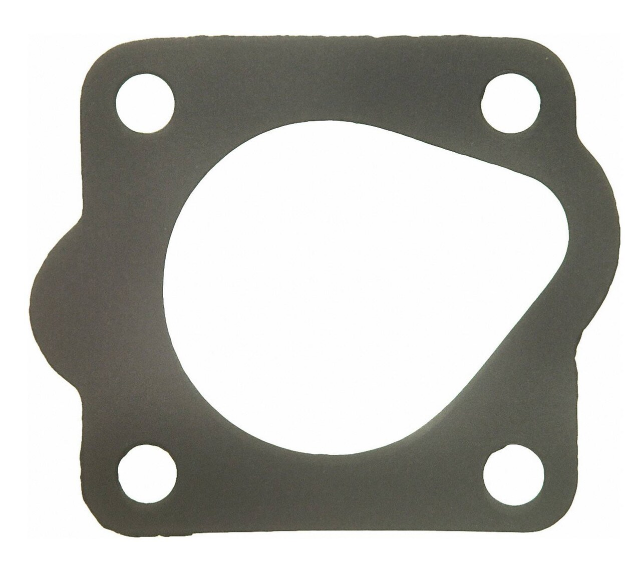

You could go to an auto parts store and measure or buy a gasket.  Don't you have a manifold to measure from?
https://www.oreillyauto.com/search/v/a/6635/automotive-car-1976-nissan-280z?q=throttle+body+gasket
Oh.  Be careful with any information you find or get.  I see some bad guesses out there.  ZCD is selling a throttle body that he says will fit both Z and ZX.  But I know that the bolt patterns are different, I've had both.  My memory says that the ZX pattern and opening is smaller.  A ZX TB will not fit a Z intake manifold and vice-versa.

The stock throttle body mounting bolts are on a 60mm square.

I'll go ahead and ask before CO does - is your ported port 70 mm across?  Doesn't look it.  70 mm would be outside the 60 mm centerline of the screw holes.  You'll need an adapter with a neck-down transition.  Kind of defeating the point.

Darn… now I need to figure out an adapter for mounting the 65mm square throttle body.
Well there's the obvious solutions... Weld the holes shut and drill new, or make an adapter plate? Adapter plate is a little complicated because of the bolt holes all wanting to be in the same locations. Could weld the plate into position or clock the new throttle body 45 degrees to put the mounting holes in a different location.
