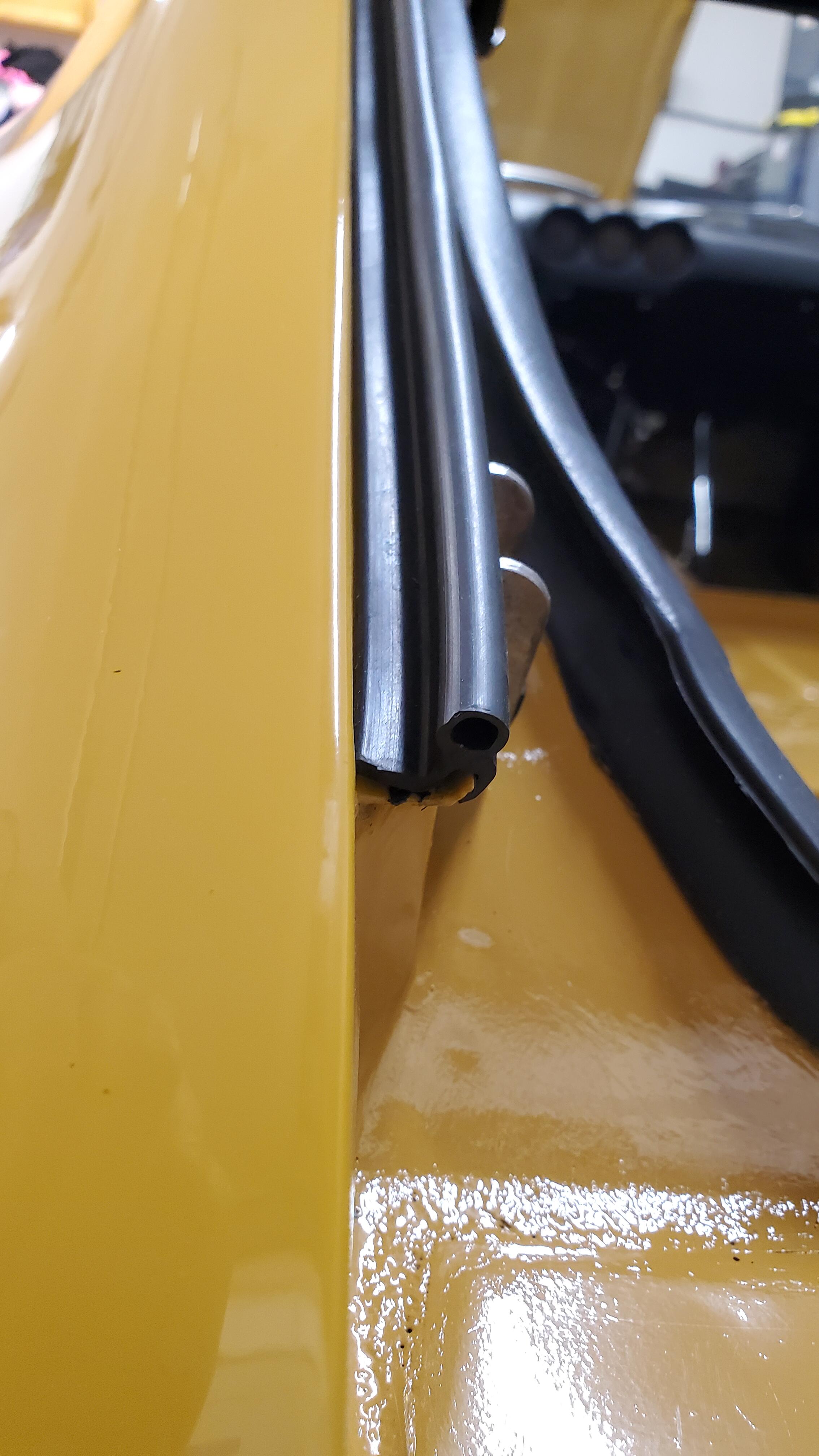

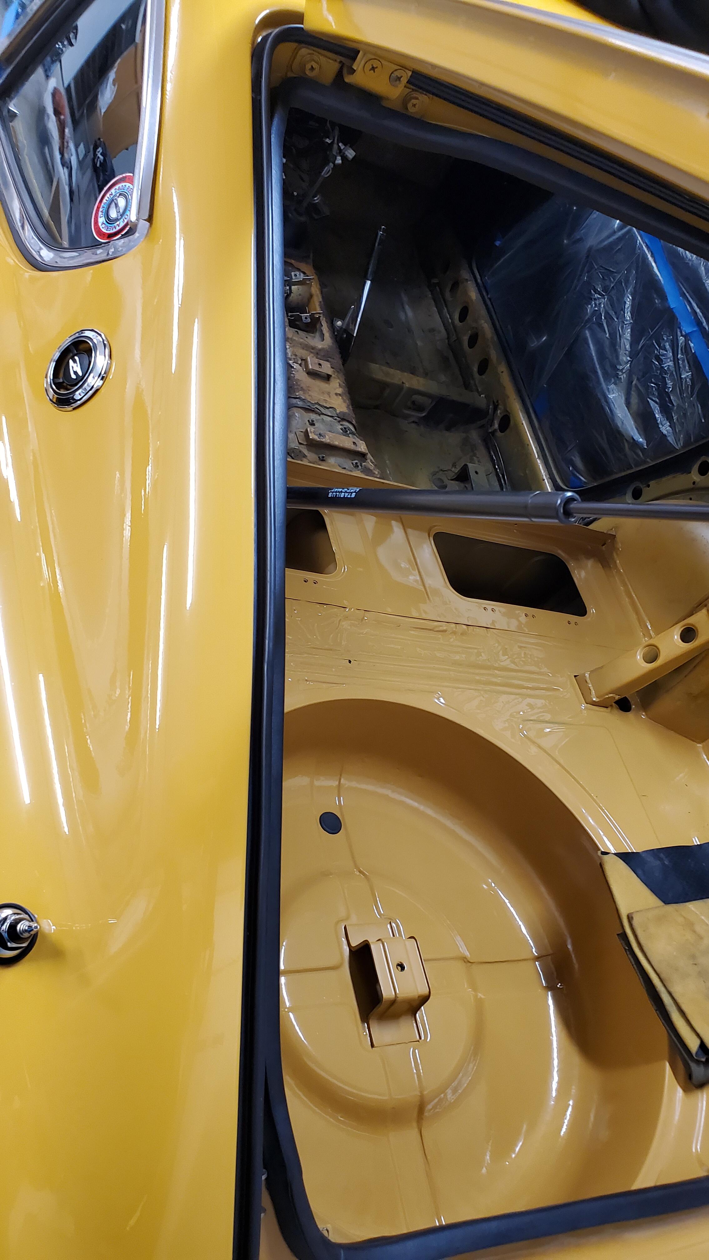

2 hours ago, kcpope said:
No adhesive required. Which is very nice cuz I hate cleaning that stuff up. The seal itself has a malleable metal channel molded into it that gives it “teeth” to stay put.
That's not for the hatch.
But it works fine just the same, I had that style of seal on the hatch of my 240z for years and never leaked.
Like grannyknot said, it’s not technically OEM style. But it works OK, looks clean, and doesn’t require glue. It’s very similar to the Kia seal that everyone’s been using, which is NLA, unless you find one at a junkyard. This one is cheap and readily available on Amazon.

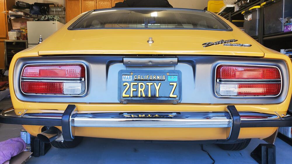

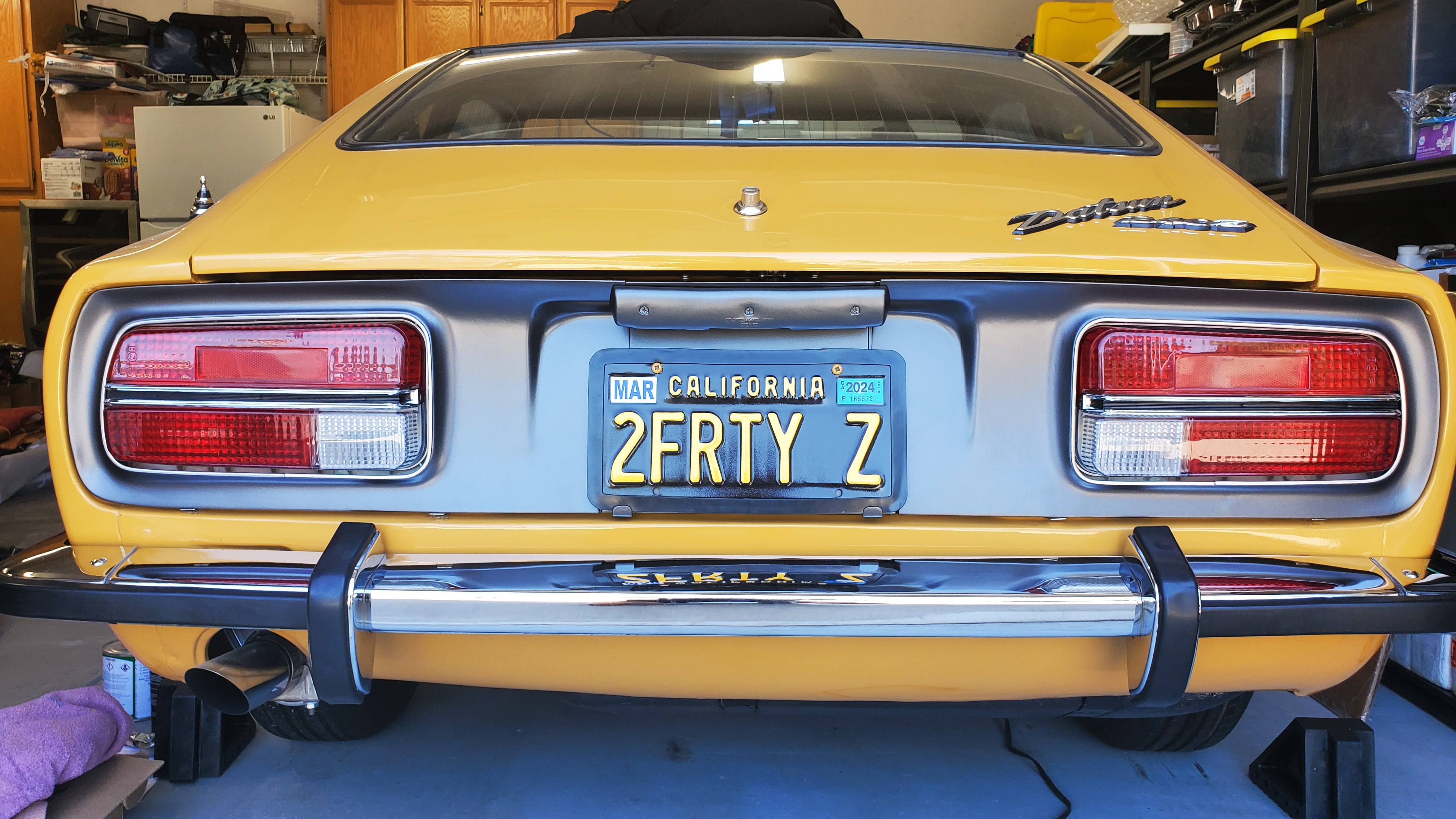

I must have gotten lucky because I recently bought the inner and outer seal from Z store and they both fit perfectly with just the 3m adhesive.  the outer seal was the single seal bulb that went all the way around rather than the separate top and two sides they offer like original.  I have no issues closing hatch and it lines up almost perfect.  It is a tad higher as you can see but no where near enough to not latch.
Nice, looks clean[emoji1360]
As is typical with my car, nothing ever seems to be plug and play.
Do you know if the seal you received from Z store was a Precision brand seal? I’m assuming it was, but just curious.
I'm pretty sure it was but looking back at my records it was actually purchased late 21 not this year but I just got around to replacing it due to a back surgery.  Maybe they have changed the mold or something to make them slightly different?  This was the part number for outer
https://www.thezstore.com/product/5487/rear-deck-outer-weatherstrip-one-piece-top-sides-70-78-240z-260z-280z-coupe
and this was the inner
https://www.thezstore.com/product/5735/reproduction-rear-deck-inner-weatherstrip-70-78-240z-260z-280z-coupe
I bought this car in early 21 and the PO had fubar'd lots of stuff I'm just getting to.  To be honest I didn't note the hatch being off line a tad before I replaced this so maybe he also had a precision and somehow shimmed the hinges to accommodate.  When I replaced my seals I didn't take the hatch or hinges off since it was only me and my recent surgery wouldn't allow for that much weight.
