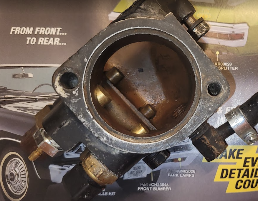

Since I was going to be sidelined for awhile waiting for the new switch to arrive from Z Car Depot, I decided now would be a good time to flush out the coolant, replace the thermostat, etc.  No good deed goes unpunished.  I found one of the thermostat lower housing bolt holes to be over-bored and filled with thread sealer:
Of course I discovered this after I had reconnected everything, got my 280Z to start, and then when the T-stat opened, it showered the connections and proceeded to cause a short and burned up my fusible links.  :facepalm:

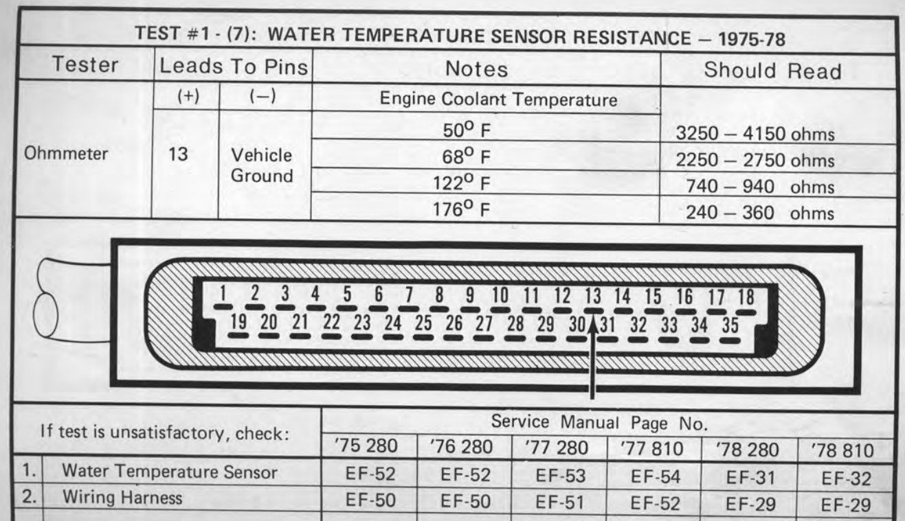

The FSM instruction comes after the test of resistance at Pin 13 at the ECU connector.  The assumption is that the temperature circuit is complete and working correctly all the way to the ECU.  You need to be sure that the ECU is getting the proper information.  Measure resistance at the pins and compare to the table of resistance versus temperature.
From the 1981 Guide -
Thanks!  I will test the resistance at the ECU next.  I'll be looking for a higher resistance reading since it is starting to get cooler here and my garage is not insulated.
