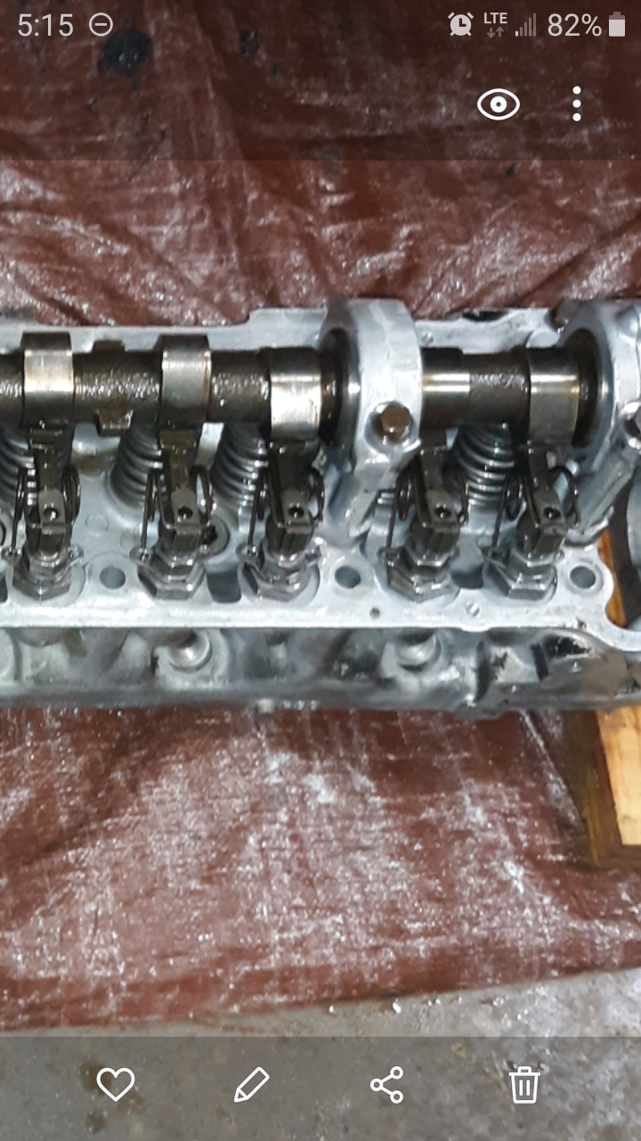

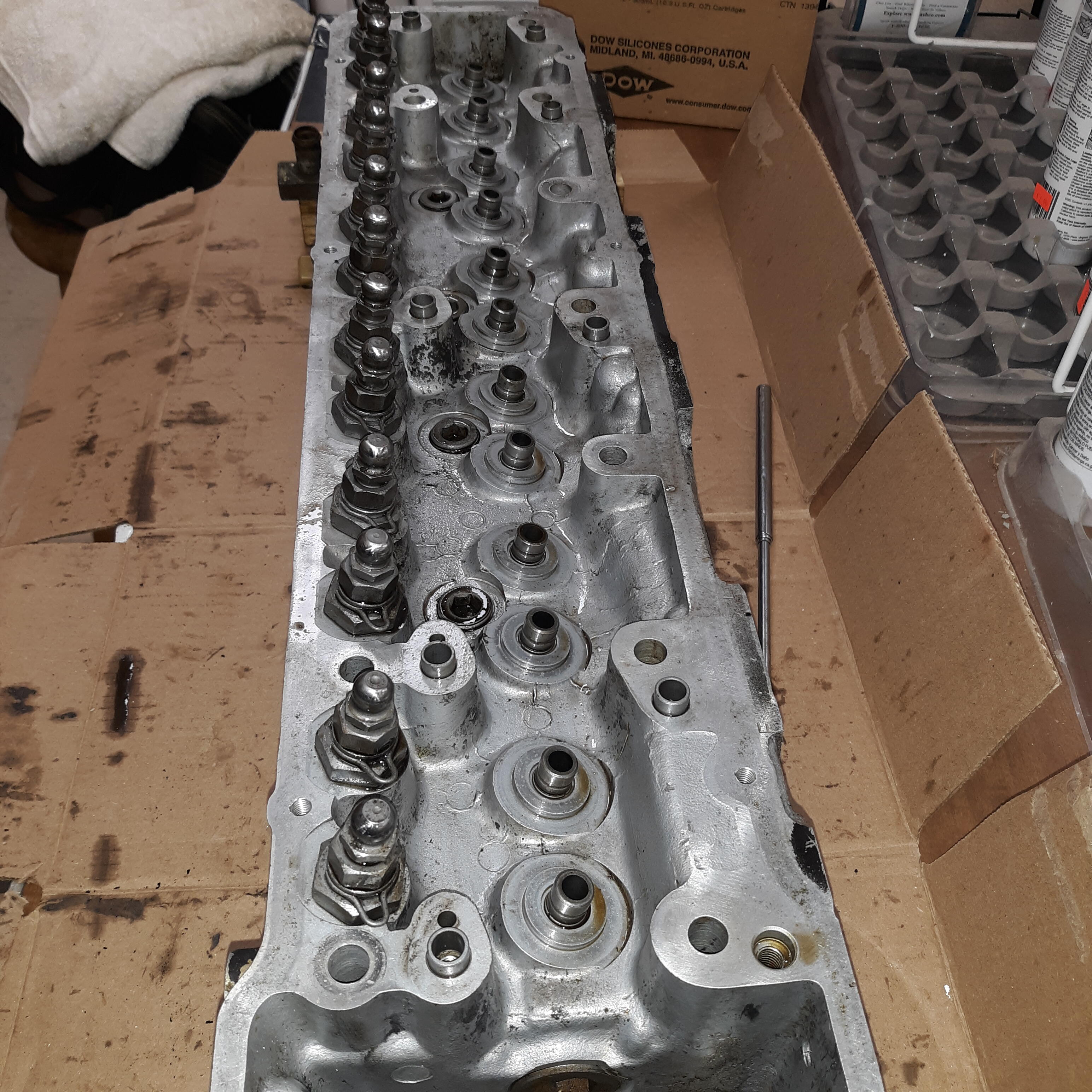

Posted April 16, 20232 yr comment_652621 I'm going to try and take pictures of this paper weight as I make it lighter. Bought it from a guy that works at a scrapyard. $20 dollar scrap price but an old friend that works there knew what a Datsun 280ZX was and gave him $25. Called me and now it's my toy for the next month or so. With you guys asking about it I'll get it done. Pictures so far. Link to comment https://www.classiczcars.com/forums/topic/68277-p90-images/ Share on other sites More sharing options...

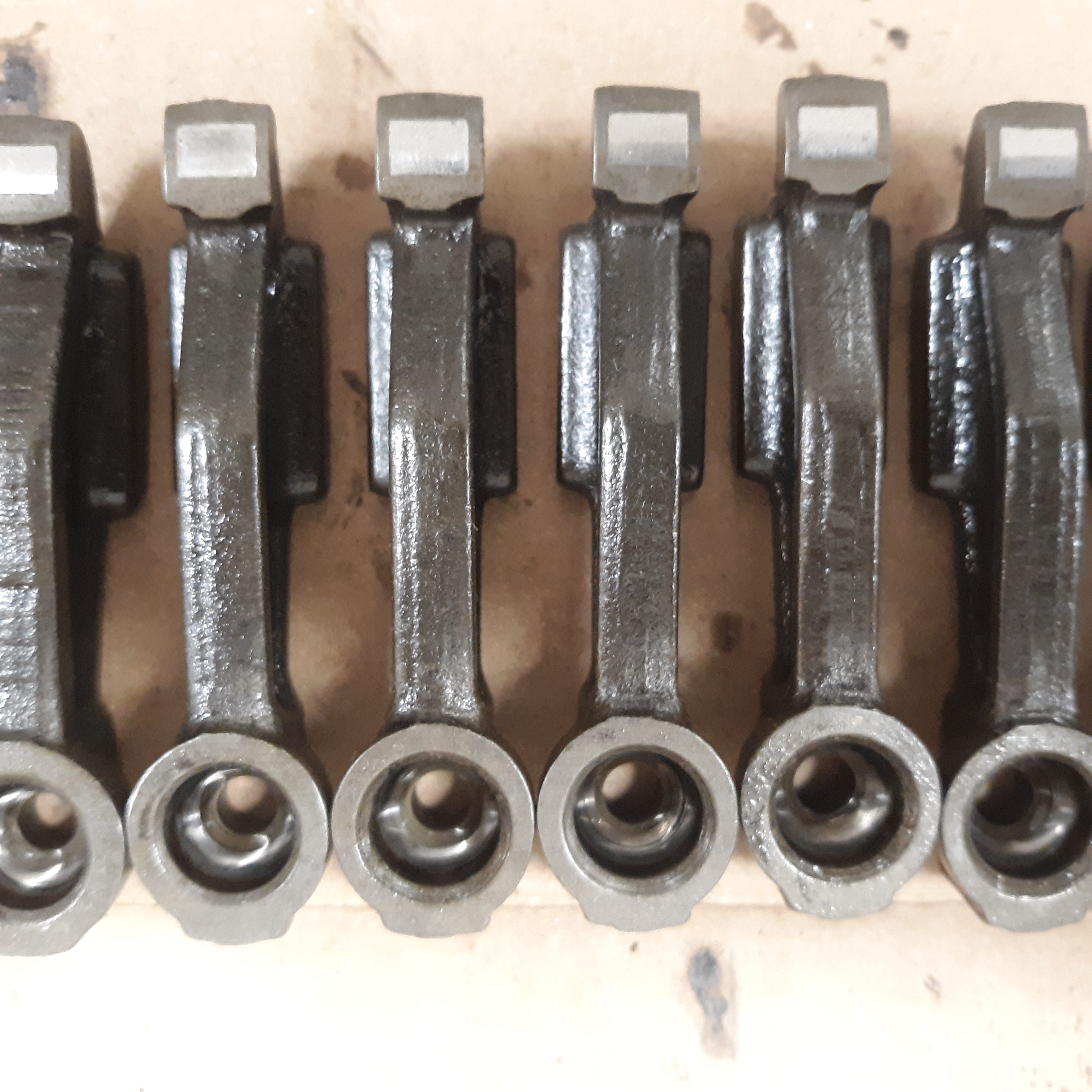

April 17, 20232 yr comment_652631 Are those the solid rocker arm pivots? They look adjustable. Should be fun. What will you do with it when it's done? And, have to ask - what is all of that stuff? Link to comment https://www.classiczcars.com/forums/topic/68277-p90-images/#findComment-652631 Share on other sites More sharing options...

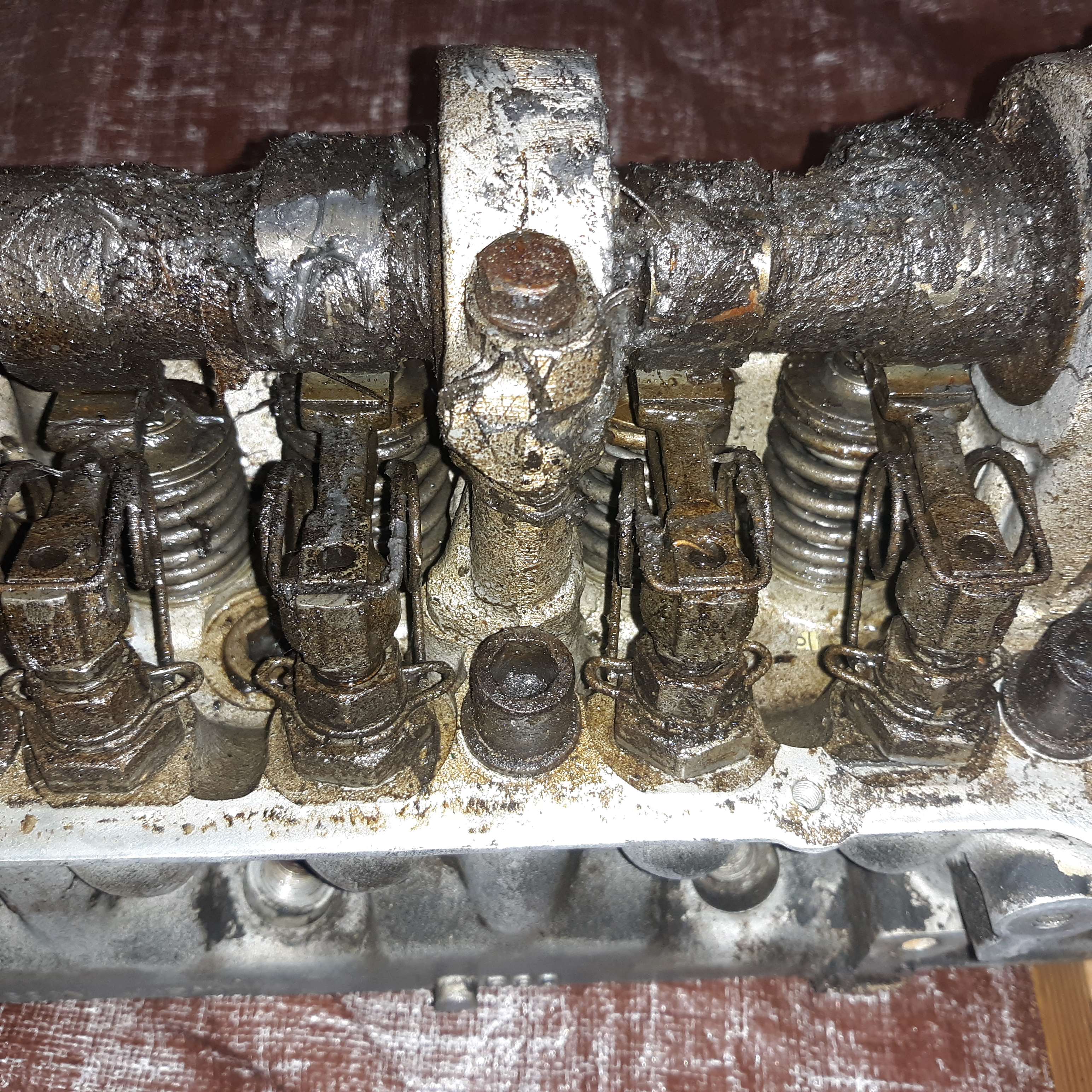

April 17, 20232 yr Author comment_652705 22 hours ago, Zed Head said: And, have to ask - what is all of that stuff? I feels soft and squishy like assembly lube. I'm thinking the p.o had the good sense to coat it real good before storage. Link to comment https://www.classiczcars.com/forums/topic/68277-p90-images/#findComment-652705 Share on other sites More sharing options...

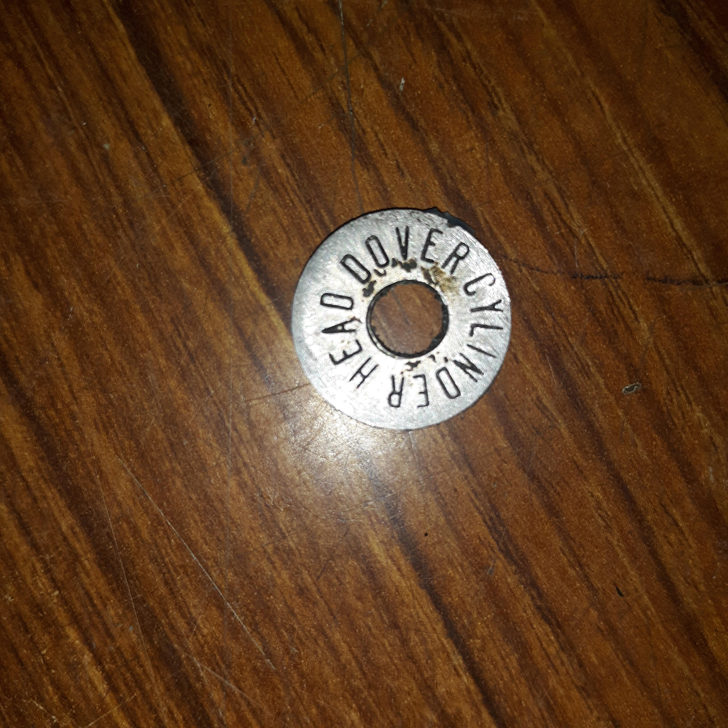

April 18, 20232 yr Author comment_652743 So far so good. Now I know why it was so clean and made that slight pop noise when the valves came out. Dover cylinder head did a refresh sometime in it's past. The heat sensor was on the rear. Edited April 18, 20232 yr by siteunseen Link to comment https://www.classiczcars.com/forums/topic/68277-p90-images/#findComment-652743 Share on other sites More sharing options...

April 18, 20232 yr comment_652746 Skimming is to increase compression ratio? Still not grasping the overall plan. It's basically a square exhaust port P79 head. Like building a flat-top piston 280ZX engine. If you put a cam in it all of those nice perfectly centered wear patterns go away. I guess I'm saying it has high value as-is. You could probably sell it or trade it for three or four heads that could really use some reworking. Edited April 18, 20232 yr by Zed Head Link to comment https://www.classiczcars.com/forums/topic/68277-p90-images/#findComment-652746 Share on other sites More sharing options...

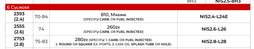

April 18, 20232 yr comment_652747 Here's Dover. Still in business. https://www.doverheads.com/ https://www.doverheads.com/wp-content/uploads/2021/07/Dover-Cylinder-Head-Catalog-2021_07.pdf Edited April 18, 20232 yr by Zed Head Link to comment https://www.classiczcars.com/forums/topic/68277-p90-images/#findComment-652747 Share on other sites More sharing options...
