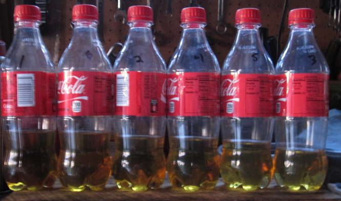

It could also be clogged injectors.  When I got my car it had been sitting for a while.  The injectors were unbalanced, some were under-squirting by quite a bit.
