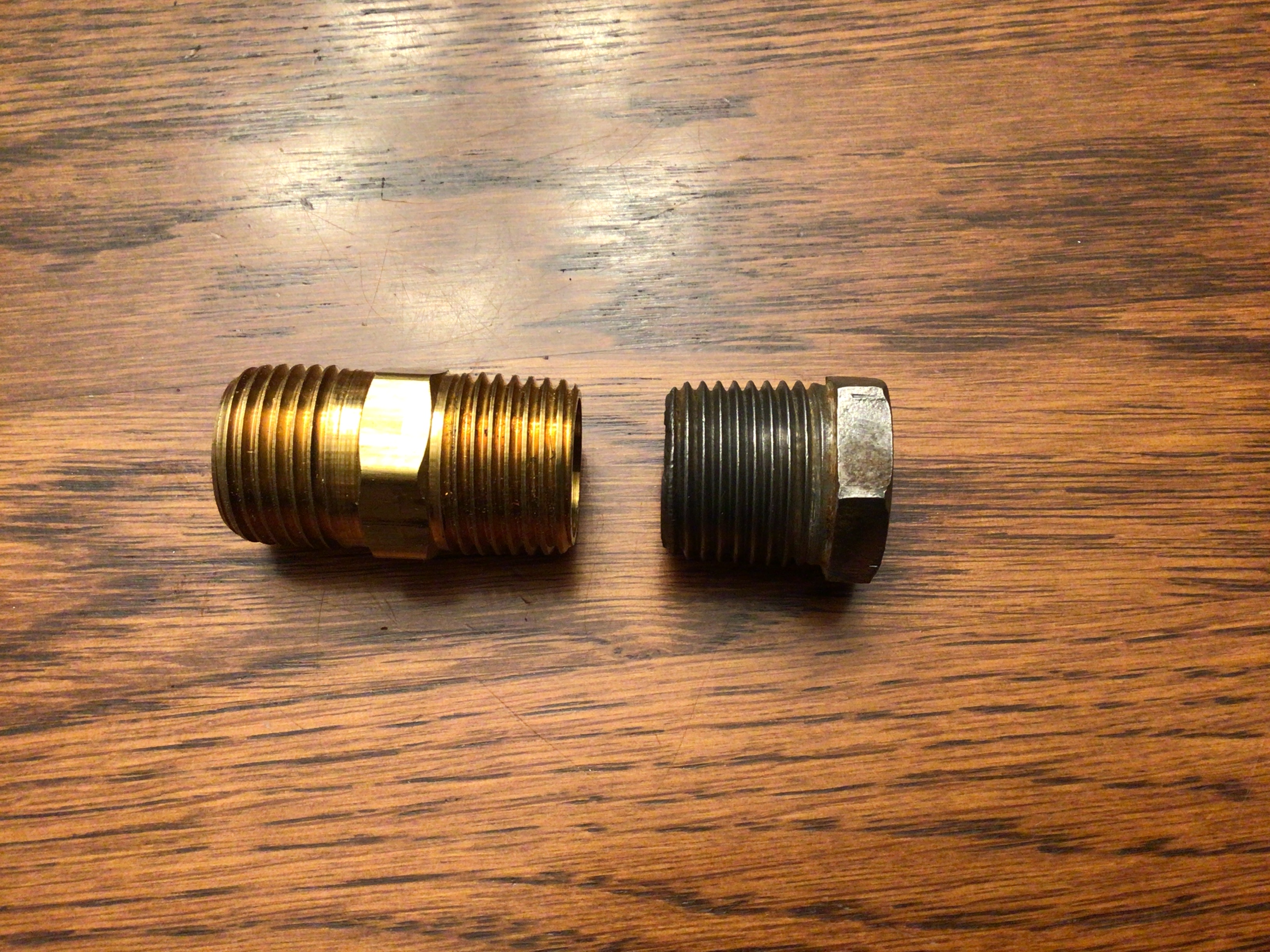

That hole is 1/2” BSPT threads.   In this case, since NPT is the same thread per inch as BSPT (14), you may get a 1/2 NPT plug to fit and seal if you have trouble sourcing a 1/2” BSPT plug.
1/2” NPT on the left, correct block plug with 1/2” BSPT on the right.
Edited by zKars

As mentioned, the item circled is the drain for the cooling jacket around the cylinders, and yes, there is a standard male pipe fitting that will fit. I always put a brass petcock in the engines I build, the brass conforms easily to the BSP threads, and I use a small amount of Teflon thread paste to ensure a good seal. Makes for easy draining of the cooling system for maintenance and tear downs.

Awesome. Thanks for the photo @zKars
I’ll pop that off and see what it’s like inside.  And see if I can source the right plug. I think that would allow for no thread tape, right? If not, the brass option should work too. Thanks @Racer X

I quit using thread tape when the Teflon thread paste came out. Easy enough to apply to one thread, one complete circuit around, and not the whole fitting. The tape is easily over used, with excess coming loose and going places you don’t want it.
And you need a thread sealant on BSP threads too, any tapered thread that is sealing fluids should have a sealant.
Edited by Racer X
Perfecto. I found a brass NPT plug at ace and Amazon has the sealant same day. Cross that part off at least 🙂
