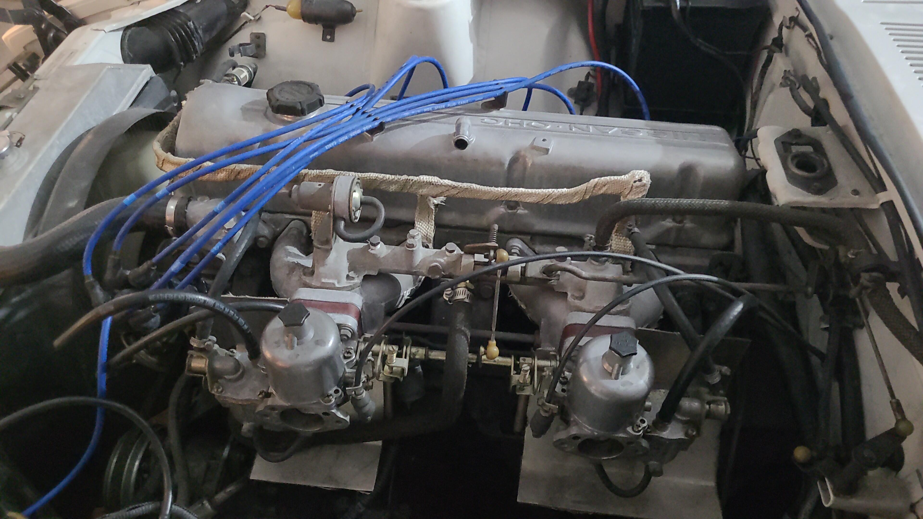

Lets all take a look at the carb and manifold picture if we can get one.

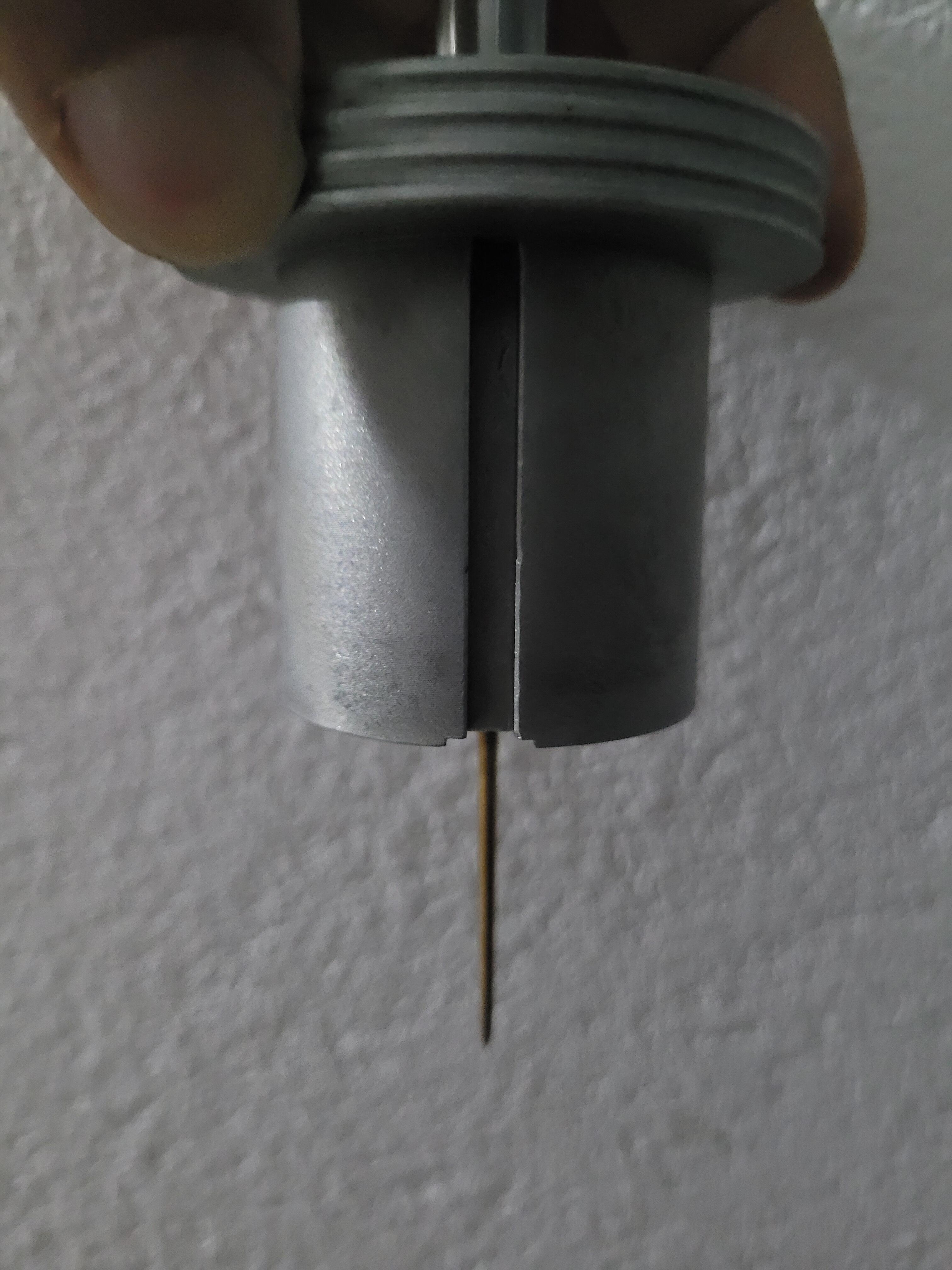

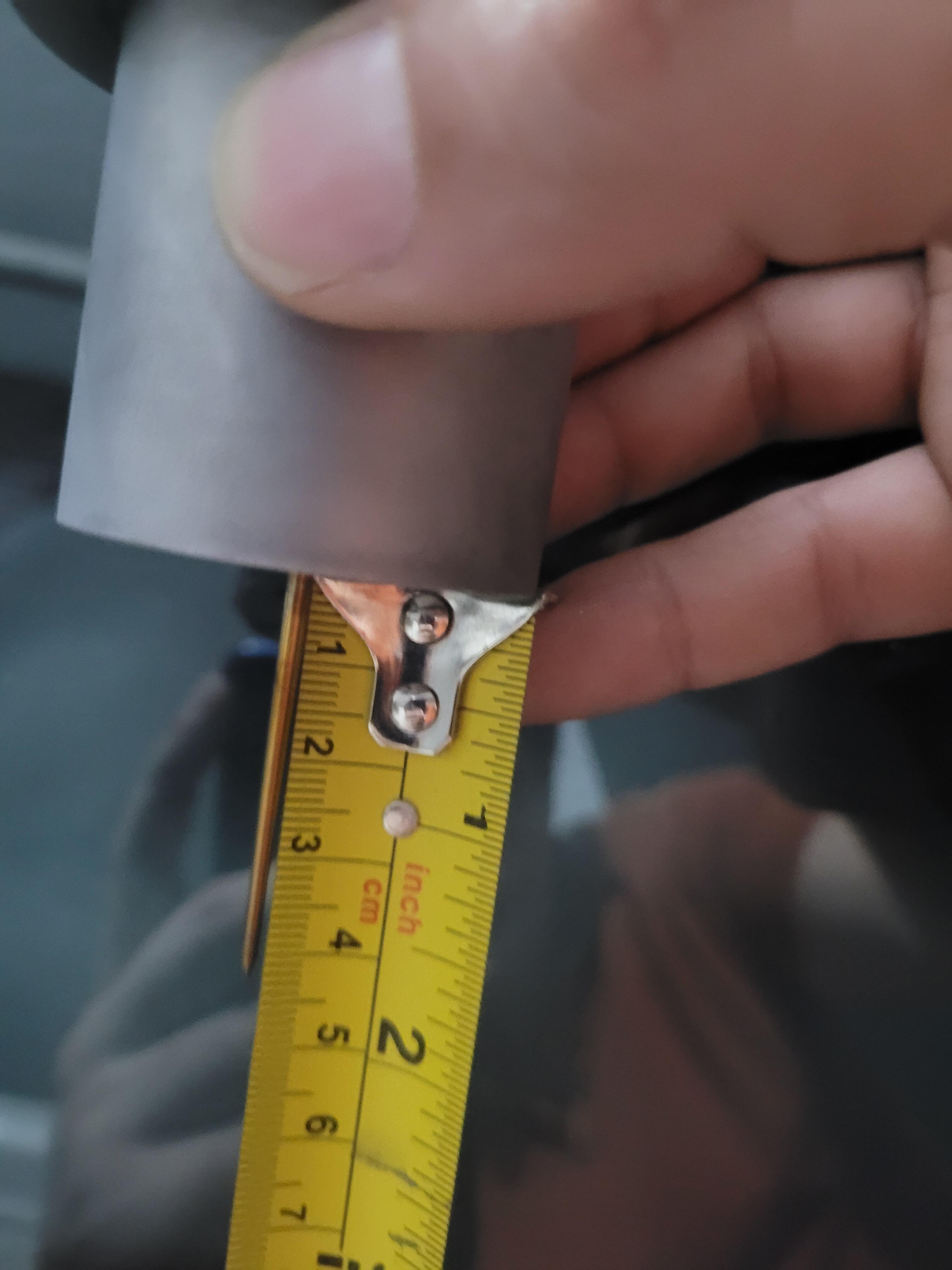

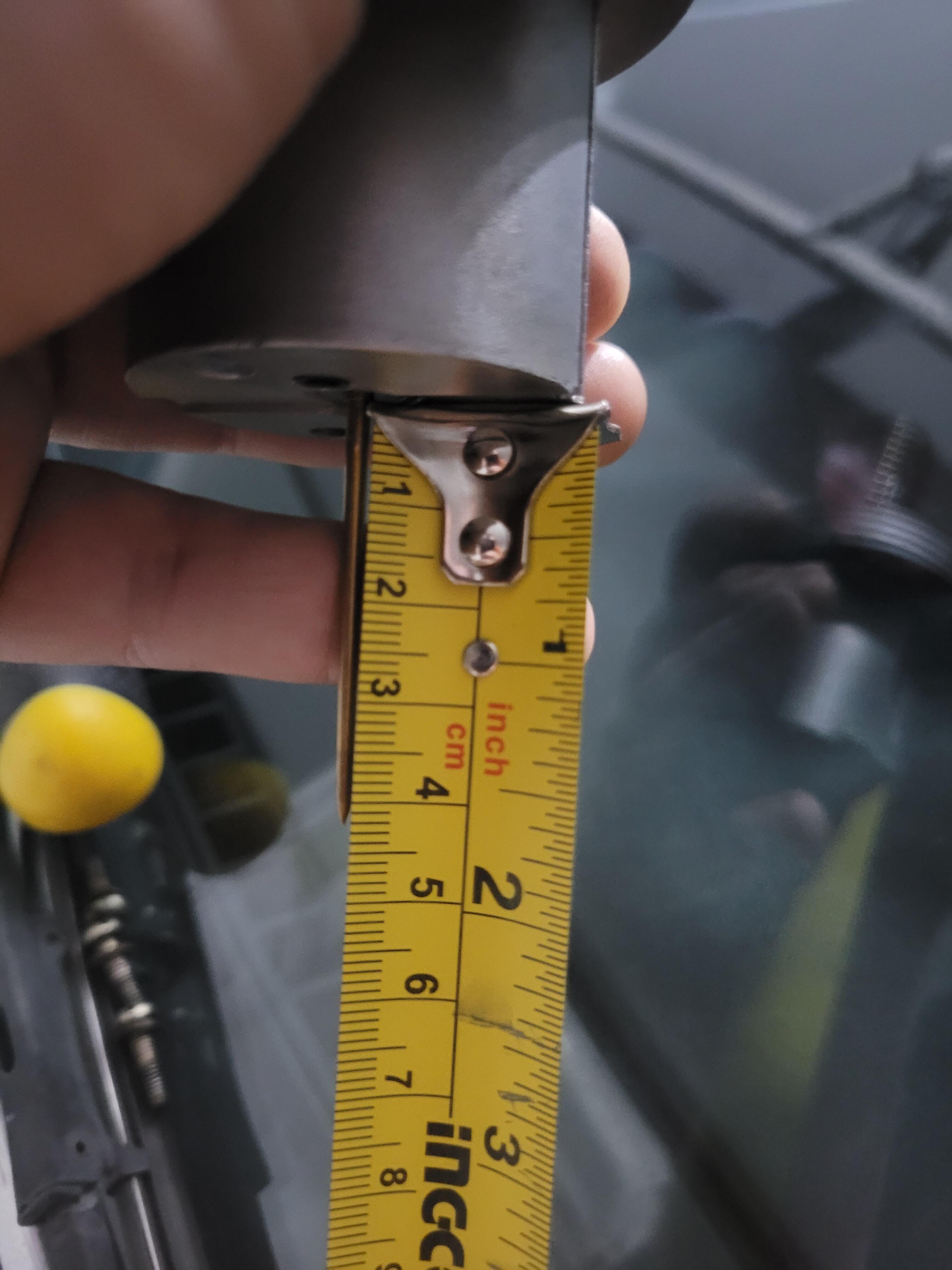

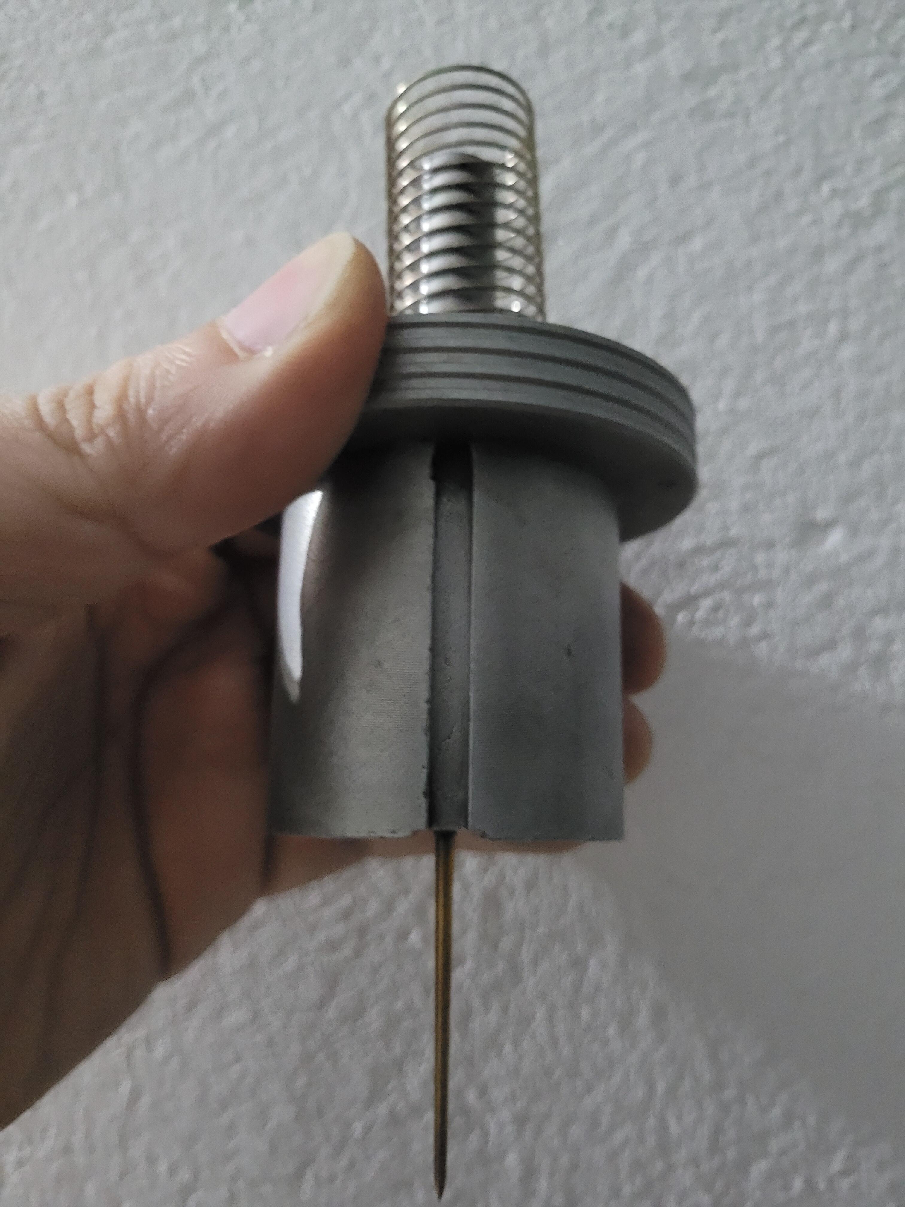

  We need to confirm the needles are installed in the pistons to the same depth. Measure from the piston bottoms to the tips of the needles. No need to unlock them and change their height if they're the same.

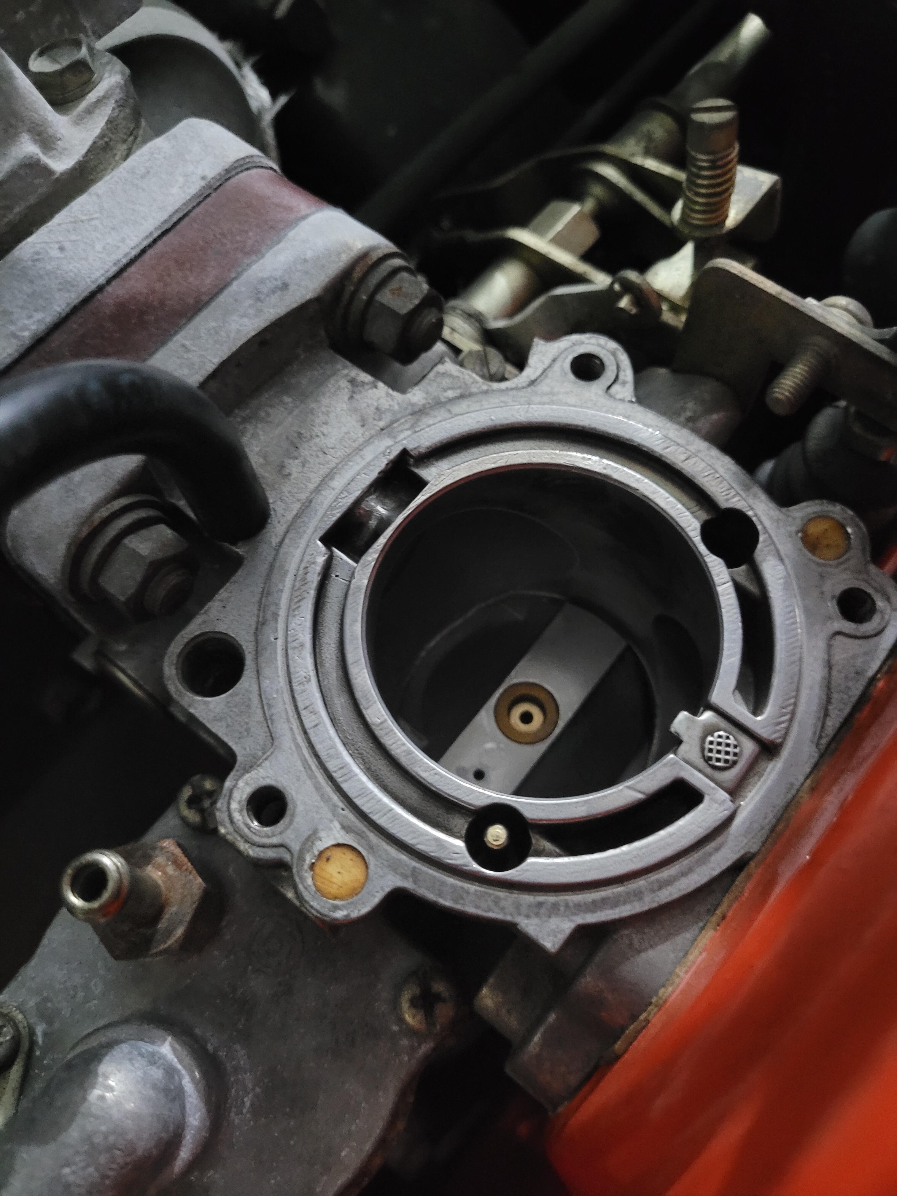

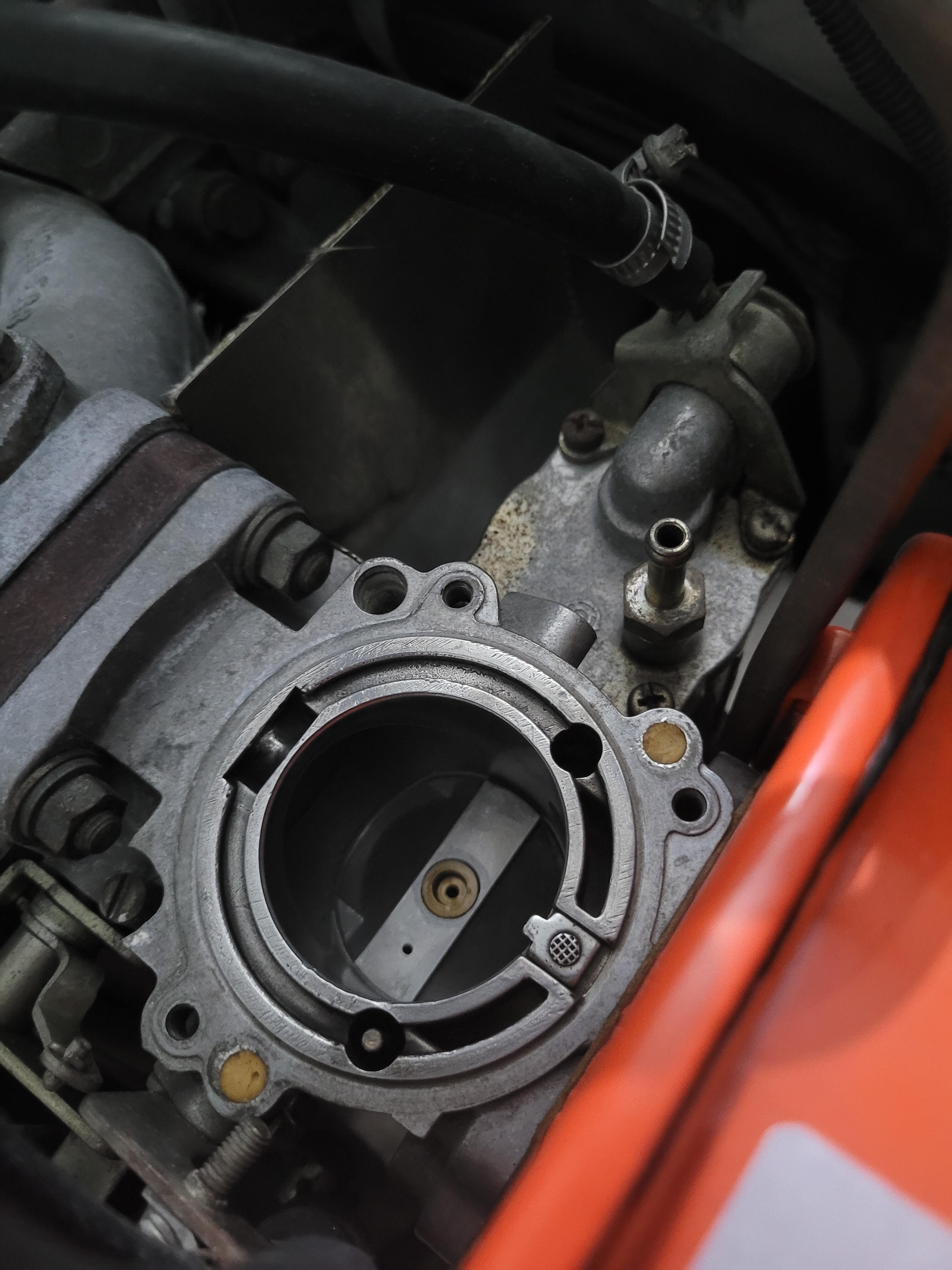

Pics of needles and bridge first front carb and next rear carb. 3.5 turns clockwise. 41 to 42 mm from base each needle.
Now I am going to say the carbs are likely correct.
1. I do believe the rear carb responds to mixture adjustments as it should.
2. I believe the front carb is not responding to mixture adjustments like it should.
3. Lets get our heads around that front carb. What would make it lean? Excess  air is likely.
