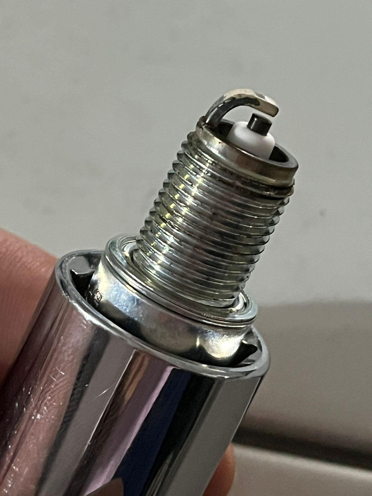

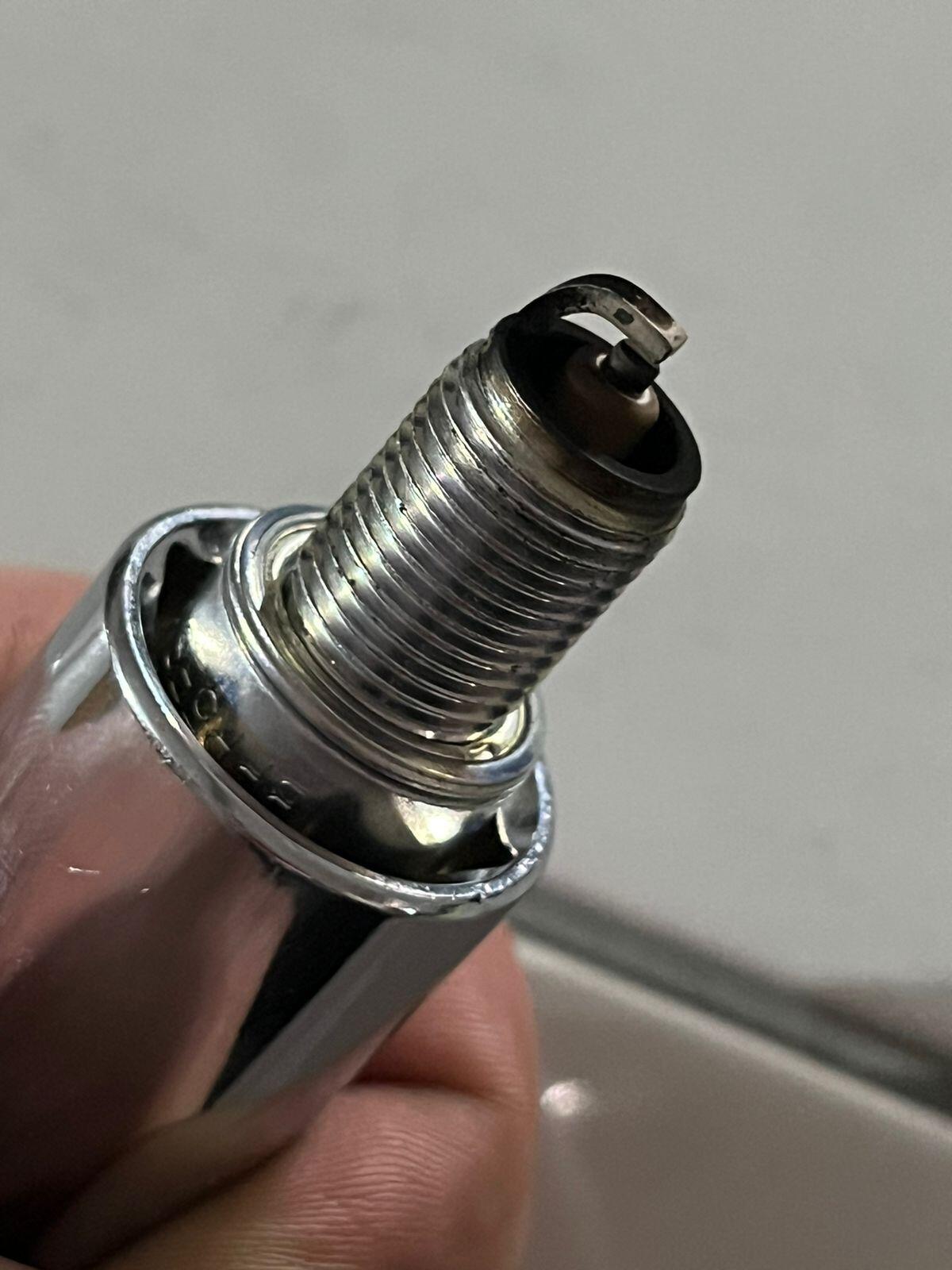

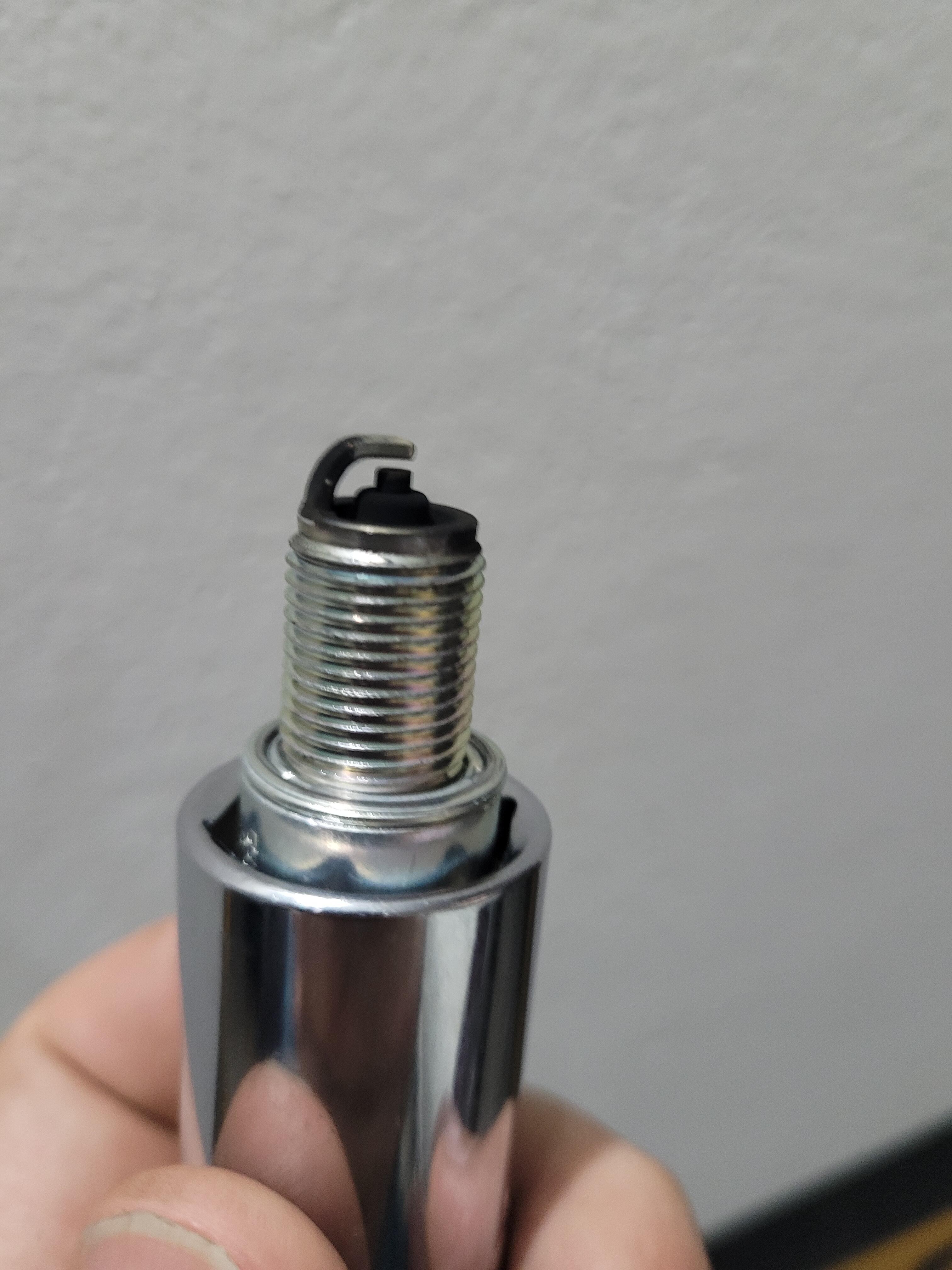

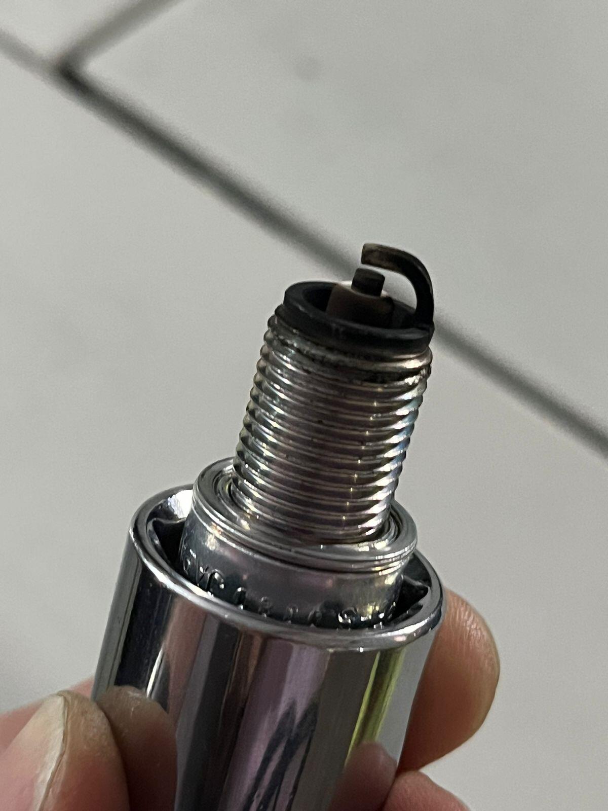

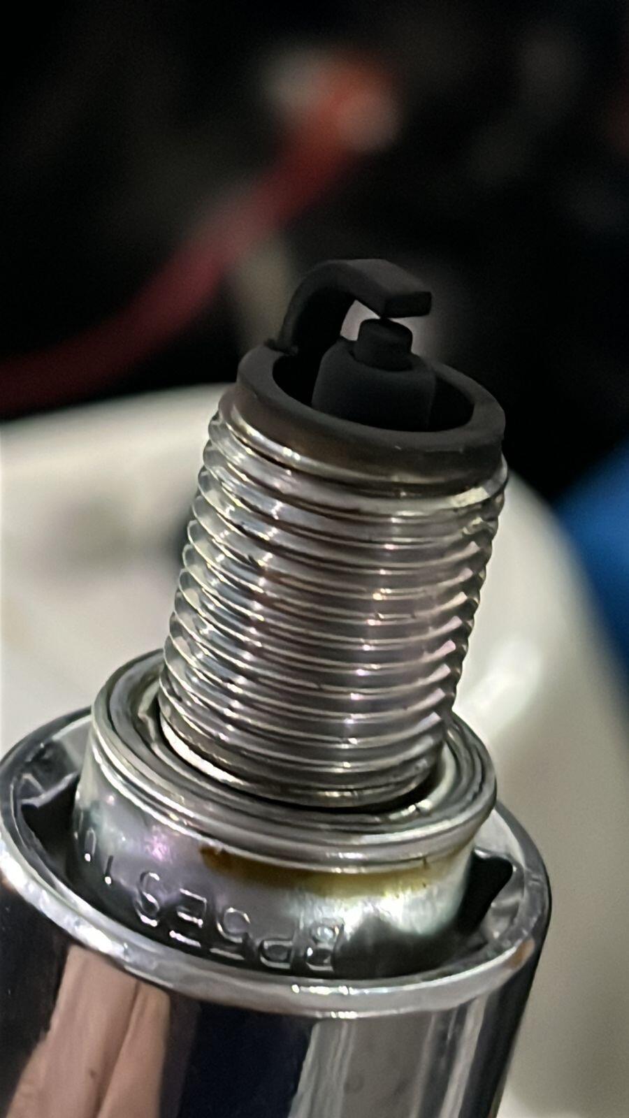

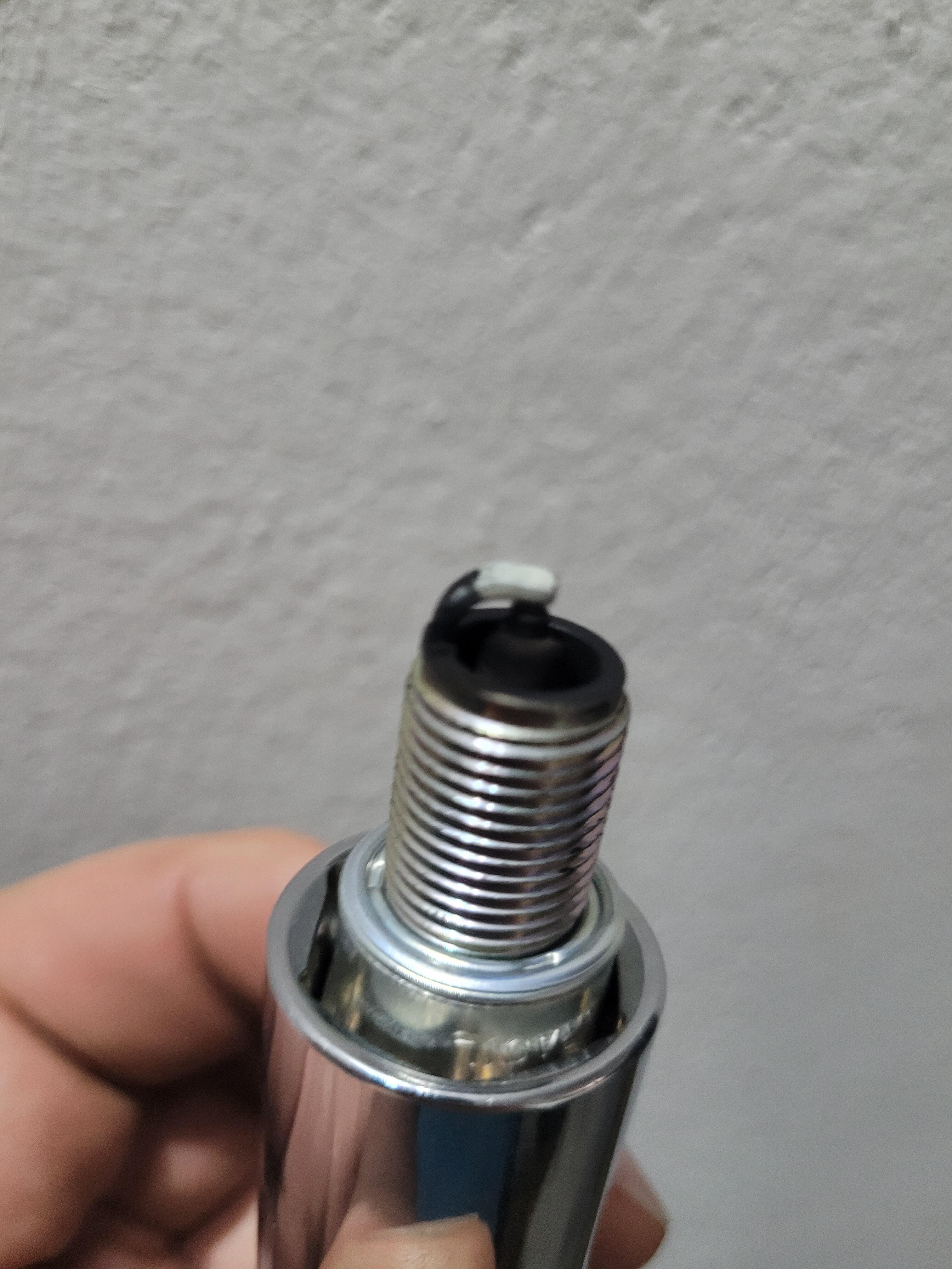

October 28, 20231 yr Author comment_658740 Lowered the mixture in both carbs to 2.5 turns clockwise each one. Rear carb was adjusted to 3.5 turns clockwise and front carb to 4 turns clockwise. I have set the idle speed to 1000 rpm. Ill try tomorrow and report. This is how the plugs came out before i dialed both carbs to 2.5 turns: Link to comment https://www.classiczcars.com/forums/topic/67984-still-struggling-with-car-at-idle-after-8-years/?&page=23#findComment-658740 Share on other sites More sharing options...
October 28, 20231 yr comment_658753 Obviously, the plugs are still dark. Two questions. Did the plugs clean up well and is this all new fouling? How well did it run at 2 1/2 turns down? Link to comment https://www.classiczcars.com/forums/topic/67984-still-struggling-with-car-at-idle-after-8-years/?&page=23#findComment-658753 Share on other sites More sharing options...
October 28, 20231 yr Author comment_658754 Ill buy a new set of plugs and report instead of cleaning these ones. Link to comment https://www.classiczcars.com/forums/topic/67984-still-struggling-with-car-at-idle-after-8-years/?&page=23#findComment-658754 Share on other sites More sharing options...

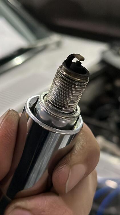

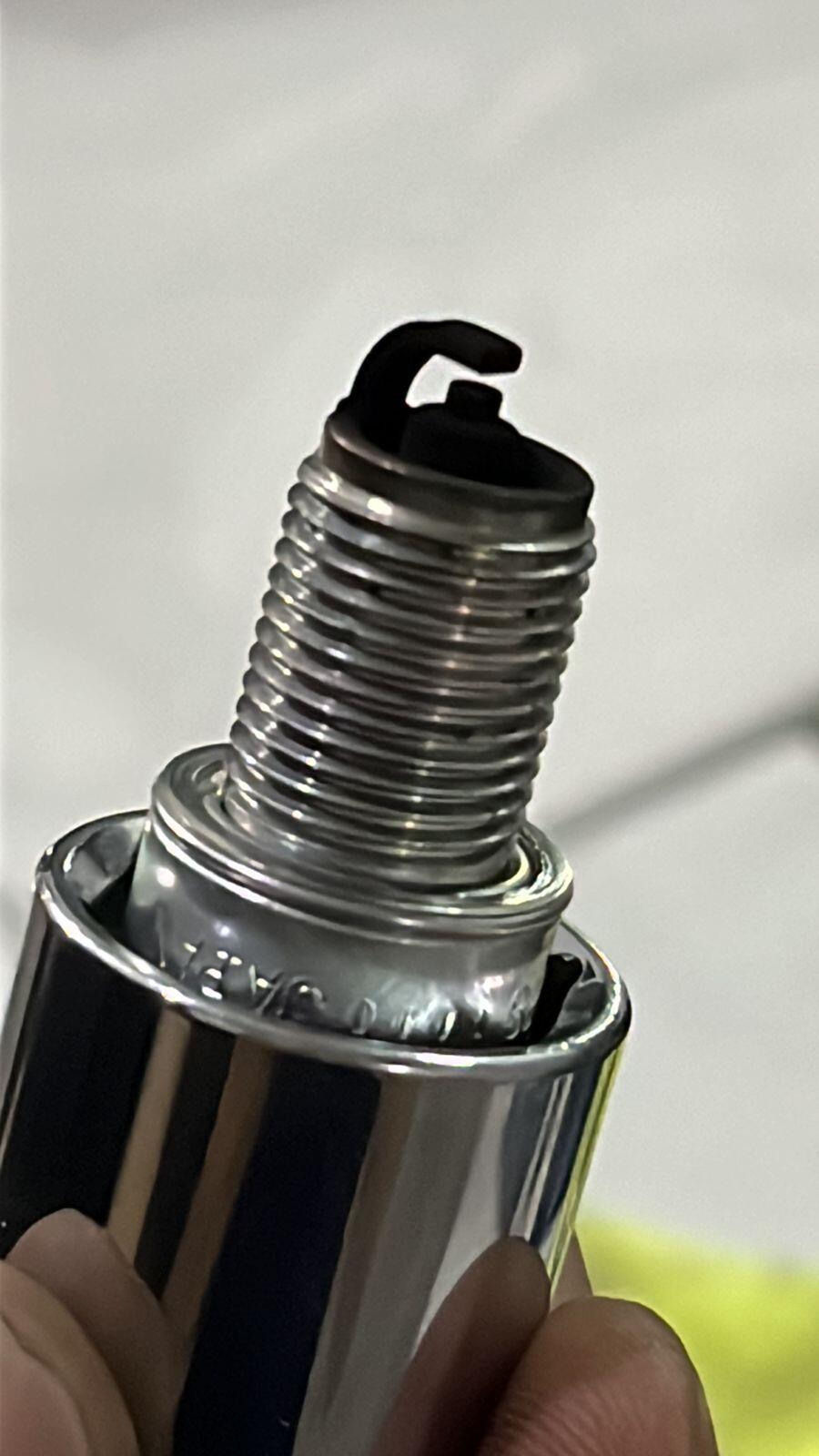

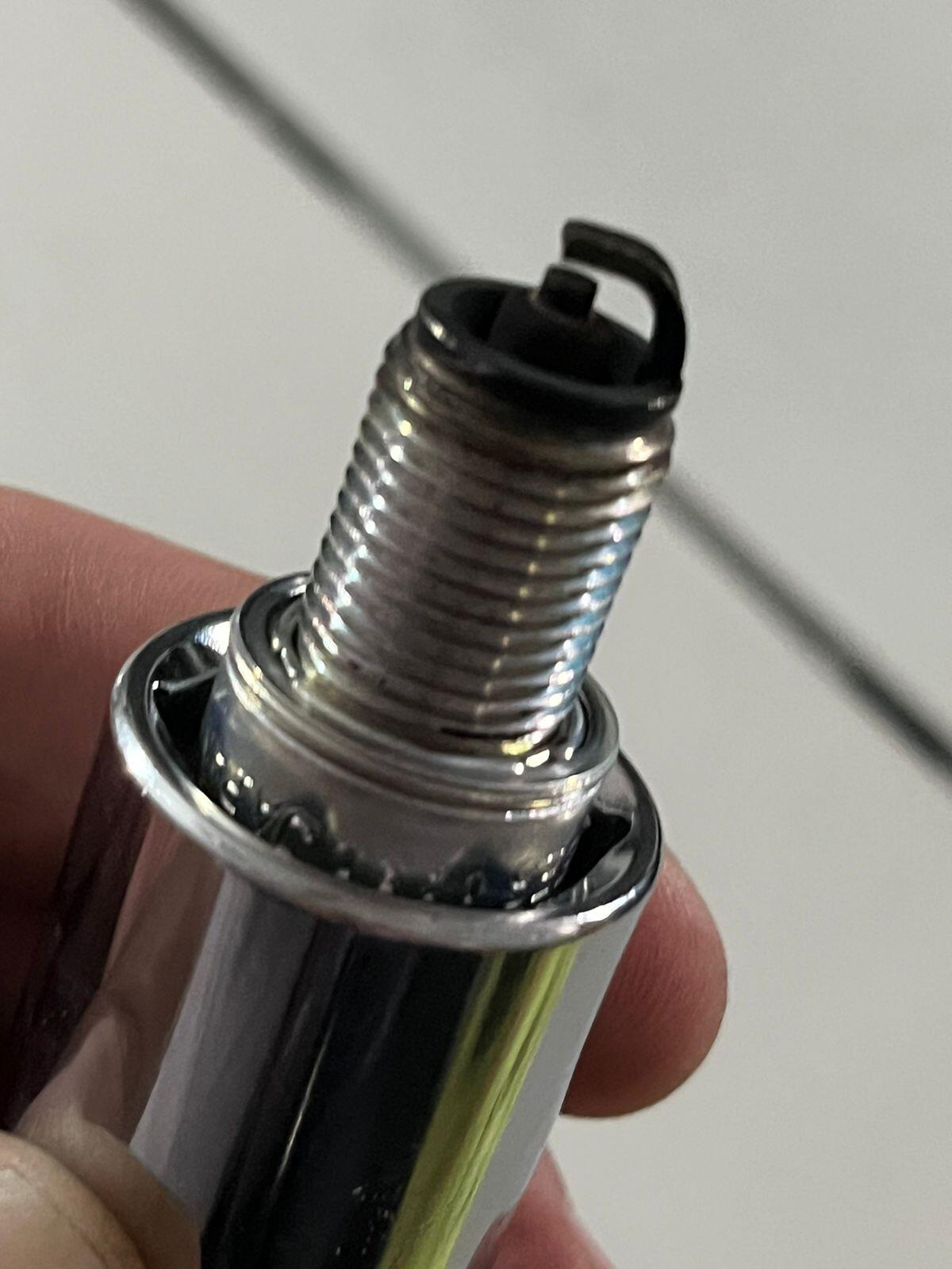

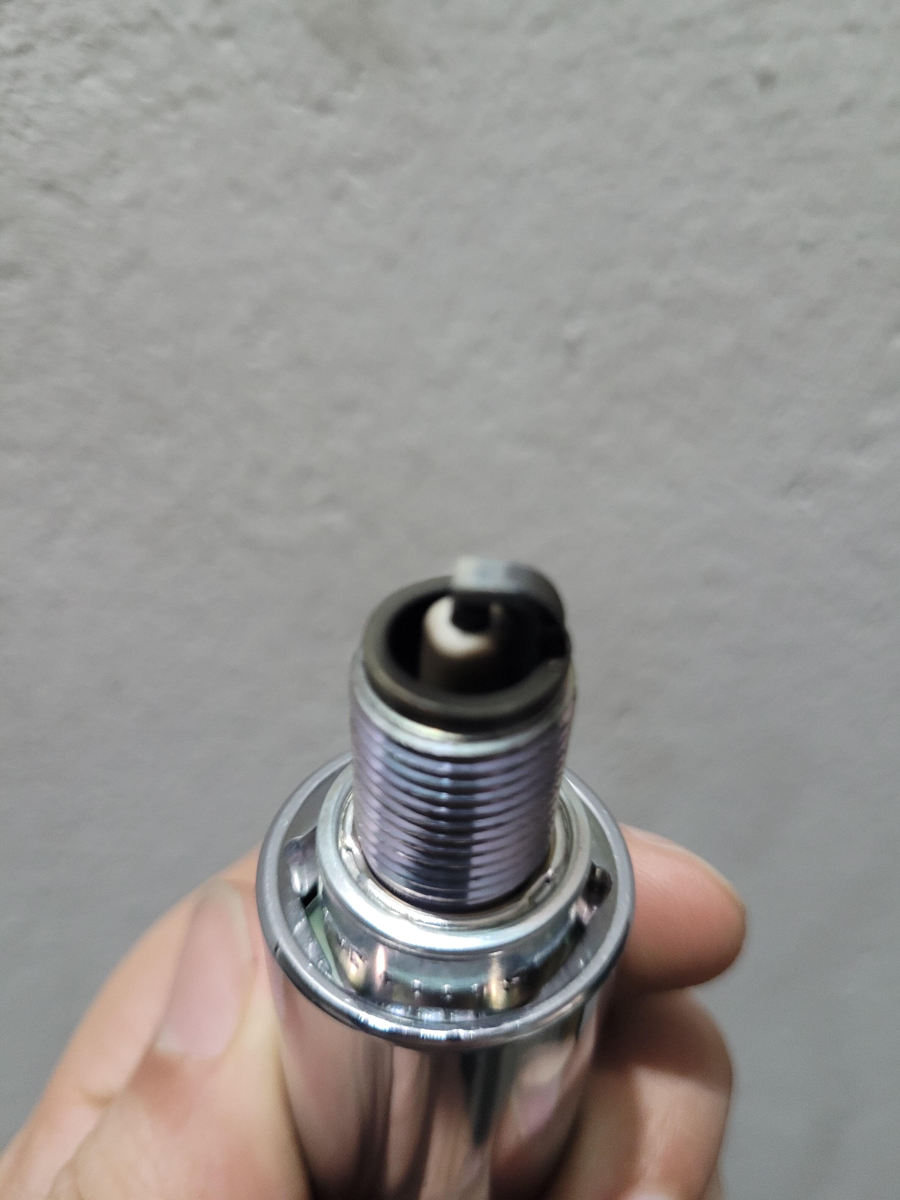

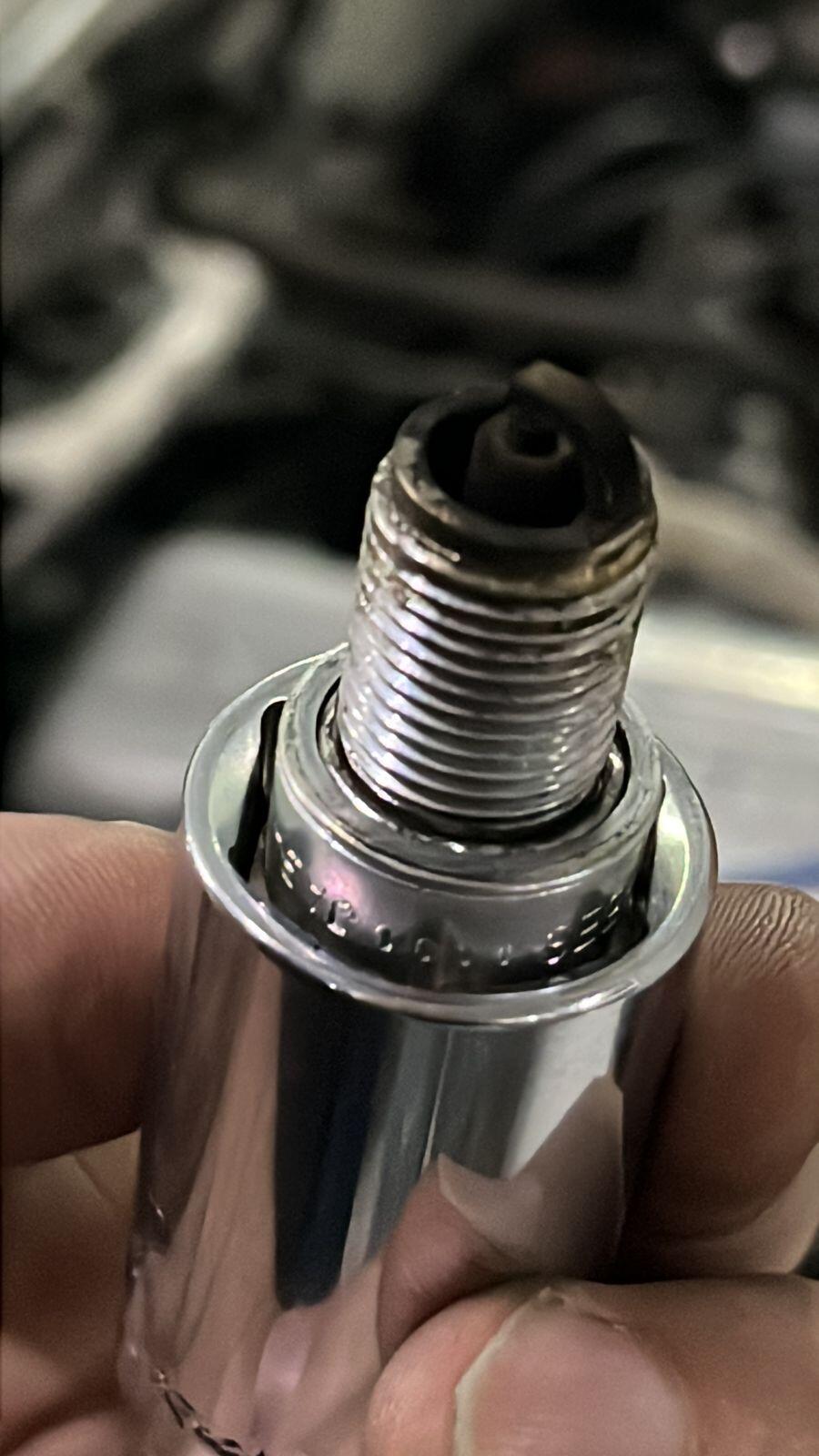

October 28, 20231 yr Author comment_658765 I tried brand new set of bpr5es at 3 turns clockwise each carb. 2.5 was too sluggish for driving and engine not kept idling steady. Just took a spin around the neighborhood as it started to rain. No good results. Plugs 5, 4 and 2. Link to comment https://www.classiczcars.com/forums/topic/67984-still-struggling-with-car-at-idle-after-8-years/?&page=23#findComment-658765 Share on other sites More sharing options...

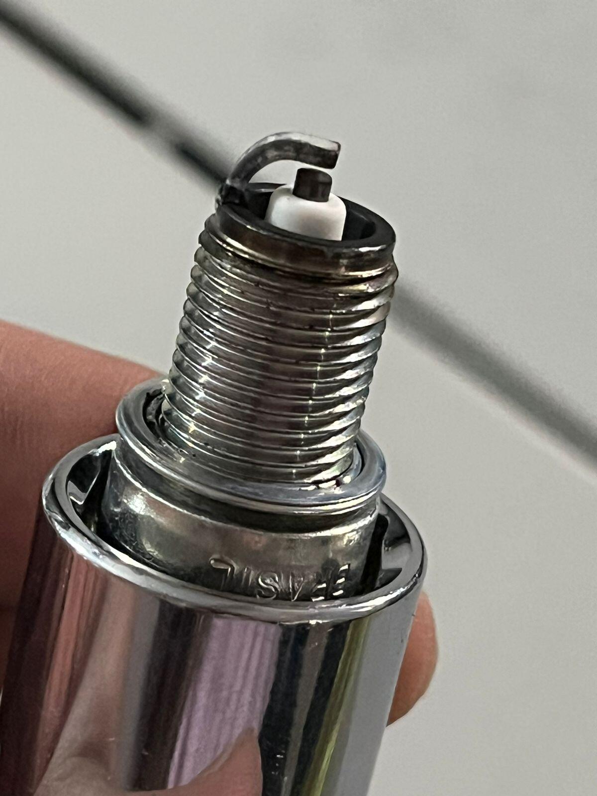

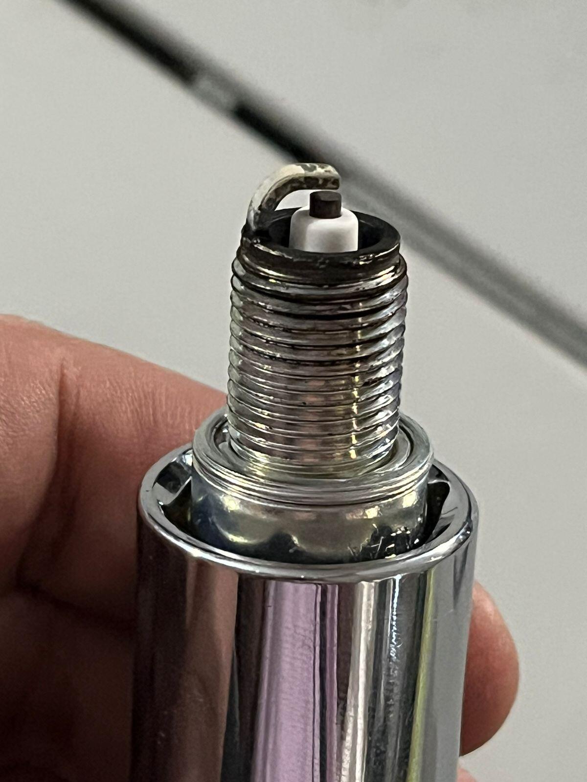

October 29, 20231 yr Author comment_658816 Car runs good at 3.5 turns clockwise on both carbs. Timing advanced to 14bdc. Plugs BPR5ES from 6 to 1 Link to comment https://www.classiczcars.com/forums/topic/67984-still-struggling-with-car-at-idle-after-8-years/?&page=23#findComment-658816 Share on other sites More sharing options...
