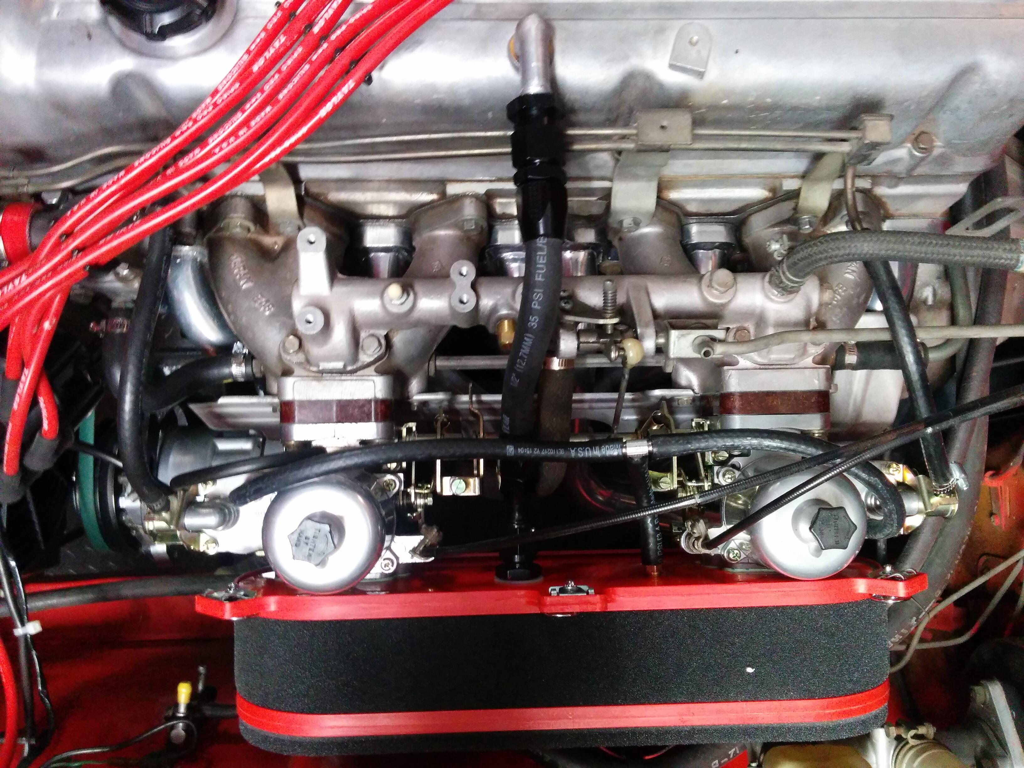

I did the ITG dual and have air horns inside. Float bowl vents and valve cover vent attached similarly to the original but I did have to drill the back plate for the vent fittings.
