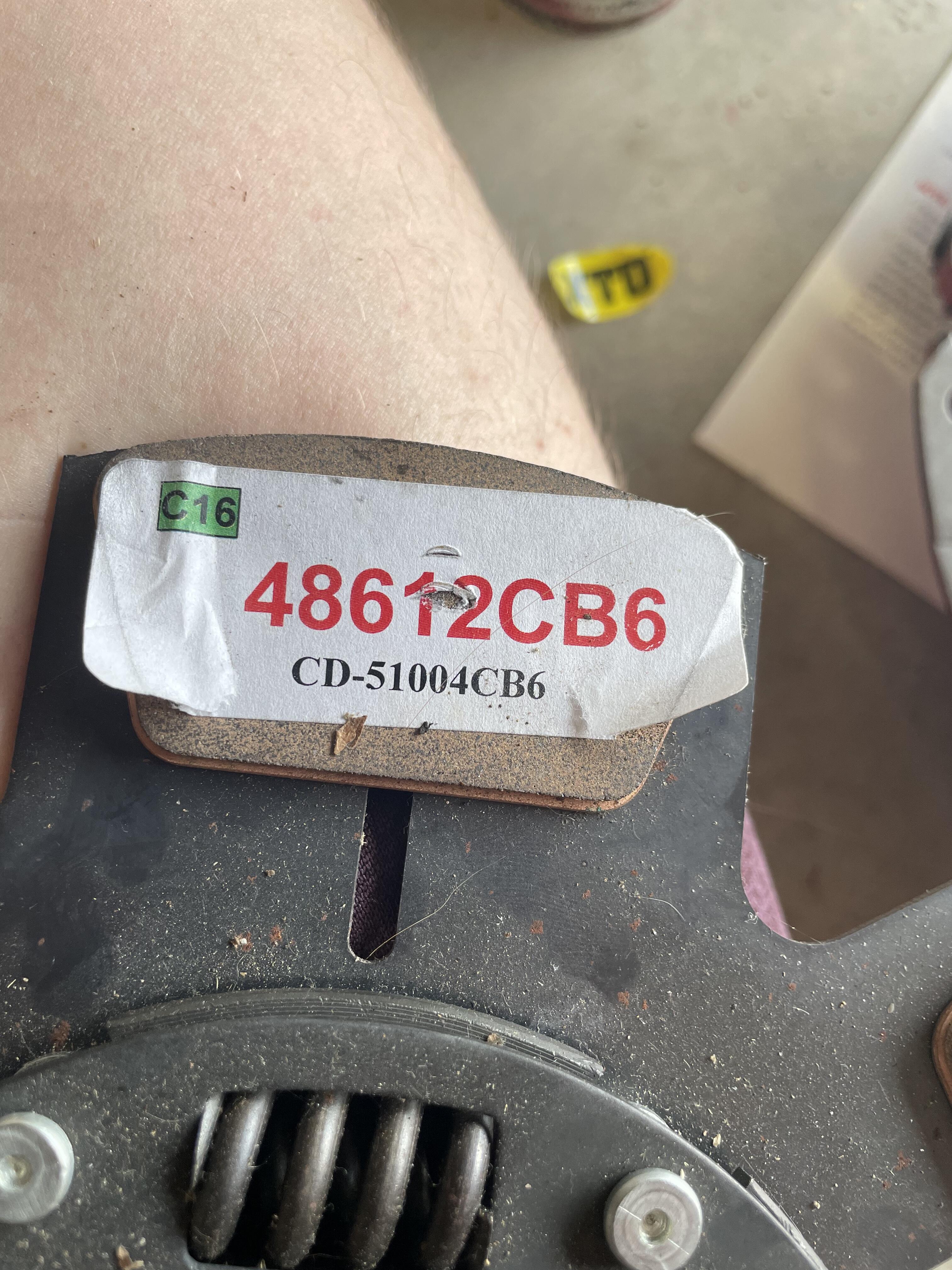

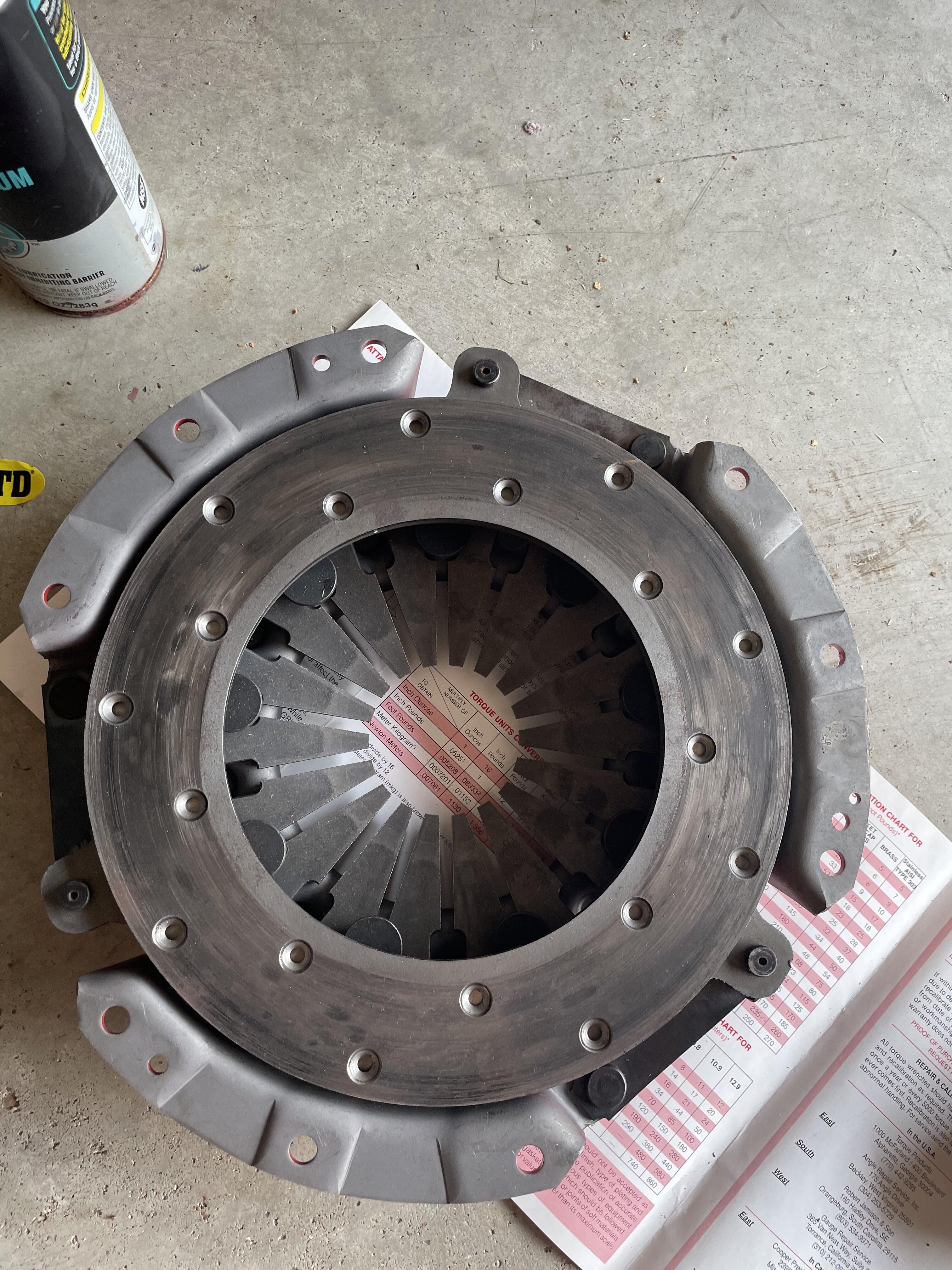

trying to install this XTD clutch. 6 of 9 bolts line up.  Is this normal for after market pressure plates or is this a part that needs all 9 bolts.
I’ve tried researching the part number and haven’t found anything relating to it or if it is for Datsun Zs.

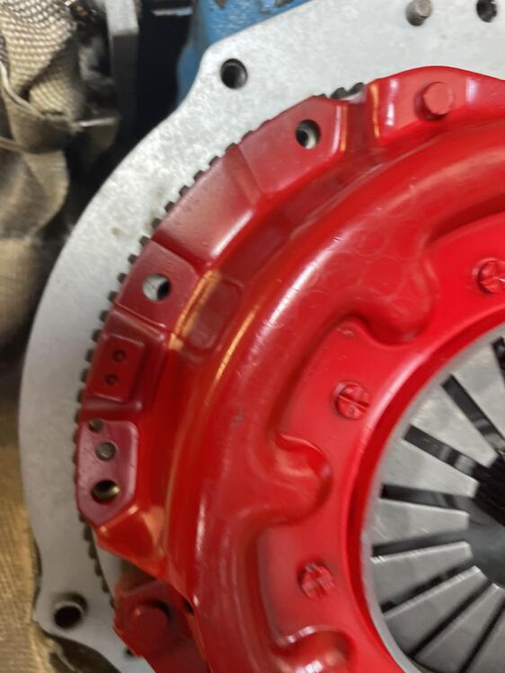

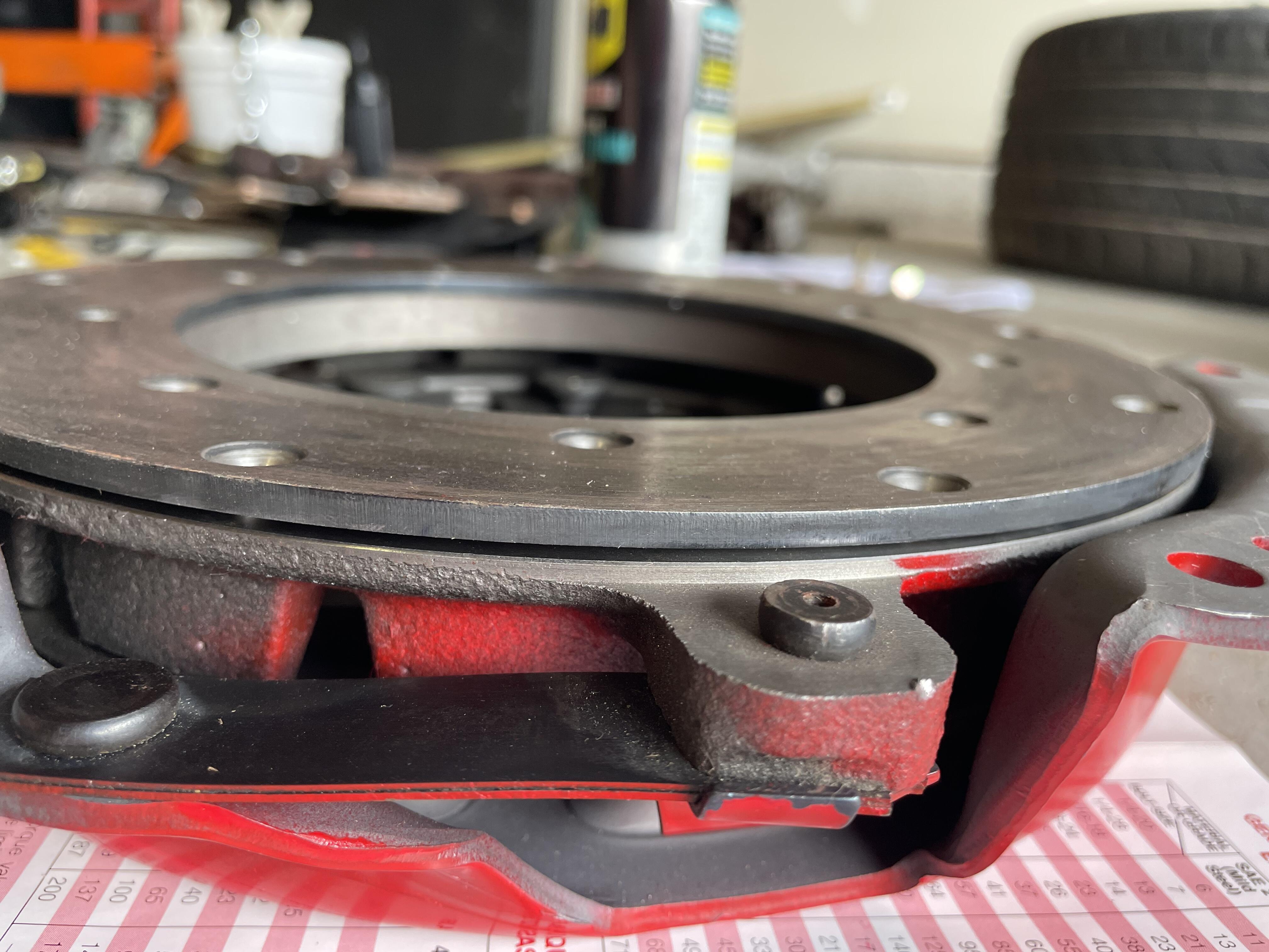

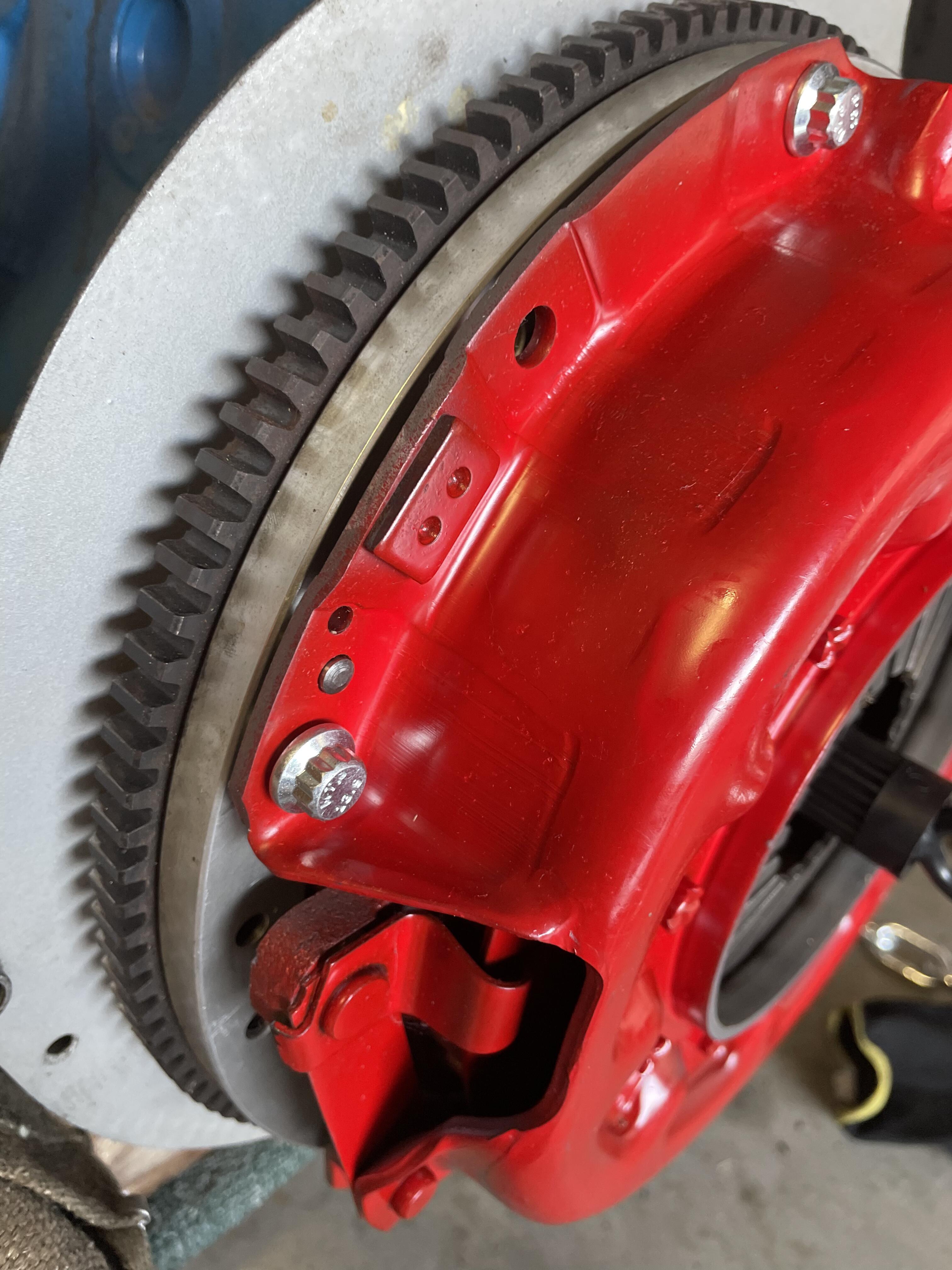

6 of the 9 line up.
Appears something’s not right here.

280ZX. I hate having parts order 10-15 years ago and finally doing the build. I believe my flywheel is 225mm and clutch is 240mm.
are there any issues with mating them togethe?
you'll need a new clutch release collar to match the clutch (assuming your old clutch is 225mm)
might be better off getting a 240mm flywheel too.
