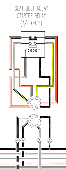

Trace the power for the coil on the relay at the top of the image you clipped. The white/black wire comes from the inhibit switch on the transmission, and if you trace the white/black on the other side of the inhibit switch, you'll find it goes back to the ignition relay.

I would check power to the seat belt relay on the yellow/black wire.  That's the power that comes from the ignition switch.  If you have power there then you can assume the ignition switch is good.
Separate in your thinking the starter solenoid wire and the ignition relay.  You've already saved yourself the effort of removing the starter.
Forgot the picture.  Haven't you bypassed this already? -
Edited by Zed Head
I have not bypassed the seat belt relay. How do u do that? jump the black/yellow wire?
