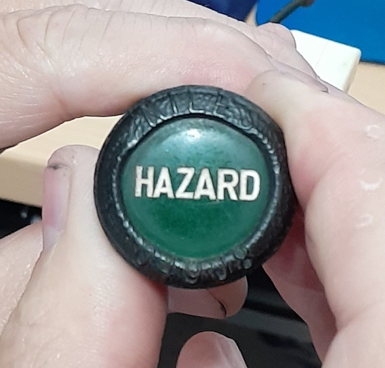

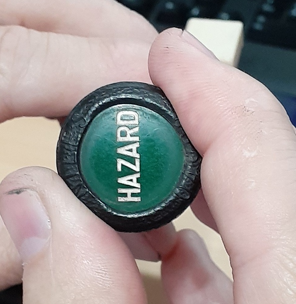

  1. Push and turn on the knob (counter clockwise) and pull the knob off. Be careful not to lose parts. (Been there, done that.)image.pngimage.png

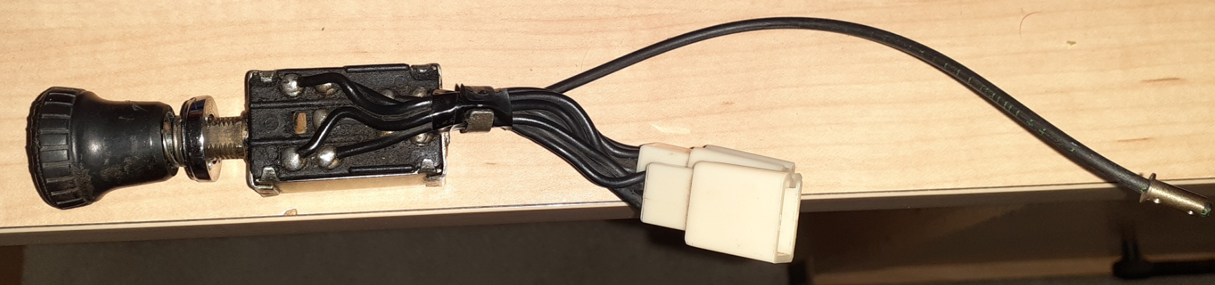

  2. After you pull the knob off, you will need to unscrew the retaining ring. You may be able to use snap ring pliers to get at the holes in the ring.image.png
  3. After you remove the retaining ring, you need reach behind the dash to disconnect the optical fiber.
  4. Then you have to look up new curse words to reach up further behind the dash and unplug the two connectors, probably with one hand (hence the need for the curse words).
  5. Pull the switch out from behind the dash.
Go ahead and reassemble the switch after you remove it, so you don't lose parts.

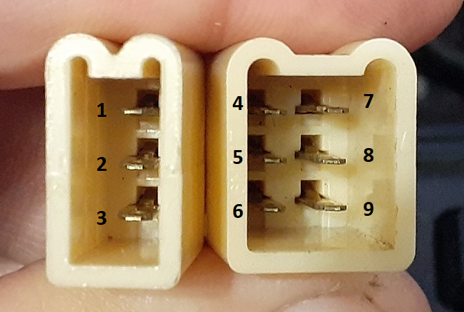

There are two connectors on the switch. One has 3 pins, and the other has 6 pins. I numbered them in this picture for easier reference.
With the knob pushed in (Hazards off), pins 1 and 9 should have continuity. Also pins 7 and 8 should have continuity.
If they don't, re-check that the shaft of the knob is fully pushed in. You may want to push and pull a few times to see if contacts are dirty. Z Car Source lists the 73 switches as available on a exchange basis for $85.

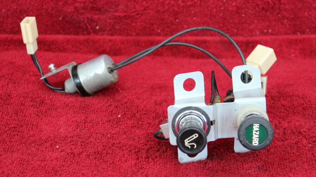

  6. Having secured your alliance with the Prince of Darkness, attempt to reconnect the optical fiber so the switch will light up at night. (See the reference photo below of the lighter and hazard switch with the light source.
