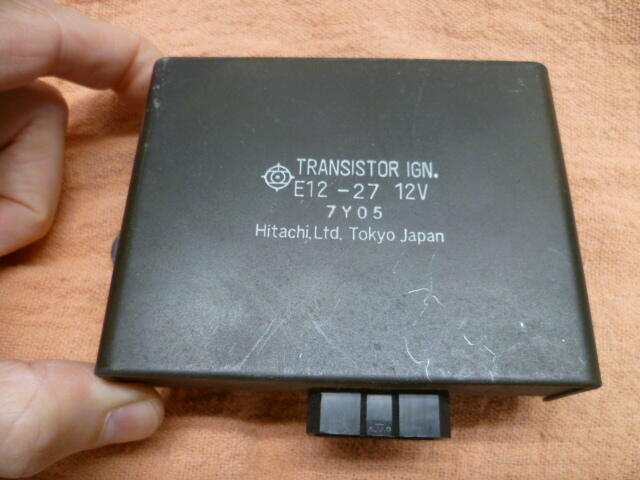

8 minutes ago, Zed Head said:
Does the module number match the 1978 module?
The 77 and 78 modules are significantly different mechanical form factor.
The 77 looks like this:
And the 78 looks like this. Slightly smaller and has a very different connection scheme:
I missed it, thanks.  77 is an odd year.  So, they kept the ballast resistor, which is a current-adjusting device, and opened the gap for the plugs.  So it's the intermediate step between 76 and 78.  76 had the same setup but a smaller gap.  Electronic module with ballast.
Who knows.  I thought there might be an advantage to a more modern module.  In the big scheme it just means he's still stuck with plug fouling, probably from the cam.  Oh well.
I think you have the chronology right. 74 through 76 used a smaller plug gap (presumably matched to the spark energy) and then in 77 they redesigned the module and increased the gap width (again, presumably matched to the spark energy).

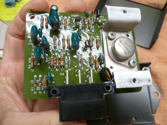

Then in 78, they changed things again, but the plug gap stayed the same. (.039 - .043). They did, however, do away with the ballast resistor, so there could potentially be a hotter spark if you used a 78 module. I have dug into both, but don't remember the details of what I found inside the 78. I have pics, but don't remember the circuit details without checking my notes.
78 guts:
Oh, and I do have to say that as much as I like talking about dissecting and analyzing electronic goodies, I don't think this (ignition module chatter) has anything to do with ckurtz2 issues.
