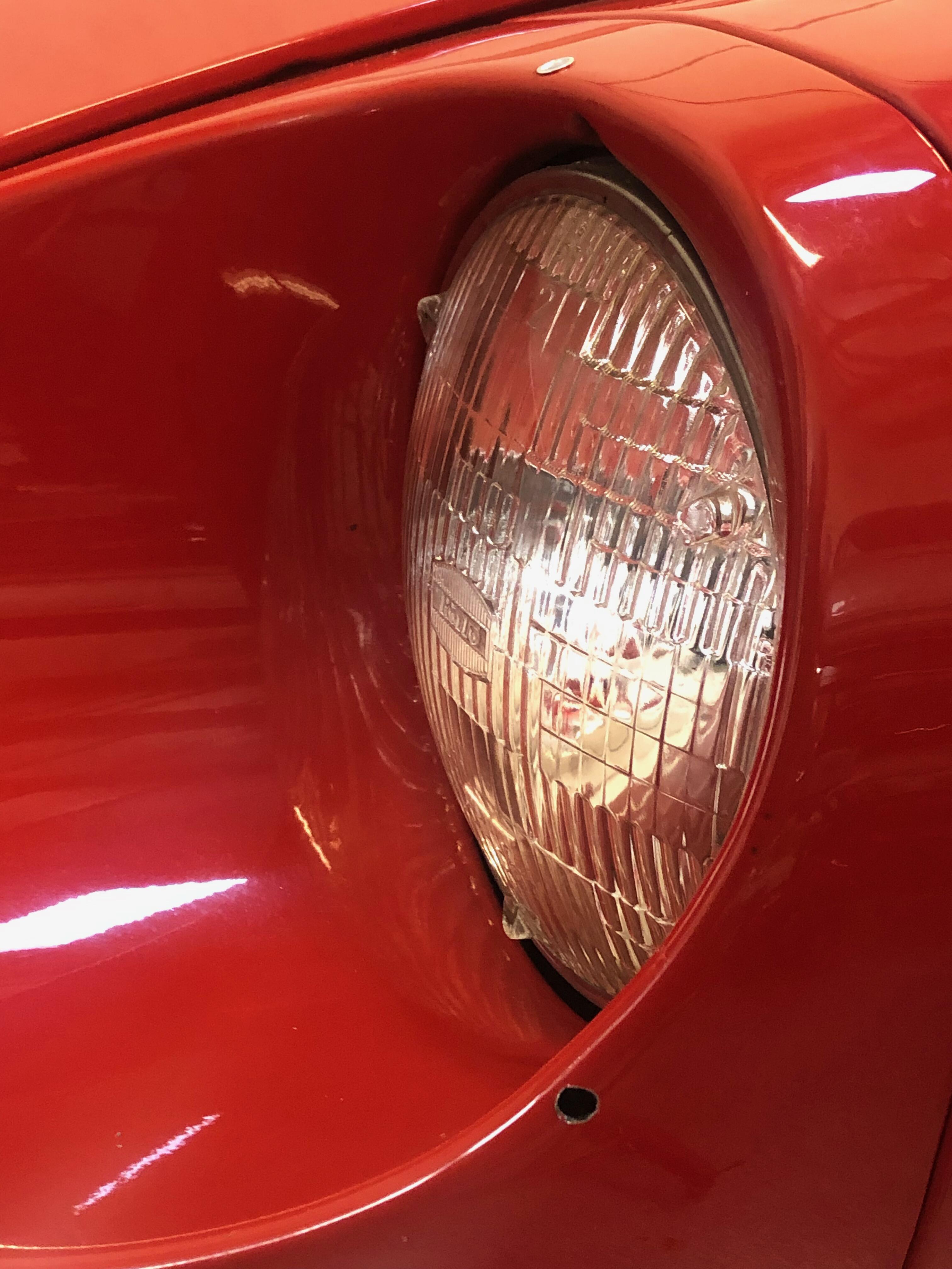

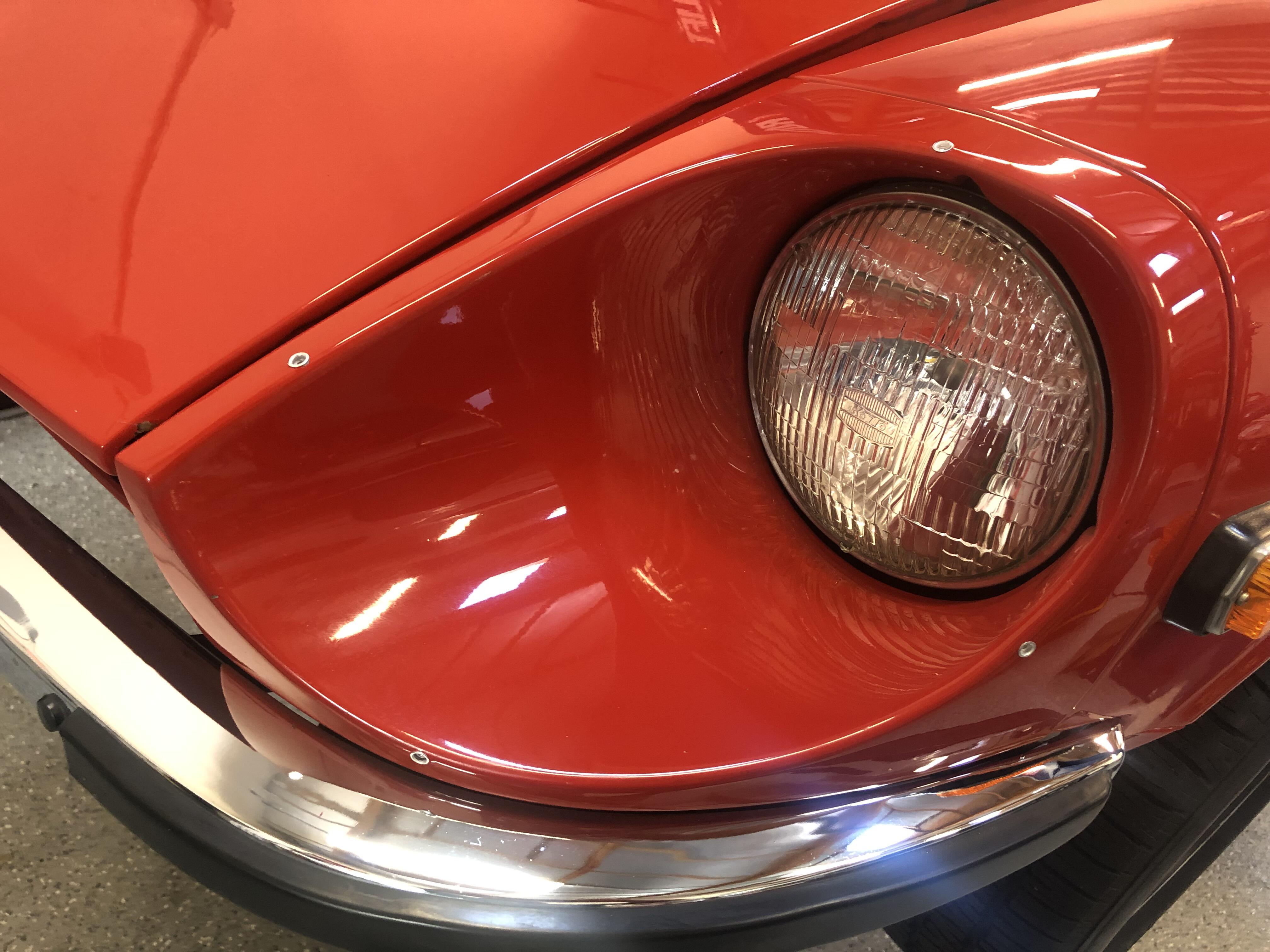

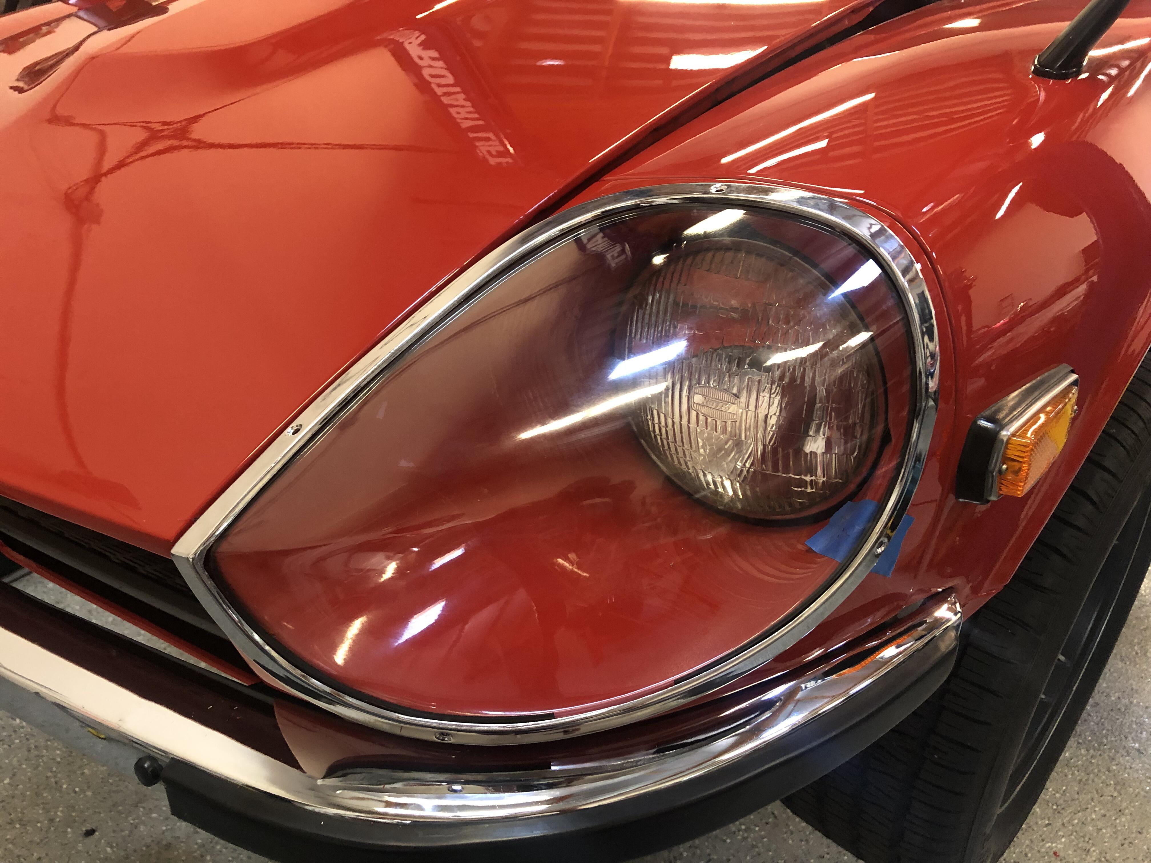

Here's what the finished rivet installation looks like.

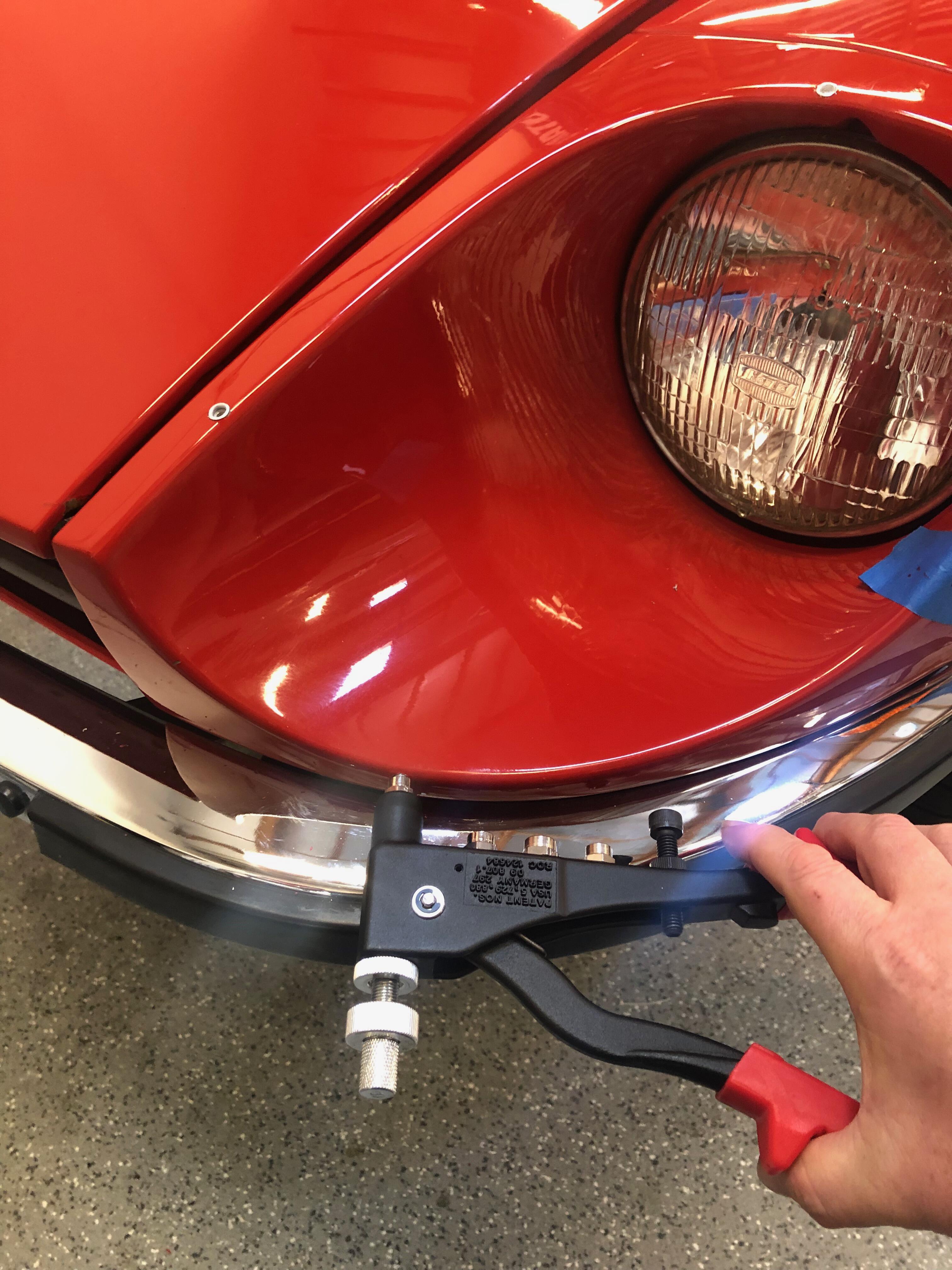

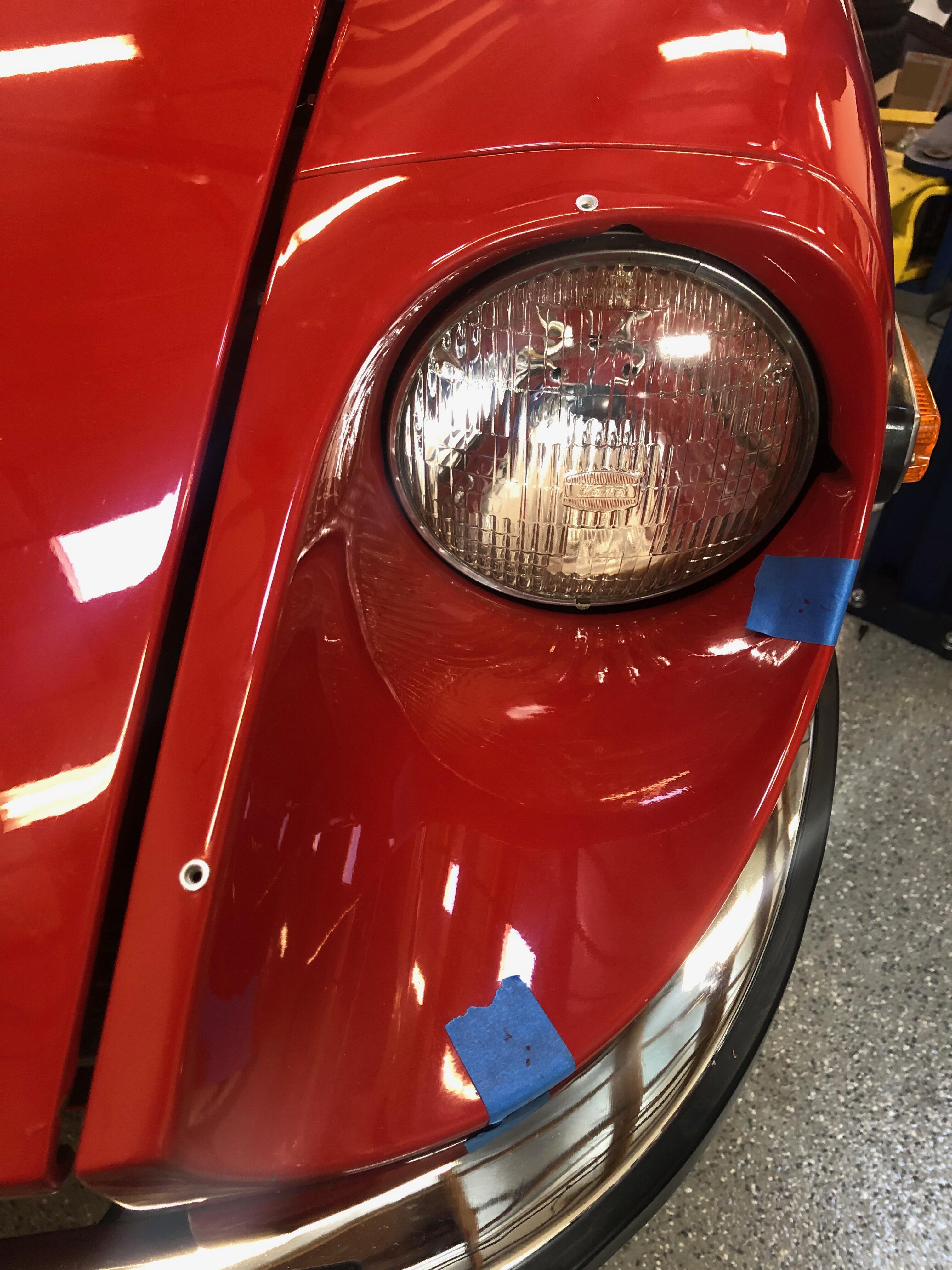

I started by laying down a 1" piece of masking tape at the approximate center of each mounting hole.  I then placed just the clear cover over bucket and massage it around until it appears that all four mounting holes have zero daylight - that is to say, when you look through the hole opening onto the metal, you see only masking tape. After I was satisfied that all 4 holes would be located as far away as I could get them from each edge.  I began to drill one hole - first with a 1/8 bit, followed by a 1/4 bit, which was the right size for the rivet nut I was using.  CRITICAL: use brand new metal bits that you just purchased at the hardware store!
Edited by xs10shl

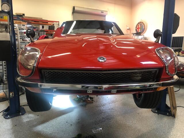

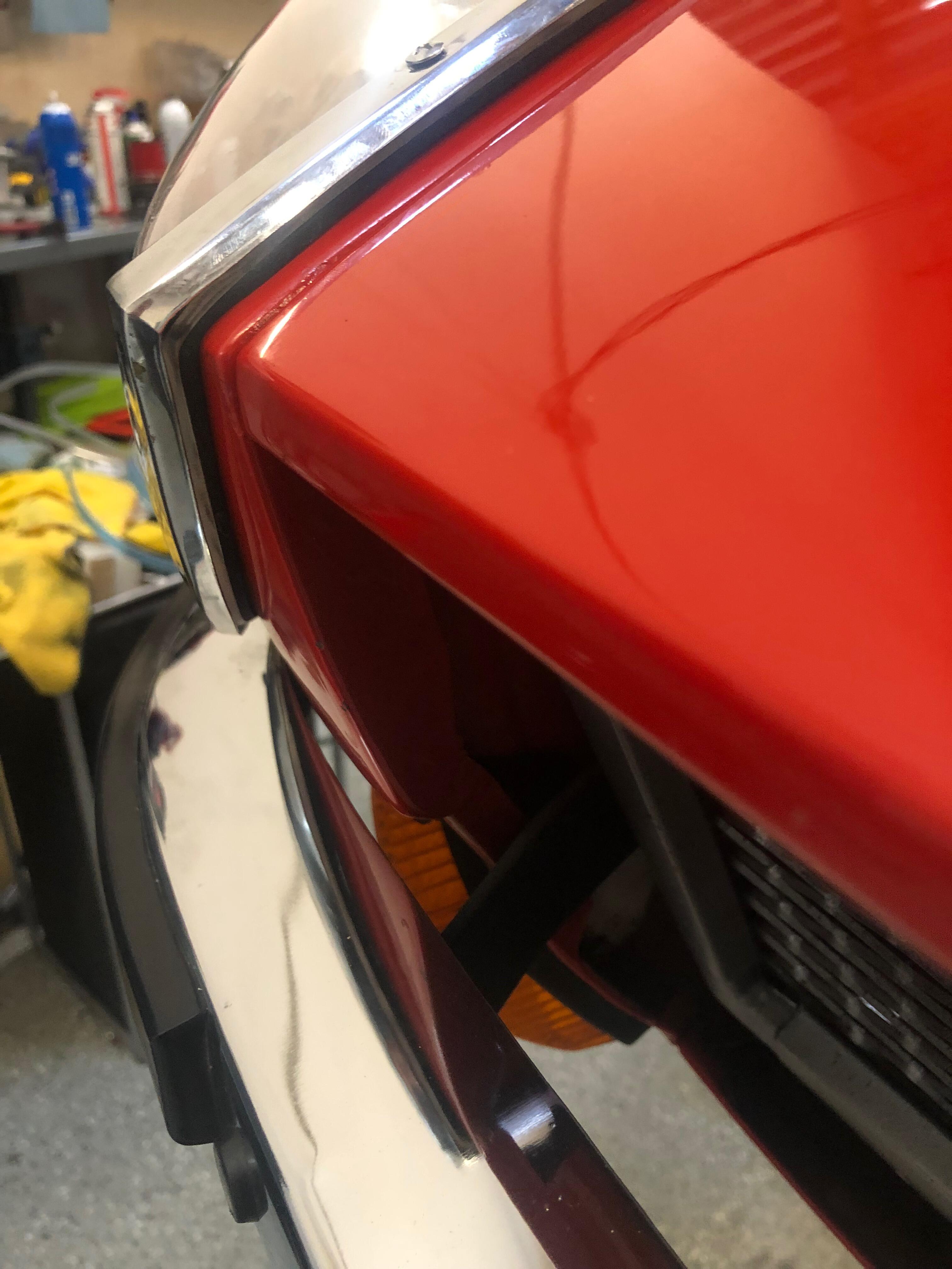

Contrary to what the above photos appear to show, I went around the bucket by drilling one hole at a time, inserting the rivet, and then re-installing the plexi cover, making sure that the remaining holes would still line up.  On the right side of the car, i started with the front-most hole, next to the bumper. On the left side, I started with the top-front hole, by the hood.  Of the two methods, I found it would be best to always start with the front-most hole by the bumper, as that seemed to do a better job in "sucking the cover"  up against the sharp ridge on the nose than the other method did.  As a result, the right-side installation is completely tight all around, and the left-side installation is off by perhaps 1/16", which is enough to reveal a tiny gap between the cover and the bucket at the front edge.

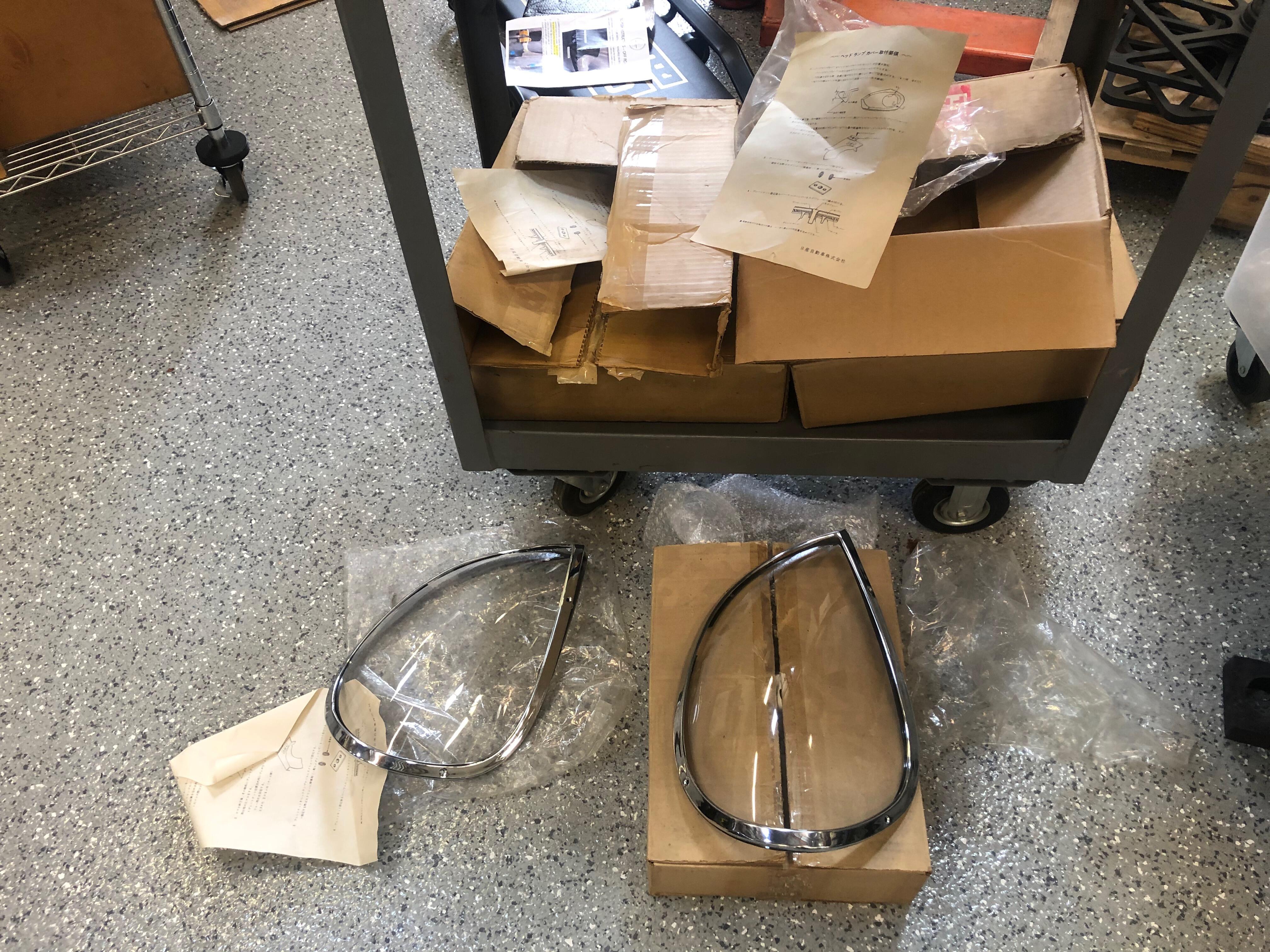

Another side trick which might not be all that helpful to everyone is to have more than one set of headlight covers to choose from prior to installing.  I'm fortunate to have a few sets which I've collected over the years, and although they appear to be largely identical, I found that I could get one of the left-side covers to fit more easily than the others, so that's the one i ended up using.  After speaking to my mechanic about this, he corroborated that he had the same experience.

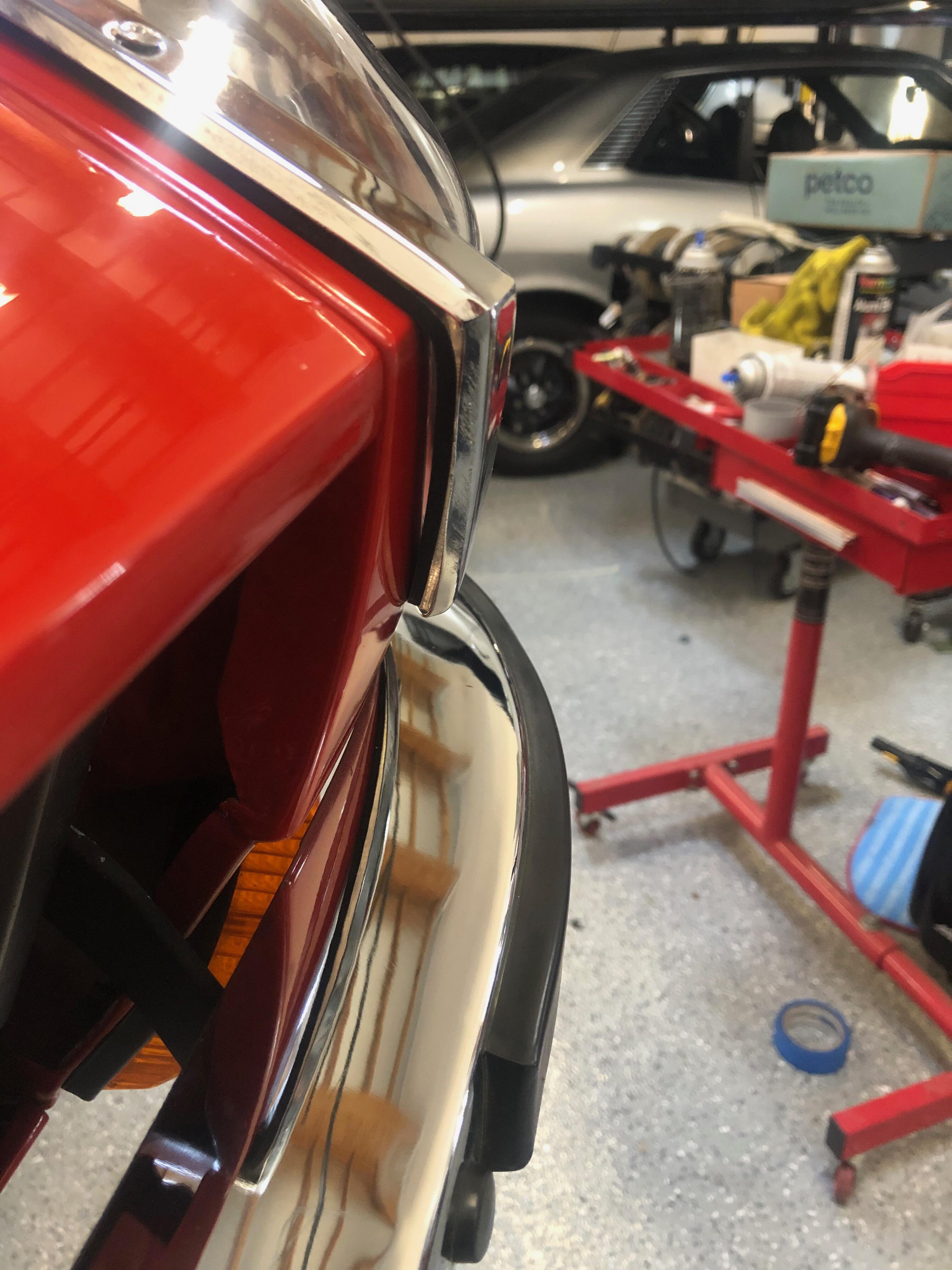

Final initial thoughts:  I've heard before that it's best to install these covers with the chrome surround in mind, which is the method that I attempted first.  In the end: other than to make sure the chrome piece basically fit and aligned with the cover, I did not find it all that useful to fit everything while trying to hold the metal surround in position, in addition to holding the cover.  Since the metal is flexible, I figured that I could more easily massage the chrome to fit around the cover, vs letting it dictate where the cover would be installed.   Perhaps I got lucky this time- others may have alternate tips and tricks to share.
