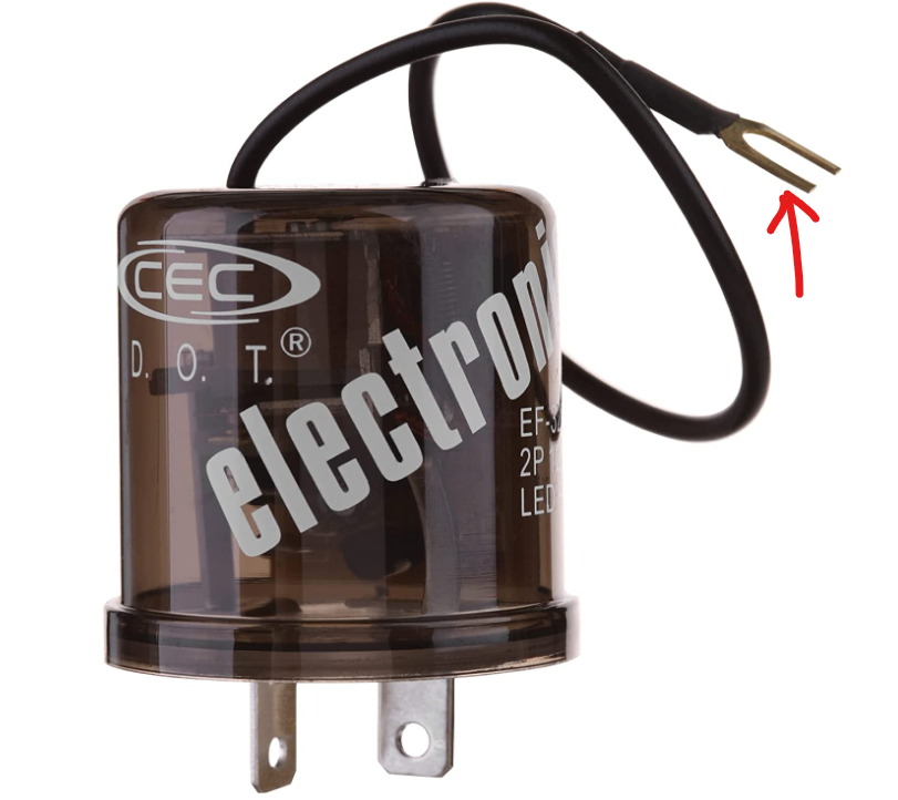

July 20, 20223 yr Author comment_642672 Thanks Steve, I’ll get in there and check on that common ground for these tach bulbs. I did try and put my multi-meter on the neg and pos sides of the bulb sockets and got nothing, I even tried put the neg lead on the chassis to get a solid ground. Did this with the flashers on. I got zero voltage. I’ll keep poking around. Hoping it’s a simple fix. That Amazon link you sent is for a three prong flasher, is that what you intended? Thanks again Link to comment https://www.classiczcars.com/forums/topic/66453-77-280z-restoration/?&page=12#findComment-642672 Share on other sites More sharing options...
July 20, 20223 yr comment_642673 14 minutes ago, Av8ferg said: Thanks Steve, I’ll get in there and check on that common ground for these tach bulbs. I did try and put my multi-meter on the neg and pos sides of the bulb sockets and got nothing, I even tried put the neg lead on the chassis to get a solid ground. Did this with the flashers on. I got zero voltage. I’ll keep poking around. Hoping it’s a simple fix. That Amazon link you sent is for a three prong flasher, is that what you intended? Thanks again Yes, terminals B & L go into the stock plug, and you run a ground to the E terminal. It's not that much different in that respect to the EF-32RL. It's just that the EF-32RL has the ground wire coming out of the top. The downside of having it pre-wired like that is that you need to have the grounding point nearby. If you're running your own ground wire to the adjustable flasher, you can route it to whatever ground point suits your fancy. Make sure the connector for the tach wiring harness is clean on both the gauge and dash harness sides. The turn signal bulbs are wired to that connector. You might even want to take out the tach and test for voltage at that connector. Back from there it would be the C5 (white) connector. Link to comment https://www.classiczcars.com/forums/topic/66453-77-280z-restoration/?&page=12#findComment-642673 Share on other sites More sharing options...

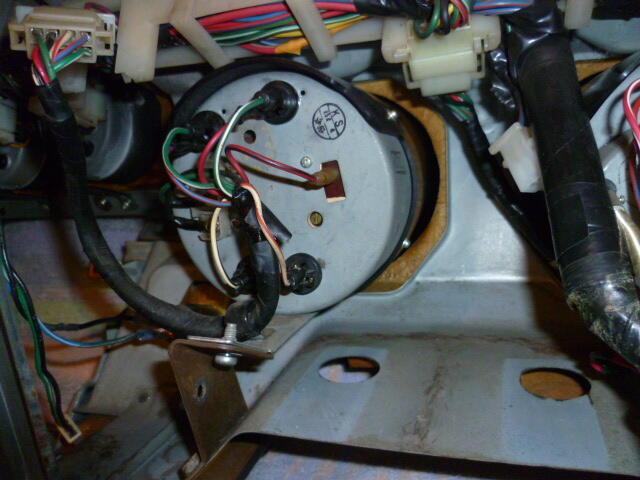

July 20, 20223 yr comment_642685 So I got a chance to look at the wiring diagram, and here are my thoughts. First, the indicator lamps in the tach are simply in parallel with the corner lamps. The implication of that is... If all four corners blink with the turn signals, your non-functioning indicators in the tach have nothing to do with either of the flasher modules. It also has nothing to do with the hazard switch. Steve's thought about the ground for those two bulbs being broken is a good one, but I'm thinking if there was a problem with that ground, the tach wouldn't work either. Depends on where it's broken (if it's broken at all). So I have a C.O. question... What is the possibility you swapped the turn signal indicators with the tach illumination bulbs? Maybe you have the bulb sockets swapped? I remember you said that you don't care about the illumination circuit because you don't drive at night... I'm thinking maybe when you put a turn signal on, one of your illumination lamps is blinking and you just can't see it in a bright garage? Just tossing out theories. And for the hazard issue where only the left side blinks... I'm thinking that since all four corners work fine with the turn signals, then that problem must be inside the hazard switch. I took a refresher look and they do have separate circuits coming out of that switch for left and right sides. So it's completely conceivable that one dirty or deformed pair of contacts could knock out one side of the car's hazard lights. Link to comment https://www.classiczcars.com/forums/topic/66453-77-280z-restoration/?&page=12#findComment-642685 Share on other sites More sharing options...
July 20, 20223 yr comment_642686 I found a pic of the back of the tach installed. It looks to me like they are grounding the turn signal indicators through the tach body and not through the harness? I don't have a tach here loose to verify, but it looks like that to me. That opens up the possibility for some other ideas. You can also see that they changed a bunch the wire colors on the little stub harness on the back of the tach. So you have to be careful about referencing wire colors since some of them changed at the tach connector: Link to comment https://www.classiczcars.com/forums/topic/66453-77-280z-restoration/?&page=12#findComment-642686 Share on other sites More sharing options...
