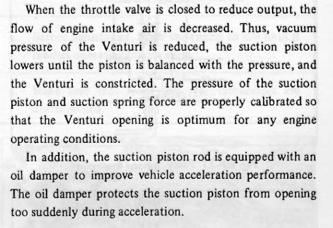

This sounds more like a carburetor problem.  Flooring the accelerator removes vacuum advance from the equation.  A tight spring in the vacuum advance canister would reduce timing advance.  Low RPM would also reduce timing advance.
I don't know much about the SU carburetors but it sounds like a jetting or needle placement or piston problem.  Maybe one of the carb guys has some ideas.
Edit - the behavior is what engines do when the fuel-air mixture is lean.
