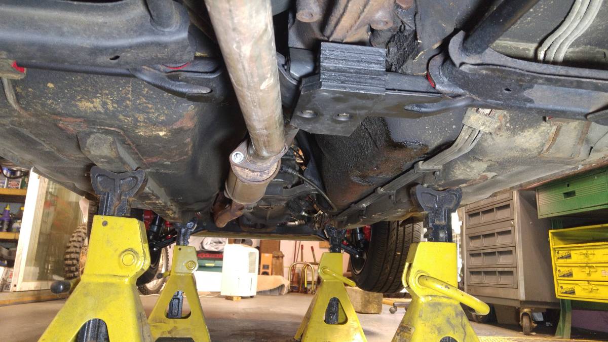

Hi, welcome to the forum. First thing... DO NOT lift that car the way on the picture!  Lift it under the original jack points if the car is not rusted inside there or the safe way is under the axles !!!   One day you will have a problem with the floor all dented in because its very thin steel and not strong enough to support a complete body with everything (engine and trans is ) IN it!
When you have a completely stripped chassis it could be possible to lift it that way but not a complete car..
Buy yourself a service manual or get one on www.xenonzcar.com
(And yes the front is partly lifted the way you did in the servicemanual but i've seen to many dents there to say it's safe to do so..)
I always lift it on the axles.  (I can also lift mine on the orig. jack points because i welded my car's sides and bottom almost from scratch haha.) but when i'm in for a MOT (Here called a APK) i always let them lift it on the axles.

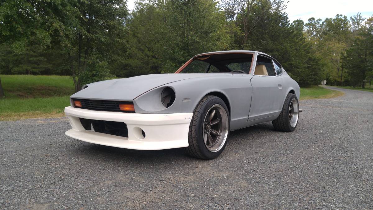

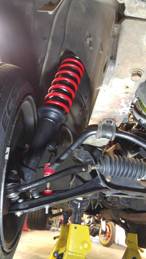

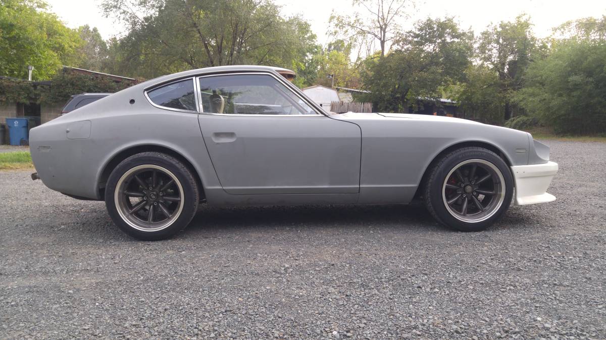

the front wheel gap (front to back) seems very offset? Pushed forward. When I turn the wheel, I rub on the front bumper. Perhaps its just to due to the lowering kit and the currently installed front bumper? 00a0a_fpzqIfvdhT5z_0CI0lM_1200x900.jpg

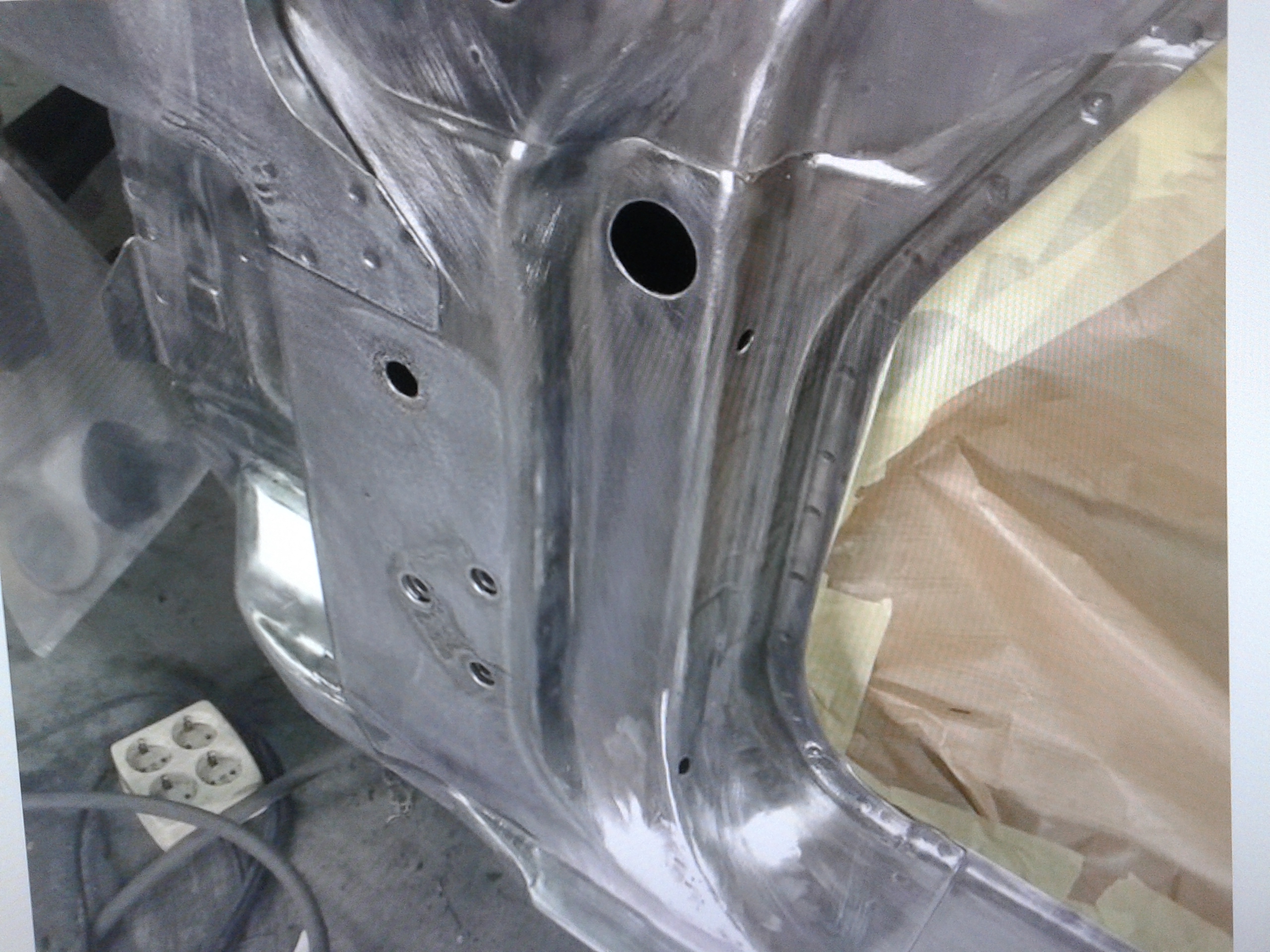

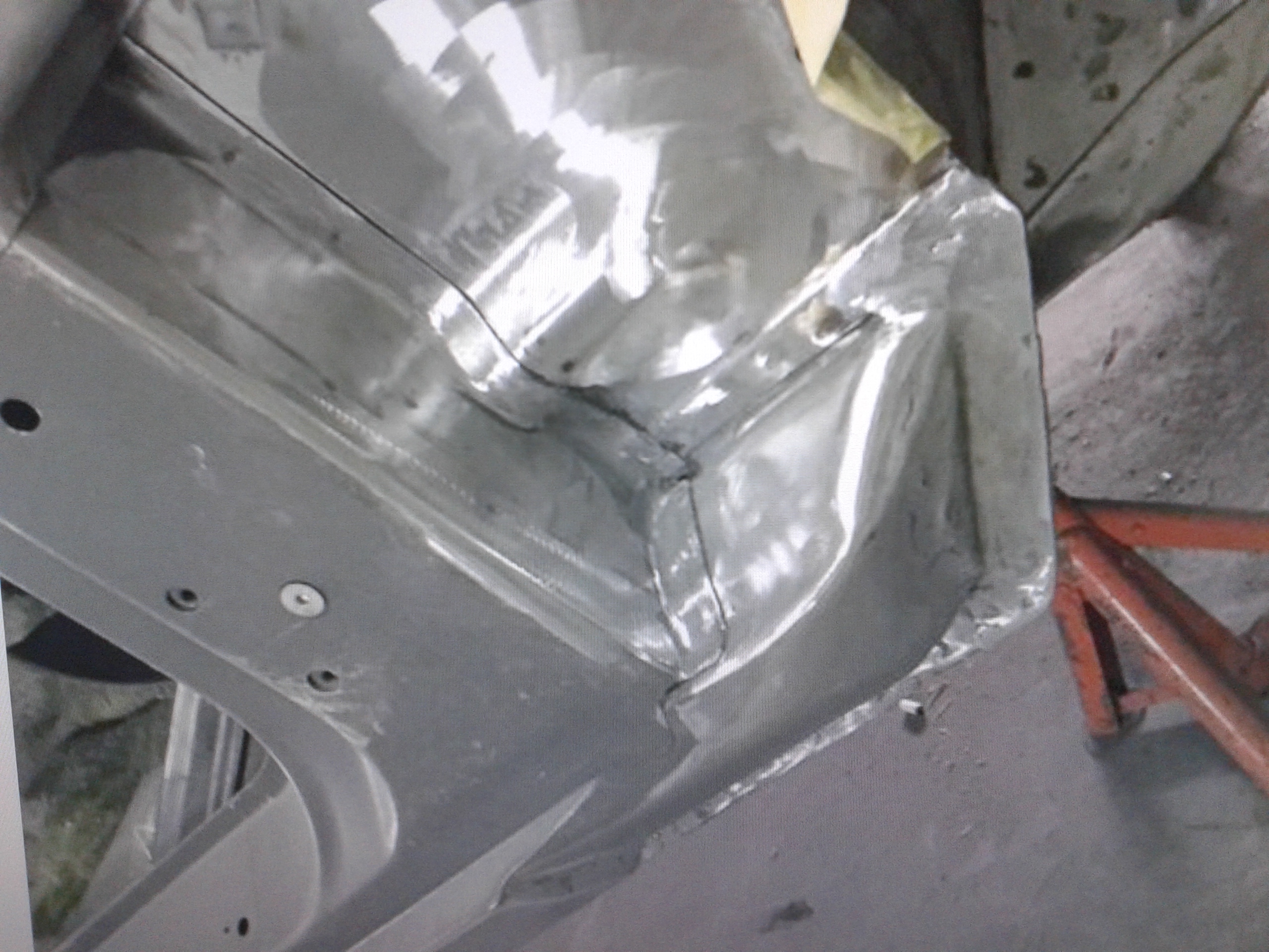

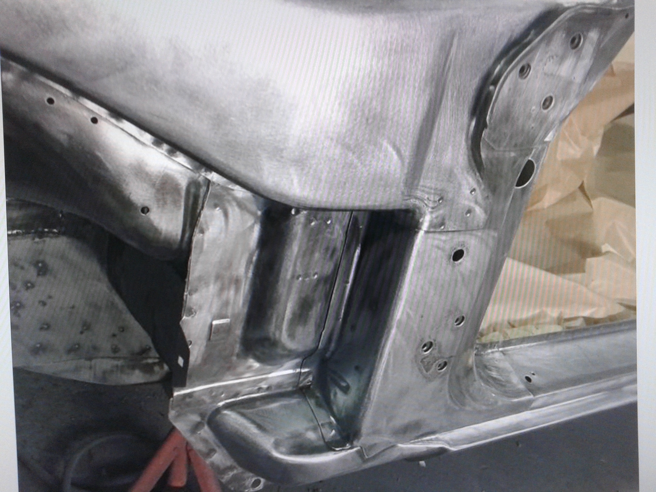

This is a good test.. take the paint of at this place (windshiels area.) and when you discover clean steel you know that the rest will be probably okay to! If there is a lot of Feo... Fe2o3...  (chemist joke..) say: RUST !! ... then you know you have to take it all down because your car will be a mess in a few years after your costly paintjob!
8 hours ago, dar5052 said:
seems like it was done correctly
Yep.. again.. you don't know that for sure... unless you have X-ray eyes! 🧐  Just pick a few spots where you think it's gone wrong.. you will discover the quality of the work already done..
Makes no sense to paint a car that will rust again just because the groundwork is sh**..  I painted a car and took it from clean steel.. costed me some 7000+ euro's but i have had many thumbs up!
Here on the forum i did a " Datsun 280zx slickroof 1979 2+2 restauration"  (look it up!) and started from this..  (i bought this car because it had almost no rust.. for a dutch car almost impossible due to the climate!)
Unbelievable clean..
Btw.. that front bumper/apron is much to big, i would never use that it's  much to heavy looking..  get yourself a smaller/thinner/lighter one or original parts..
Looks like you have bigger wider wheels also.
The wheels on the Z's sit forward in the wheelwells.  It bothers some people and they try to center them, but that takes a lot of work.

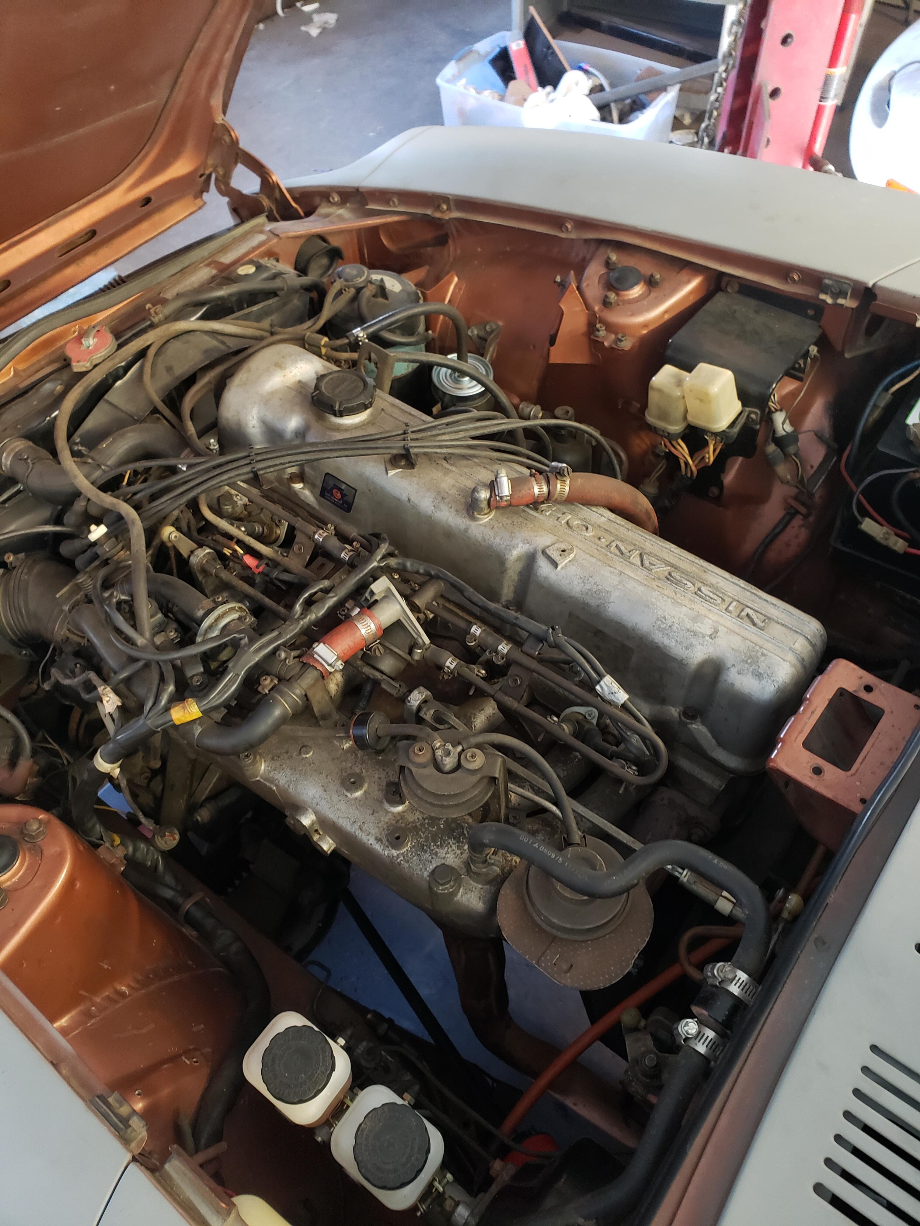

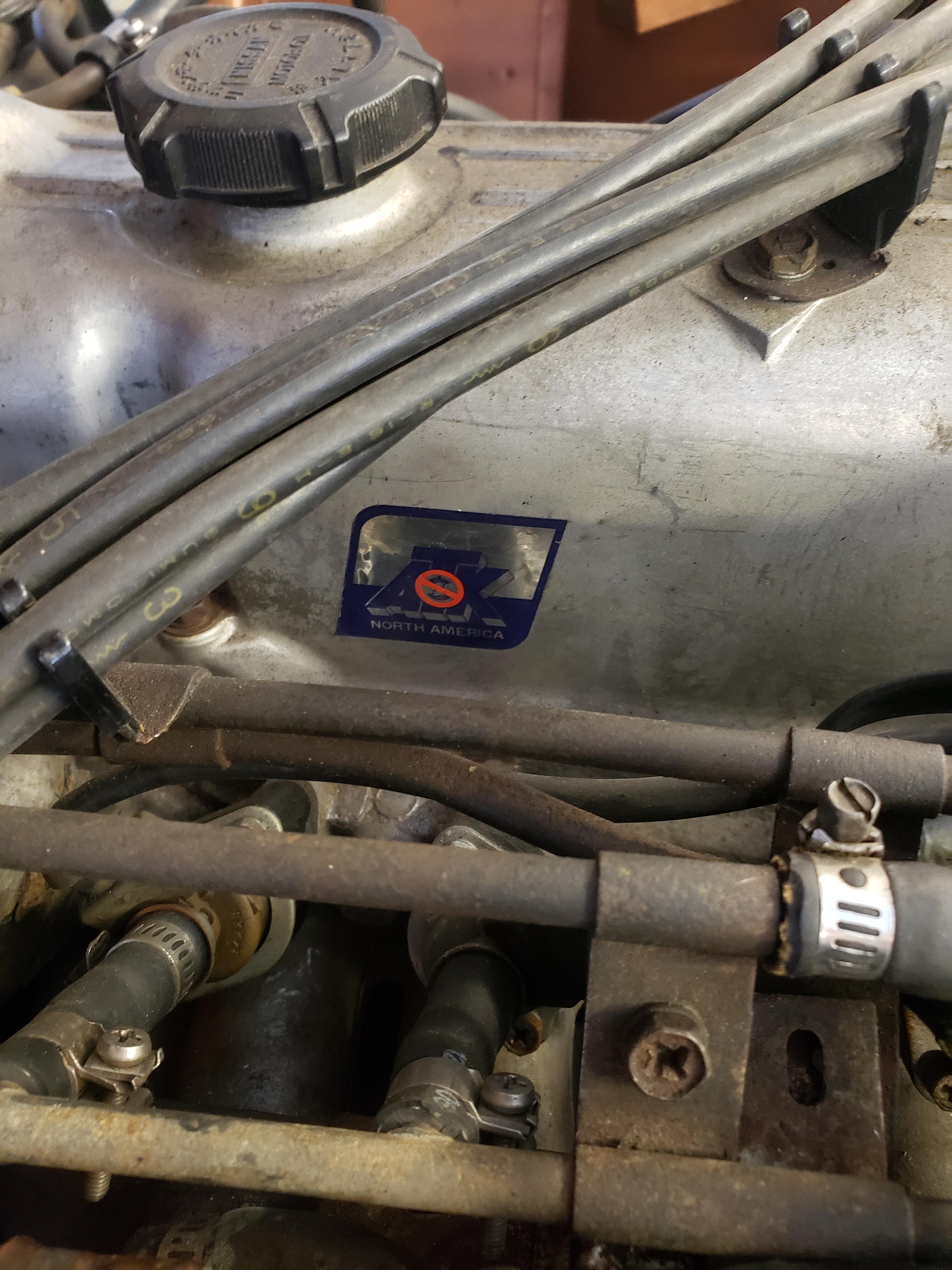

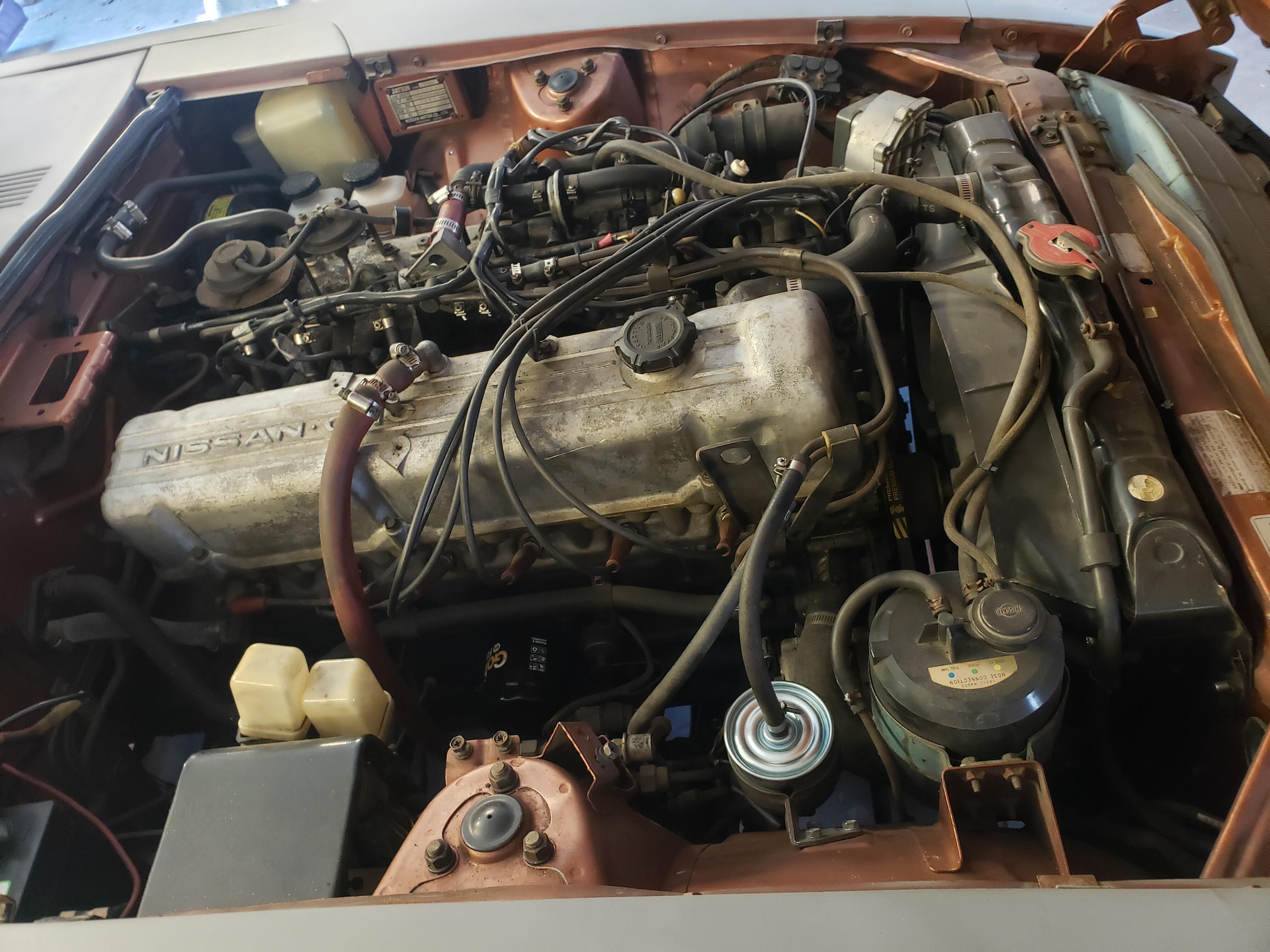

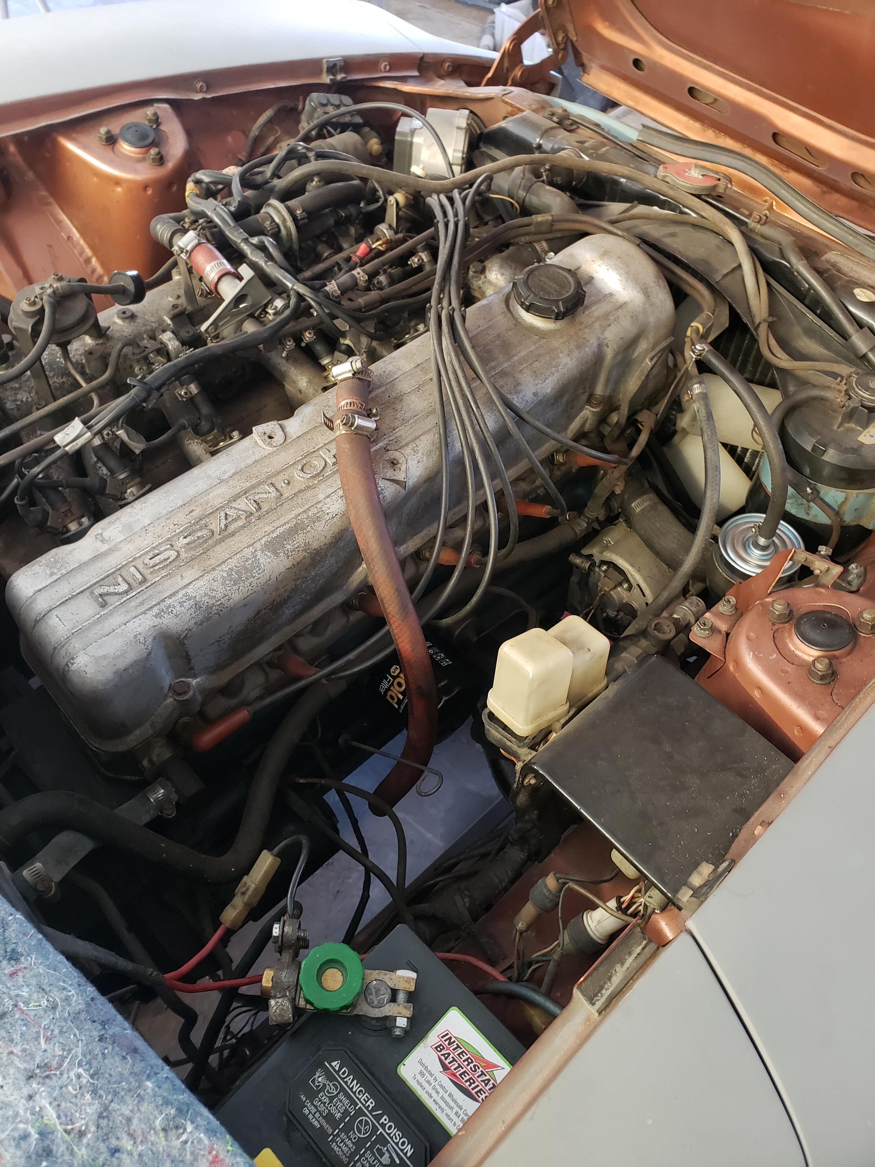

Finally made it back to the shop today to clean up and catalog all the parts I got with the car. Then looked around the car a little more and it looks like the engine is a reman from ATK. Still has the tags on it.

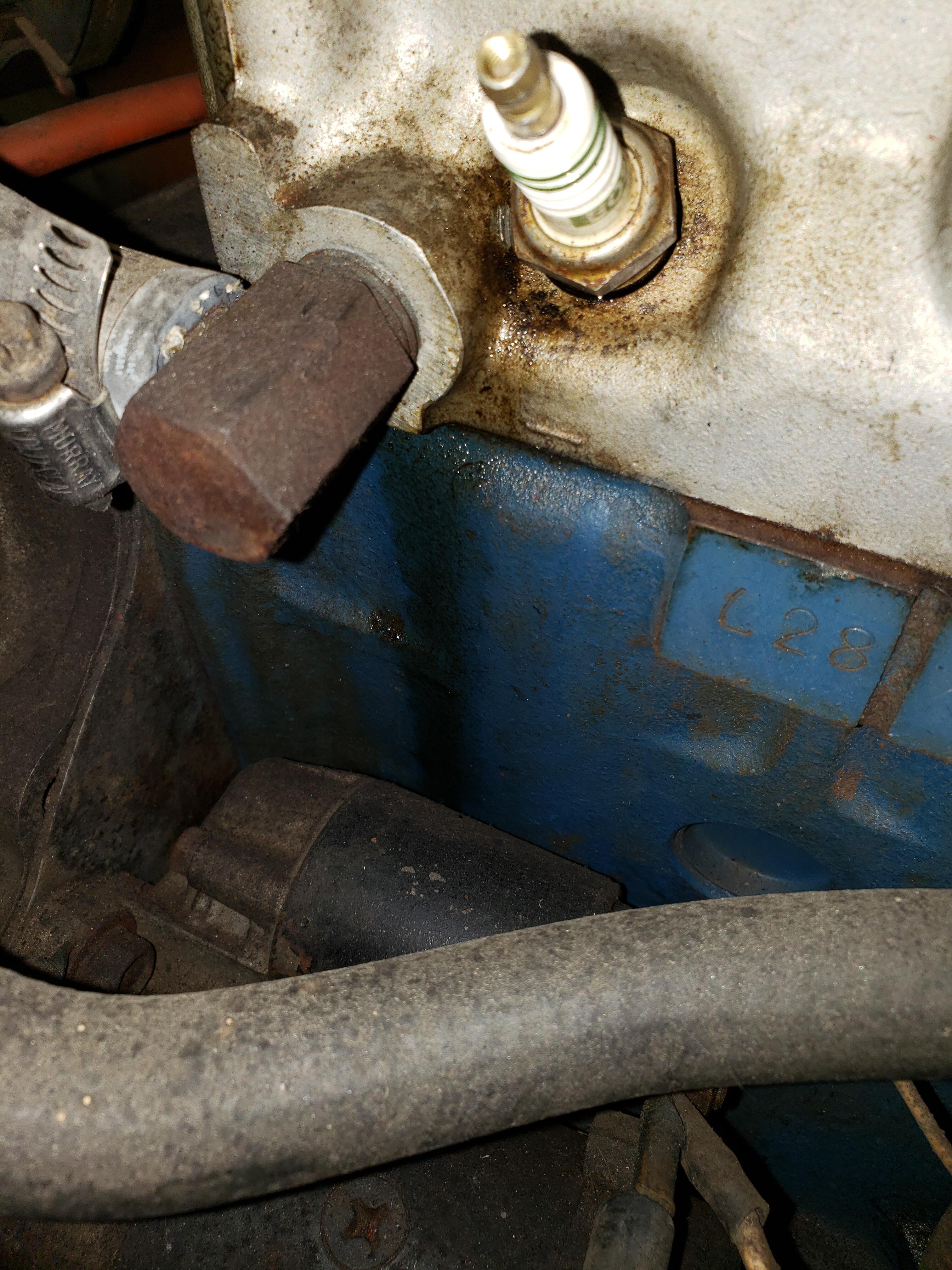

I inspected the body a little more and it looks like there is some filler on the rockers but not a lot. All in all the body is solid. I then started the car and the first time it started up just fine... however, the second time it started and shut back off. I restarted it and it was running really rough, like a bad misfire on a couple cylinders. I didn't have time left in the day to start diagnosing it but I took a look around and noticed oil around the spark plug on cylinder 6. I removed the plug, which was very loose, and could see evidence of oil on the threads and around the spark plug well. I suspect there is a valve stuck open or not fully seating or worse, the piston rings are shot or seized up. Any suggestions? The car ran beautifully last week when I put it in the garage.
