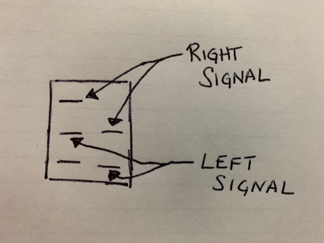

How is my methodology half right?  You’re not making any sense. I’m telling you that when the switch is either in the up or down position. Neither of the left or right blinker solder points are showing any voltage.  I have tested all 4 points when the switch is up or down.

Here is something I sketched up previously and forgot I had;
NOTE; The numbers on the diagram are arbitrary, they are there to show that there is continuity.
Where it states "NONE" means there is no continuity, my multimeter shows a blank when there is none. One multimeter used to have showed a "1" so either reading is correct for no continuity.
