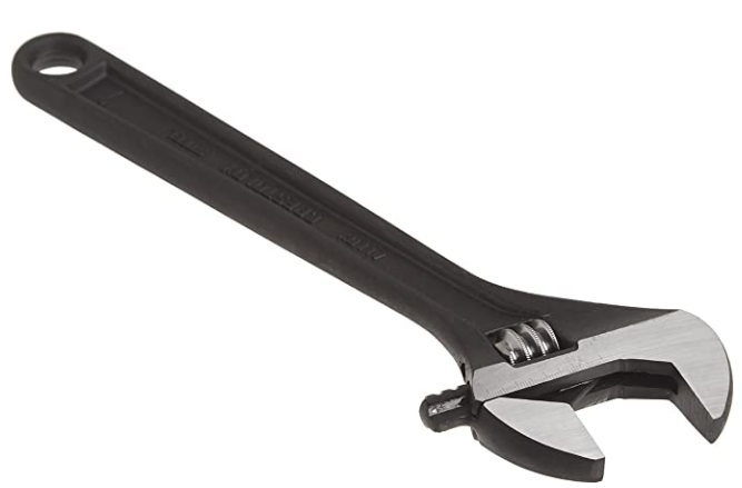

Just remembered that my favorite square head bolt tool is a large Crescent (adjustable) wrench.  The 12 inch model was surprisingly strong.
https://www.amazon.com/Crescent-AT212VS-Finish-Adjustable-Wrench/
