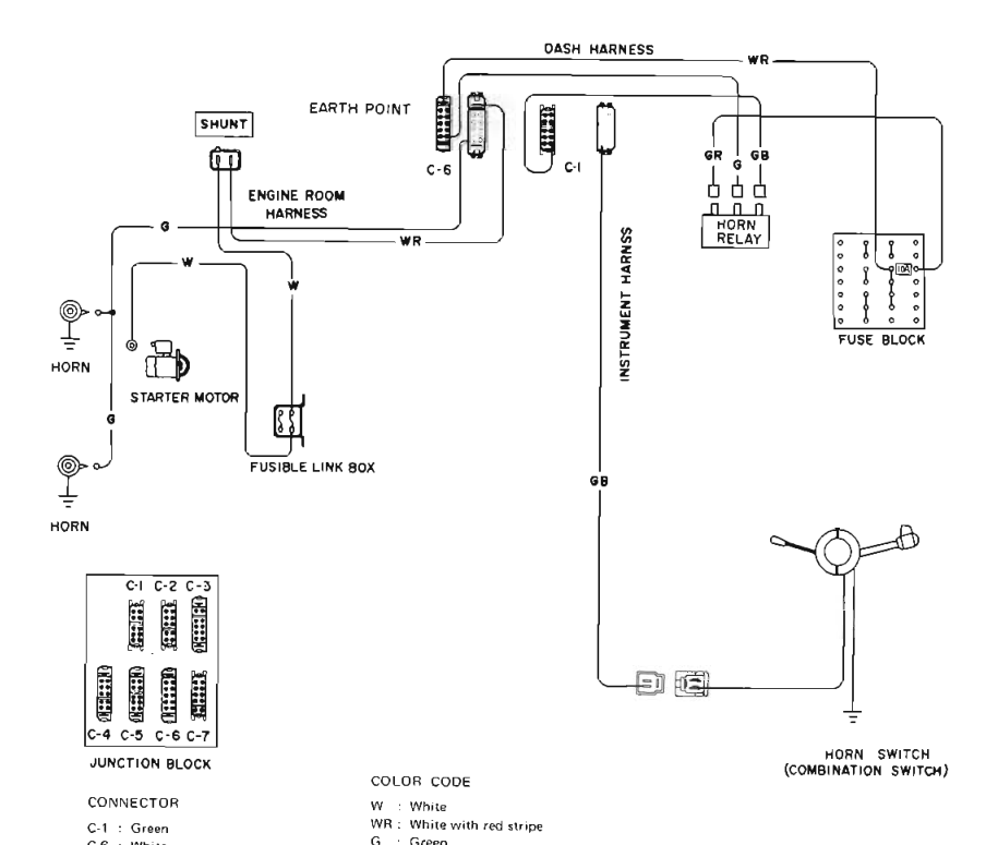

June 23, 20214 yr Author comment_623989 Ok. Should the green at horn in steering wheel have power all the time ?? My green gets constant power. As for the 3 going in relay. Only 2 have power. Is that correct?? Link to comment https://www.classiczcars.com/forums/topic/65522-260z-horn-signals-wipers-not-working/?&page=5#findComment-623989 Share on other sites More sharing options...
June 23, 20214 yr comment_623990 Yes, the green wire is the ground wire for the relay solenoid. When you press the horn button the green wire is grounded, actuating the relay, which then passes power to the horns. You can take that green wire and touch it to a ground and the horns will get power. Honk. Link to comment https://www.classiczcars.com/forums/topic/65522-260z-horn-signals-wipers-not-working/?&page=5#findComment-623990 Share on other sites More sharing options...
June 23, 20214 yr comment_623991 The diagram is not the greatest, they show power as starting at the starter, they left out the connection back to the battery positive terminal. Kind of incomplete. Link to comment https://www.classiczcars.com/forums/topic/65522-260z-horn-signals-wipers-not-working/?&page=5#findComment-623991 Share on other sites More sharing options...
June 23, 20214 yr Author comment_623992 But when I’m testing green at horn - it has power. When I press button it still has power. Is that. Wrong ??? Link to comment https://www.classiczcars.com/forums/topic/65522-260z-horn-signals-wipers-not-working/?&page=5#findComment-623992 Share on other sites More sharing options...

June 24, 20214 yr comment_623995 1 hour ago, Shawninvancouver said: But when I’m testing green at horn - it has power. When I press button it still has power. Is that. Wrong ??? That is all correct. The power is used to actuate the relay, which then lets power through to the horns. The horn button always has power, that's why the horn always works, key on or off. Link to comment https://www.classiczcars.com/forums/topic/65522-260z-horn-signals-wipers-not-working/?&page=5#findComment-623995 Share on other sites More sharing options...

June 24, 20214 yr Author comment_624003 Ok. Got fuel and amp gauge working abs side markers. Unplugged C3C4C5 I wiggled C3 as it’s way up there and a few things started working. Now just horn left. I assume I need lots of gas in tank to register like quarter tank. I just had a Jerry can do it shows empty. Now just horn. If horn relay is working will I hear it click or not,? Link to comment https://www.classiczcars.com/forums/topic/65522-260z-horn-signals-wipers-not-working/?&page=5#findComment-624003 Share on other sites More sharing options...
June 24, 20214 yr comment_624004 11 minutes ago, Shawninvancouver said: If horn relay is working the horn will make a horn noise. Link to comment https://www.classiczcars.com/forums/topic/65522-260z-horn-signals-wipers-not-working/?&page=5#findComment-624004 Share on other sites More sharing options...
