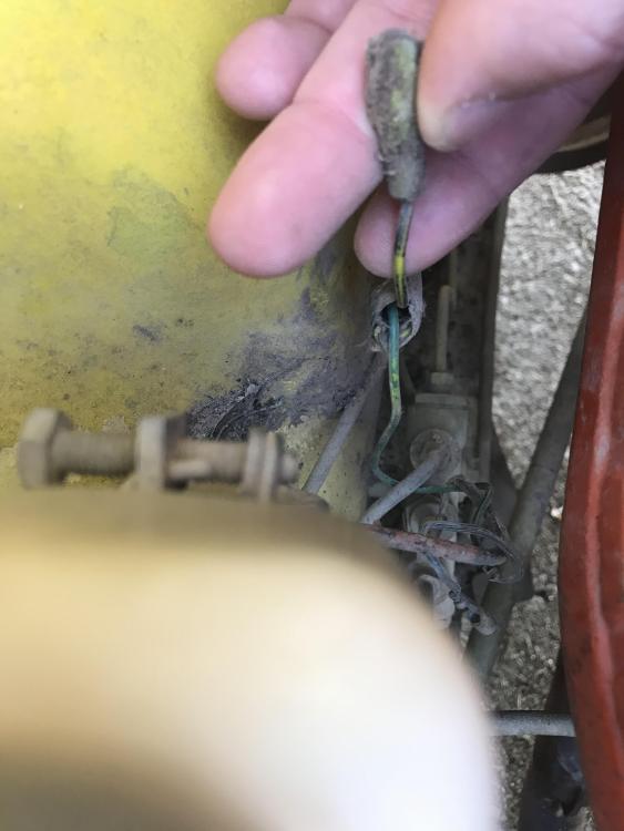

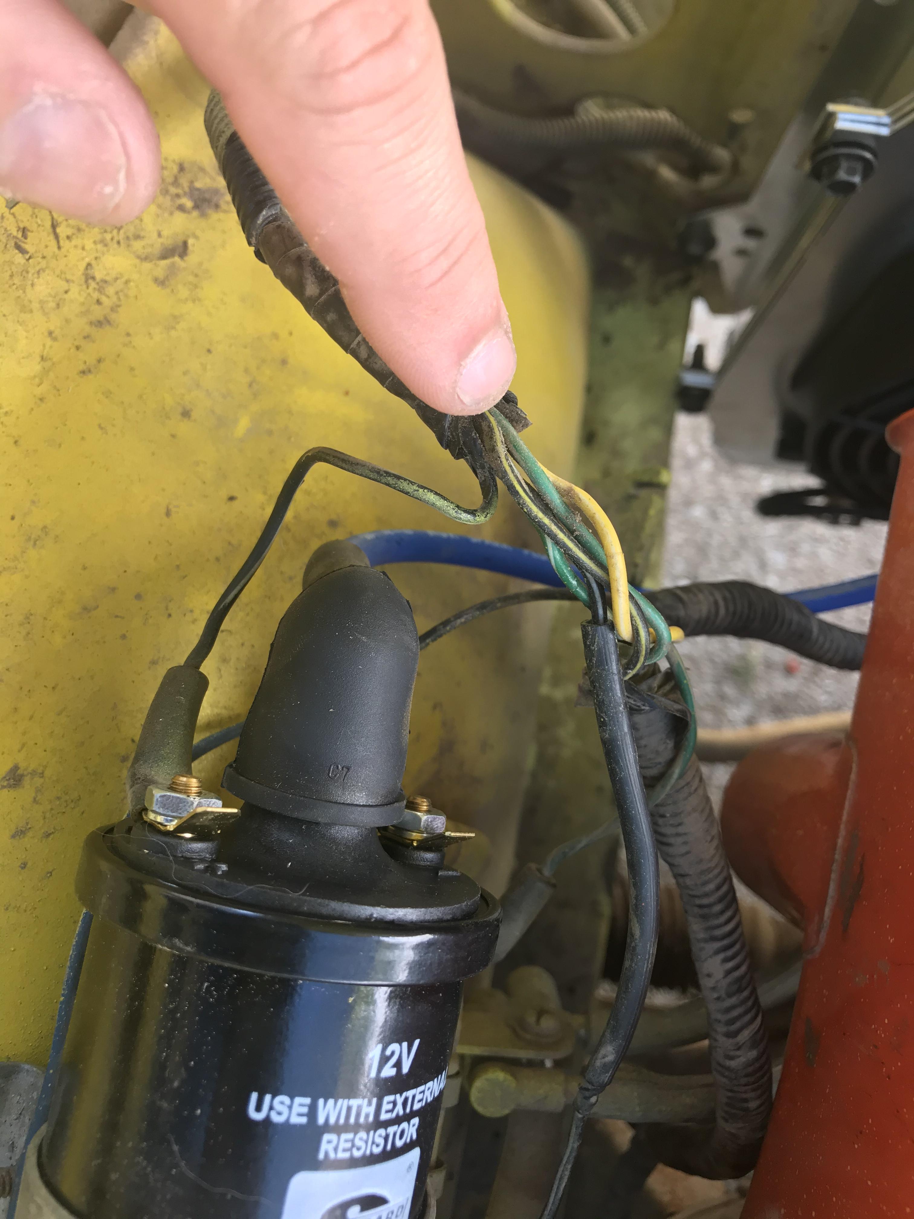

mom the B/Y wire theory though.... wire have been cut and moved by the ballast resistor also so I though it would look. So right next the the resistor in the loom there is a B/Y wire that goes back under the brake master cylinder. It’s a female spade connection but not connected to anything at all.

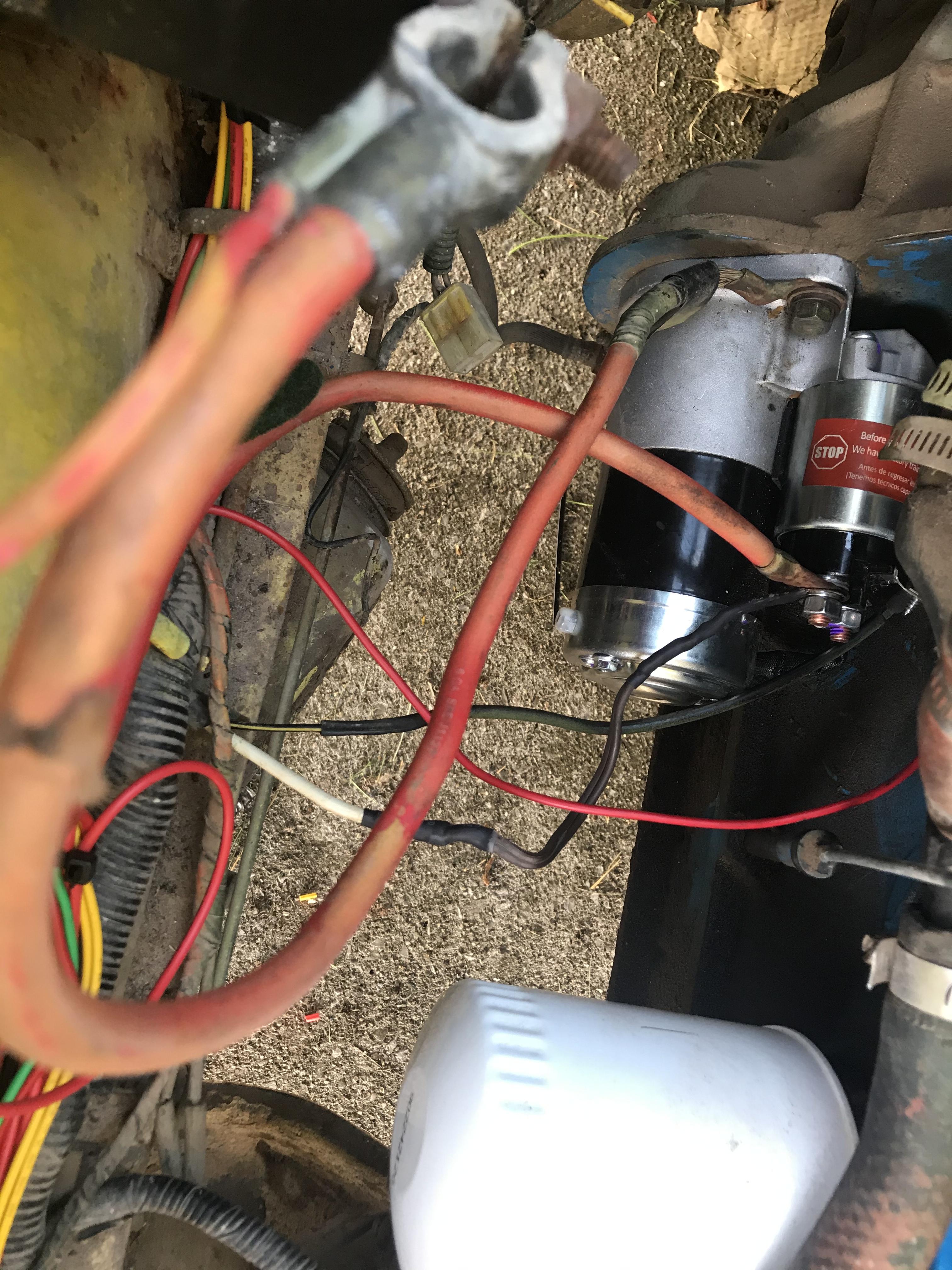

I am going to try and attach pictures. Also just throwing in a starter picture for reference

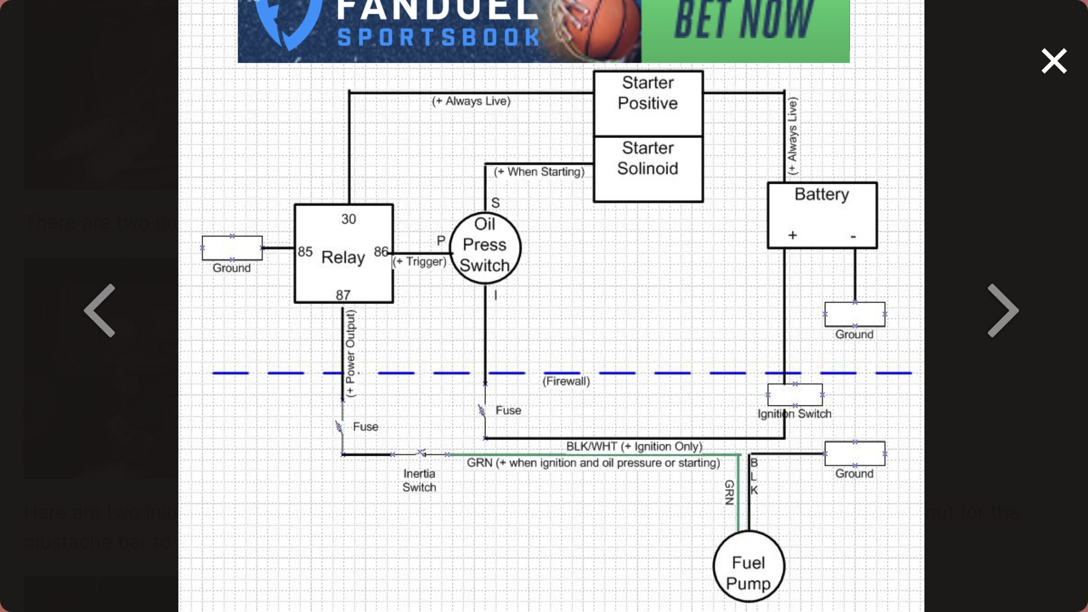

I think maybe I figured it out. Possibly.... in my attached picture diagram, the wire that shown going from the oil pressure switch to the starter solenoid.... where should this be attached to? It’s lists it should be + when starting? I had run this to the starter spade connection along with the B/Y wire
