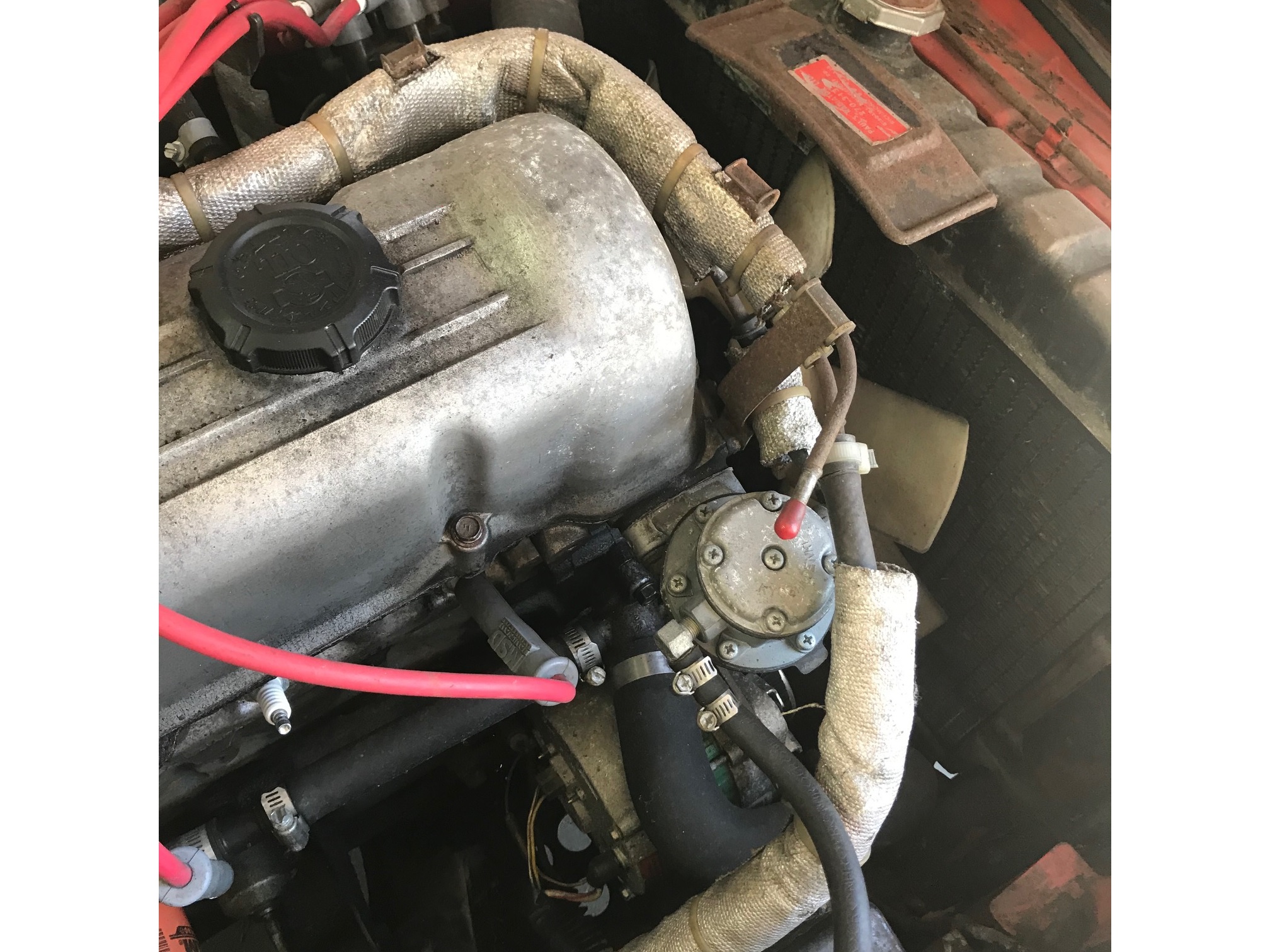

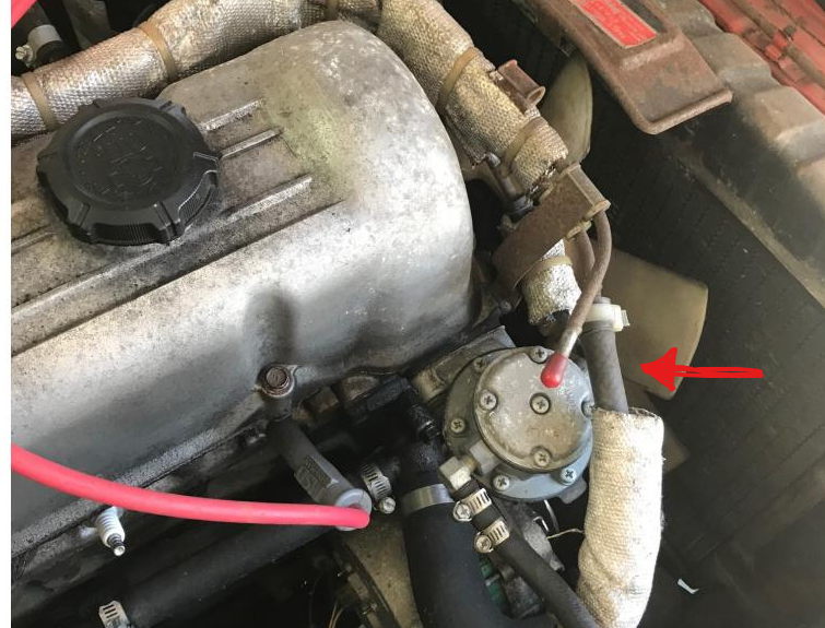

1974 260z  - can you see a return fuel line here? car originally had issues sputtering and no fuel flow.. is there something missing here??
Ok. That’s what I thought.   Where should it go to? A fuel line?
what are the effects of no fuel return? Could it lead to sputtering and no fuel flow ??
Actually, the red cap is blocking off the vent line. That should go to the carbon cannister
The middle line is the return.

You have a return line. I see a hose attached to it. Like I said before, the capped off line is a vent line for evaporative emissions.

Apparently it’s the vent that is capped off with red cap.  Fuel return is there in white heat cover.  I know the mechanical fuel pump.  Where is the electric fuel pump.  Can someone show me this??
