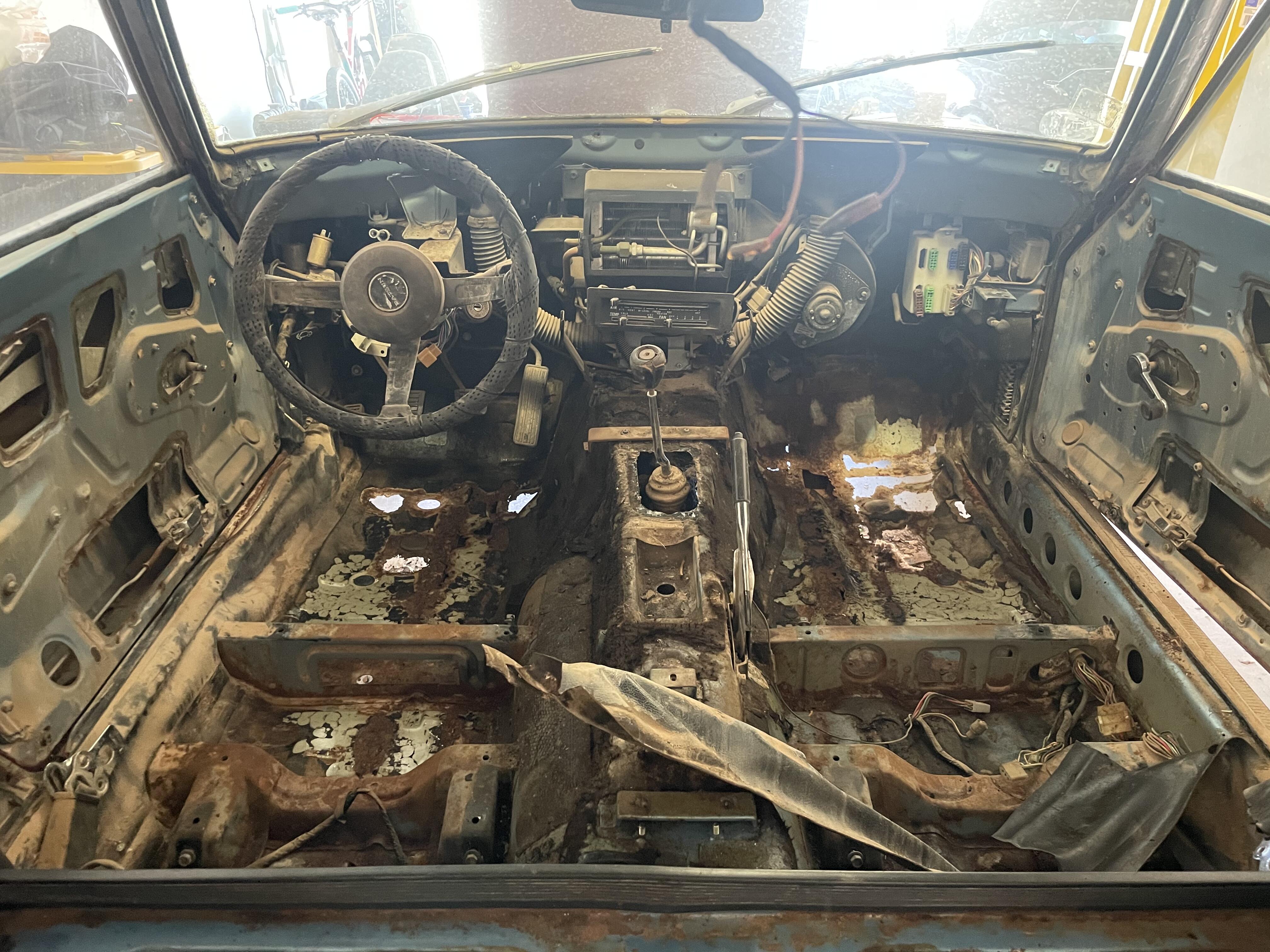

@Barefootdanwhat did you use to scuff down the floors? And how was it getting the tar pad off? I have it on my floors and am debating if I want to take it off or keep it? Seeing as mine doesn't have as much floor damage as yours, would you recommend leaving it on or removing it? I have pneumatic sanding equipment and sand blaster at my disposal so I'm torn as to which way I should go... Personally, I was thinking of removing it and using POR15 throughout. Also, what do you plan to do with the undercarriage? Thanks in advance for your input.
@Patcon what's the method of removing with DI? Ive never heard of it.. also, is it recommended do do so with a clean body? sorry @Barefootdanfor hijacking the thread....

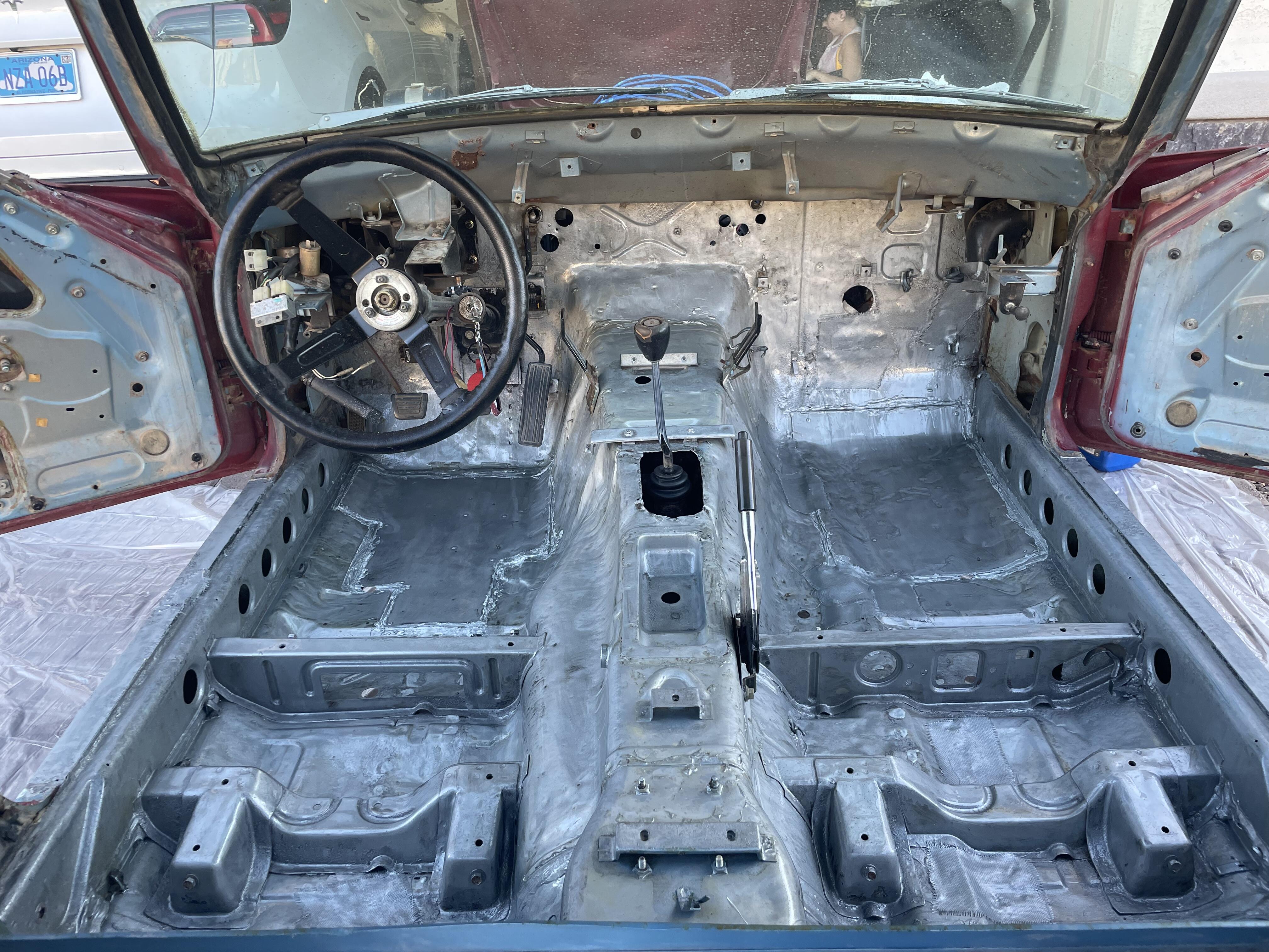

I started off chiseling away with a flathead and hammer. It works fine but is so slow. I then picked up some dry ice and it was so much faster. I crushed it in a bin and used isopropyl alcohol to help spread the freeze. A rubber mallet cracked it off pretty easily. Speed Academy on YouTube has a great example of it working on their Celica.
Then I used a paint stripper disc on my grinder to get the remaining goo and paint off. I liked that I removed it so I know there wasn’t anything hiding underneath. POR15 will be my coating of choice too and probably just a general undercoating for the bottom side once I’m all wrapped up inside 🙂
Once the tar mat is really cold, it tends to come off in big pieces.
Most just spread it in the floor board,  chill, then use a hammer and a scraper. Some have even been able to use a rubbef mallett and just strike the floor and the mat shatters off in pieces.

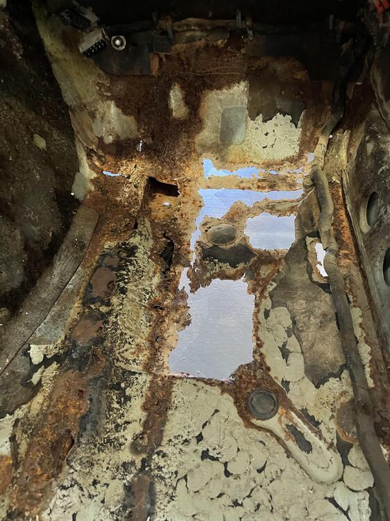

Finished getting in the panels this weekend. Feels super good to have floors again! The patches went in really smoothly with the 3M panel adhesive hardening like steel in my test cup. POR15 is on order so that will be my next step! I gotta figure out how to get the Datsun out to wash the floor without it running...

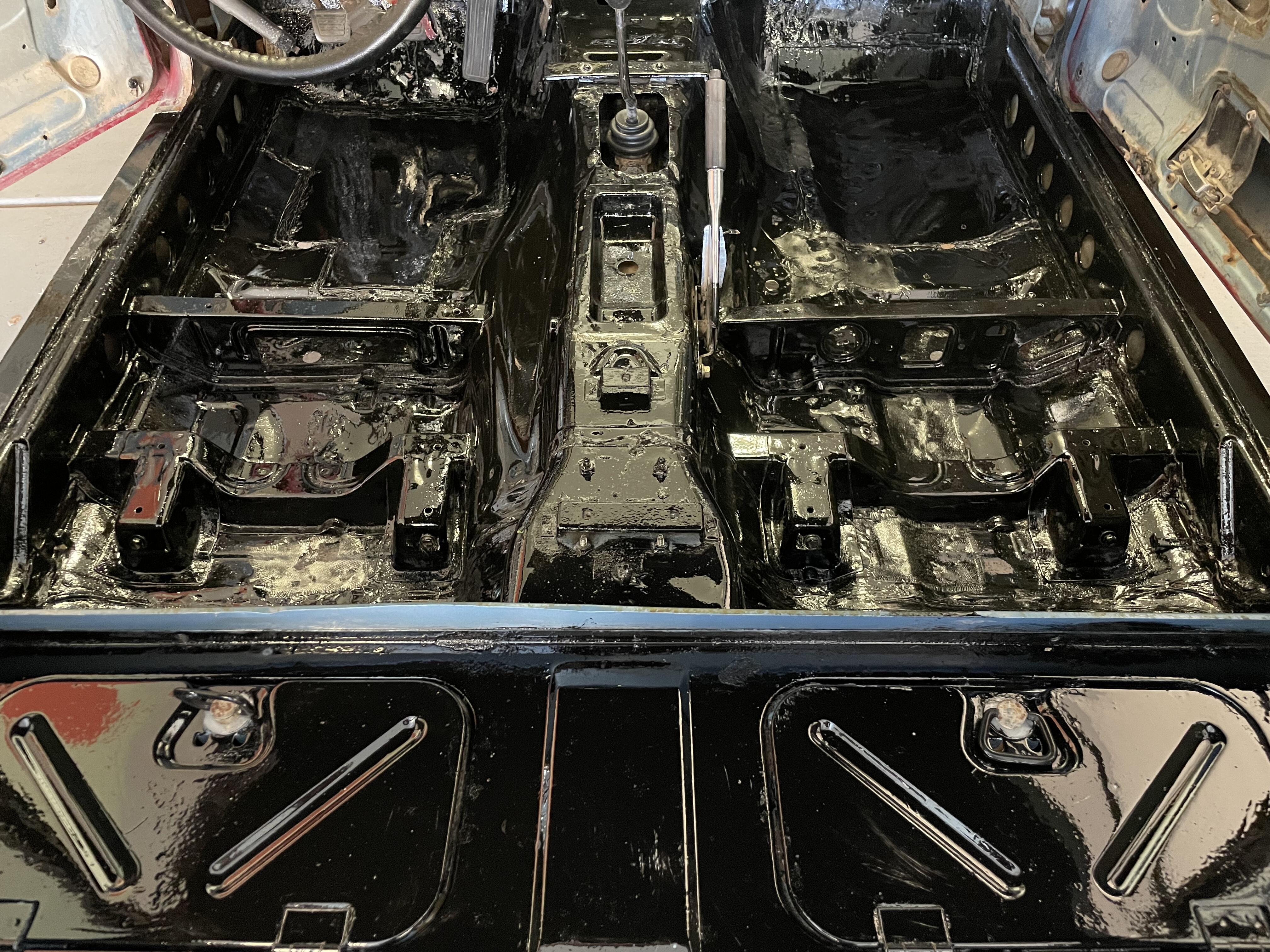

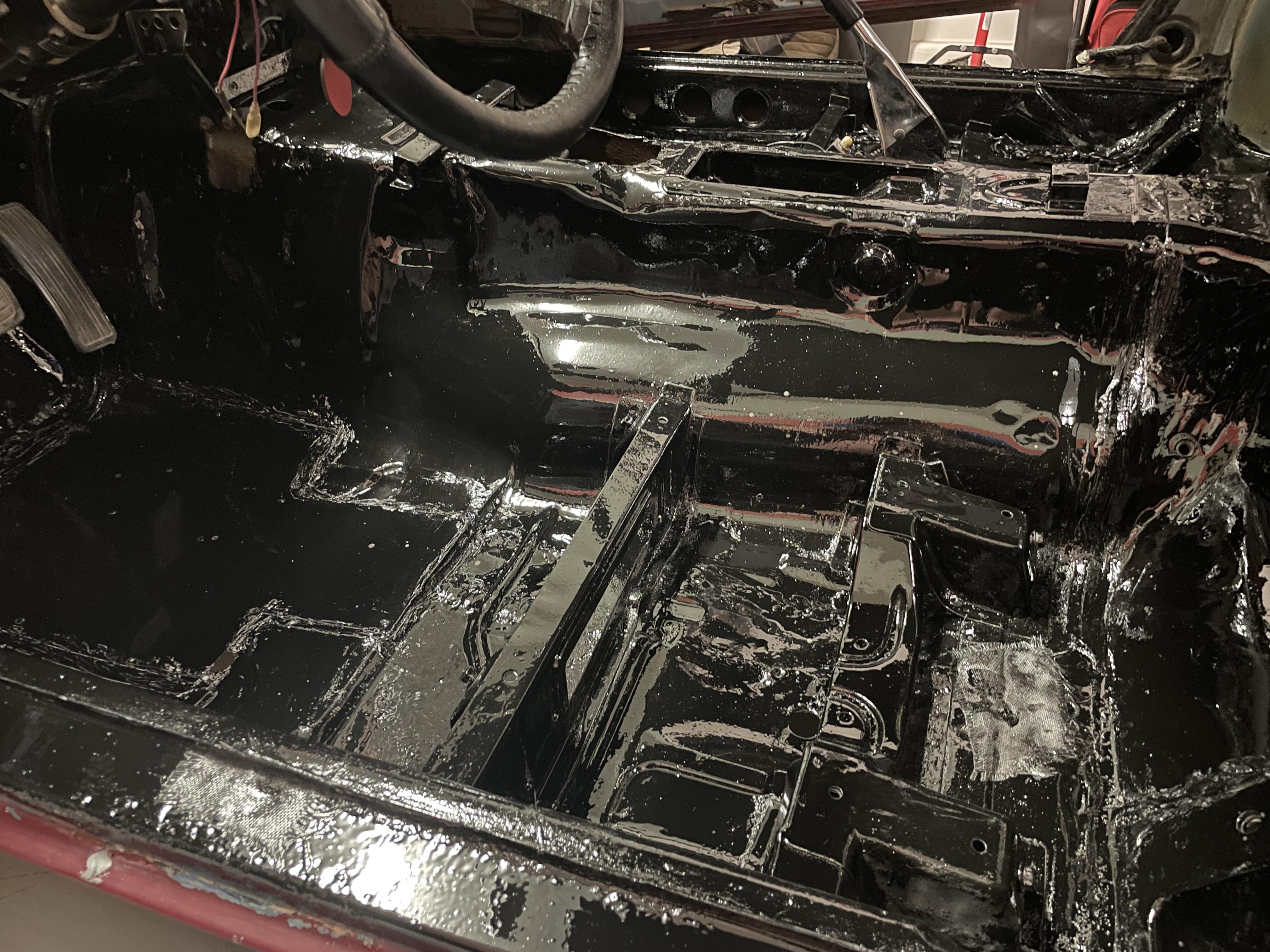

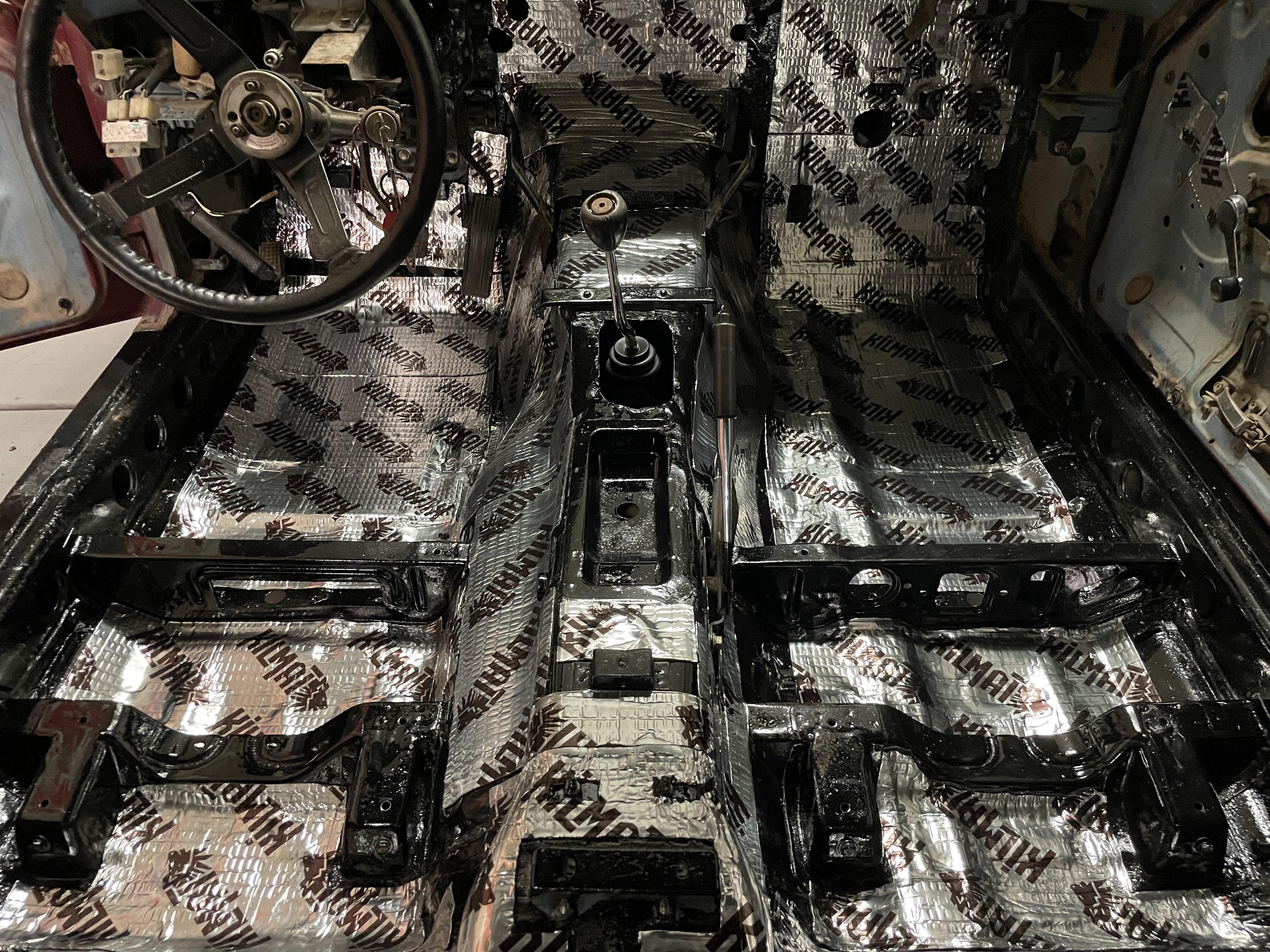

Worked on wrapping up my flooring this weekend. Started off with POR15 base coat which was silver. I used their fiberglass fabric to fill in any extra pin holes I had laying around. No longer in the stone ages like the Flintstones!
Then used the gloss black for the second coat. This helped a ton with finding where I missed a second coat. If I were to leave the floors raw, I would use their top coat. It adds UV protection and a satin finish. The gloss black shows every imperfection! But it does level extremely nicely. No brush strokes in site.

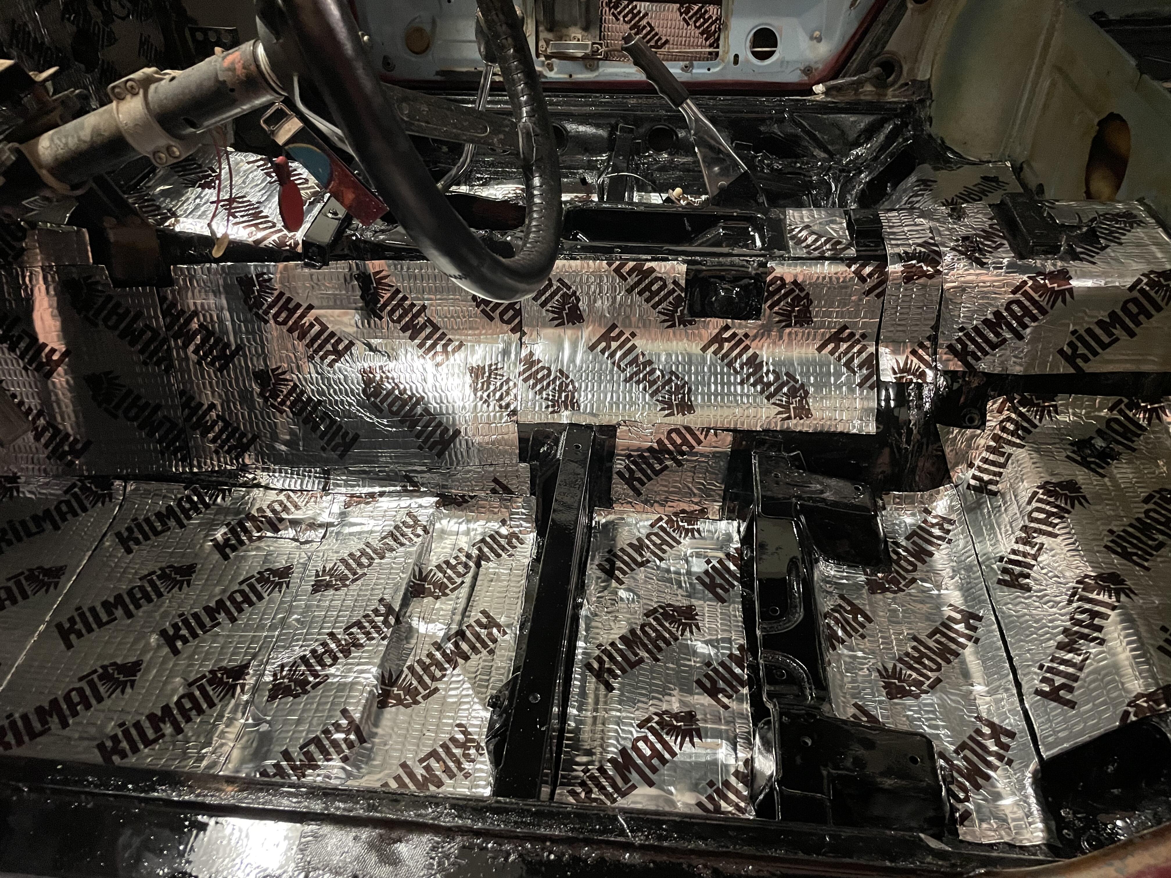

Lastly I used Killmat as my sound deadening. I started off with just trying to hit the main flat spots of each panel but I have way more material than I though I needed so I started to fill in the blanks. Overall I’m happy with how it came out. Not that it matters since it will all be covered with carpet 😅
But boy what a nice change to be able to sit in the car and not worry about getting tetanus or dragging dirt into the house. No more smells of musk and I won’t hear every rock and pebble 😊
