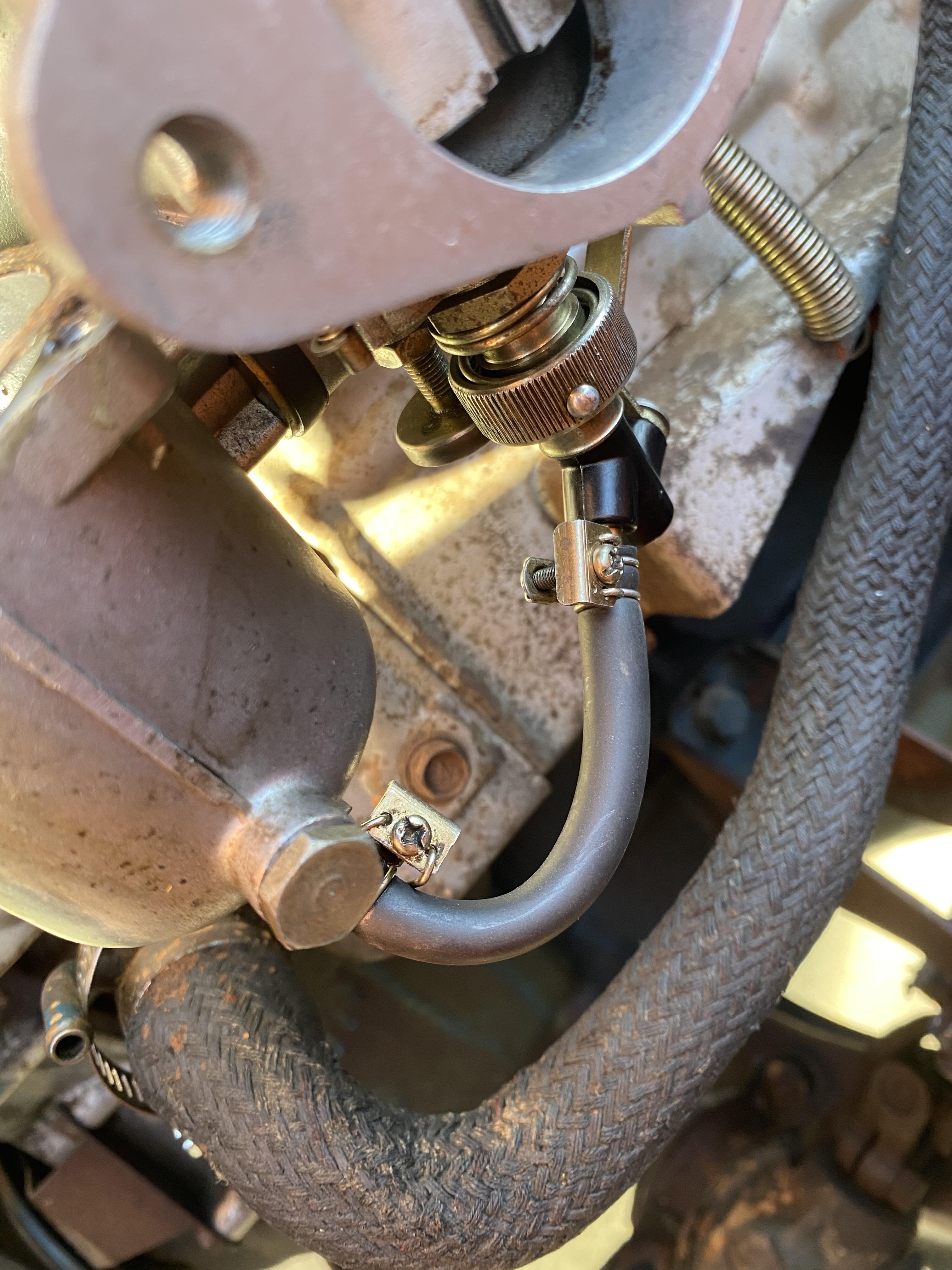

April 25, 20214 yr comment_620445 Was thinking same thing as Patcon; a possible air leak in the one carb, spray around intake, etc, with carb cleaner and see if the idle changes. Also, looking at the pic, it doesn't look like the fuel hose between the float bowl and carb is long enough to provide smooth up and down motion of the nozzle (might be the angle of the pic). Link to comment https://www.classiczcars.com/forums/topic/65207-carb-issue/?&page=6#findComment-620445 Share on other sites More sharing options...

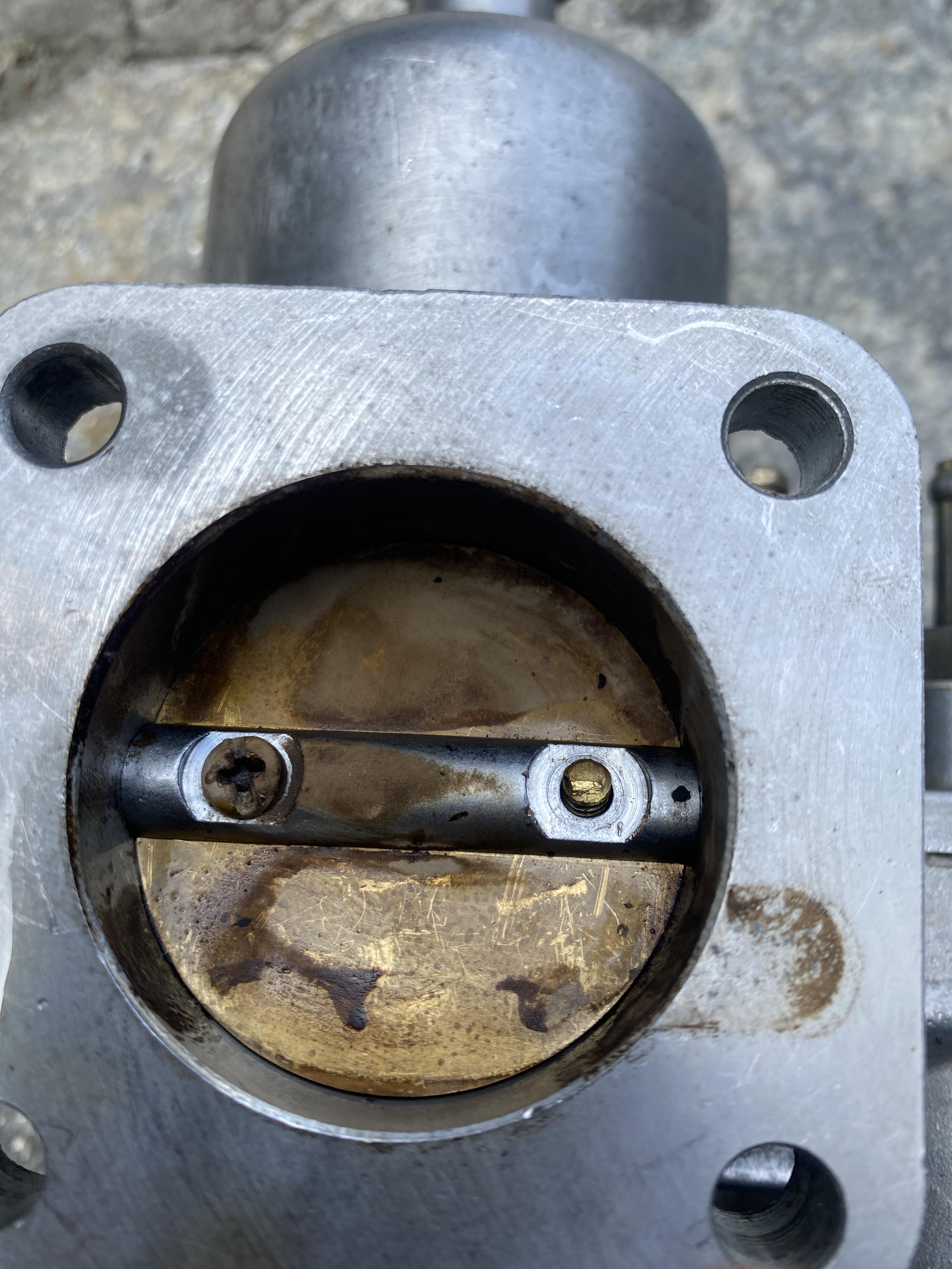

April 25, 20214 yr Author comment_620470 5 hours ago, Patcon said: And the fuel nozzle is clear all the way up? If everything is clear and you still have the lean condition on only one carb then you probably have an air leak somewhere on the lean carb or intake manifold Could this be an issue? Just found it Link to comment https://www.classiczcars.com/forums/topic/65207-carb-issue/?&page=6#findComment-620470 Share on other sites More sharing options...
April 25, 20214 yr comment_620478 Is the screw missing or installed from the other side? Looks like it's missing and I'd guess that's a problem, maybe unrelated to what you have going on but I would get one in there asap. Edited April 25, 20214 yr by siteunseen Link to comment https://www.classiczcars.com/forums/topic/65207-carb-issue/?&page=6#findComment-620478 Share on other sites More sharing options...
April 25, 20214 yr Author comment_620481 15 minutes ago, siteunseen said: Is the screw missing or installed from the other side? Looks like it's missing and I'd guess that's a problem, maybe unrelated to what you have going on but I would get one in there asap. Someone jammed it in and broke the head off.... Link to comment https://www.classiczcars.com/forums/topic/65207-carb-issue/?&page=6#findComment-620481 Share on other sites More sharing options...
April 25, 20214 yr comment_620483 So it's not an air leak. That's good but I'd still want to fix it I guess. Not too important if it's secured to the butterfly. Link to comment https://www.classiczcars.com/forums/topic/65207-carb-issue/?&page=6#findComment-620483 Share on other sites More sharing options...
