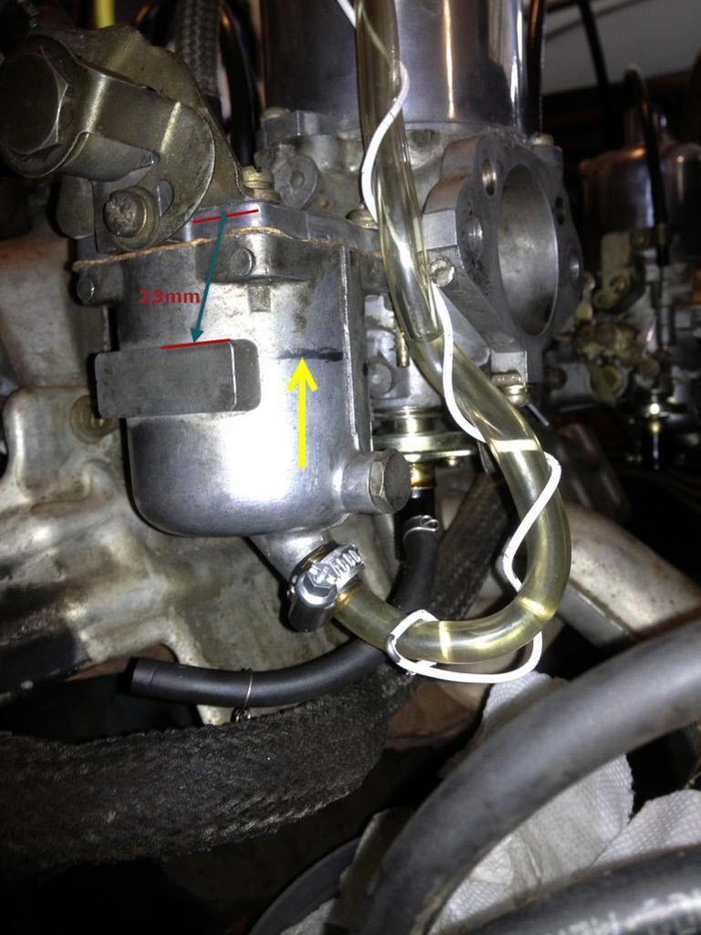

It seems like the float chambers are running out fuel really fast. With the ckokes on the nozzles are dropped lower adding more fuel. I would get section of clear hose and check the levels. That's the easiest way to get an idea of where you're at. Should be even with the mark at the yellow arrow. You get that hose at Lowe's or Home Depo. I think it's 1/4". Just one 2 foot piece is all you need. Cheap and easy.

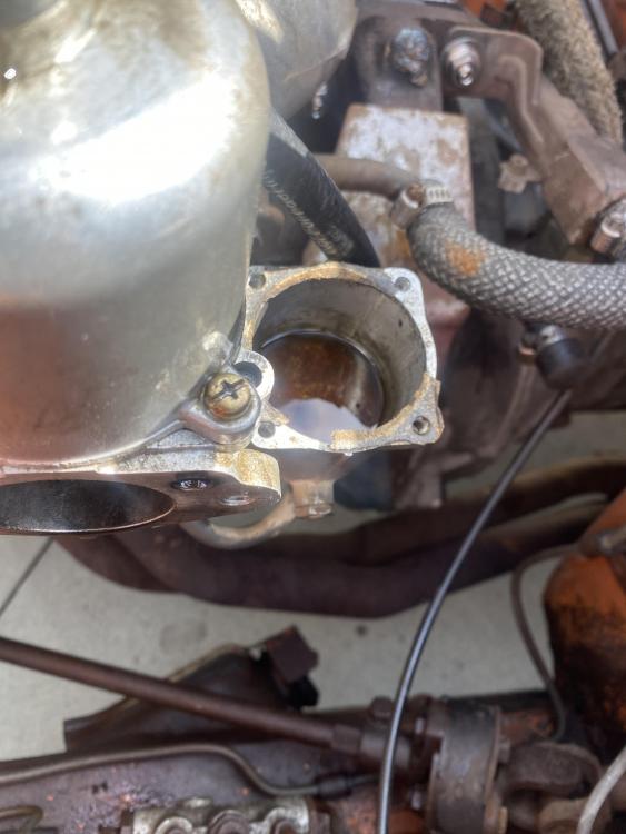

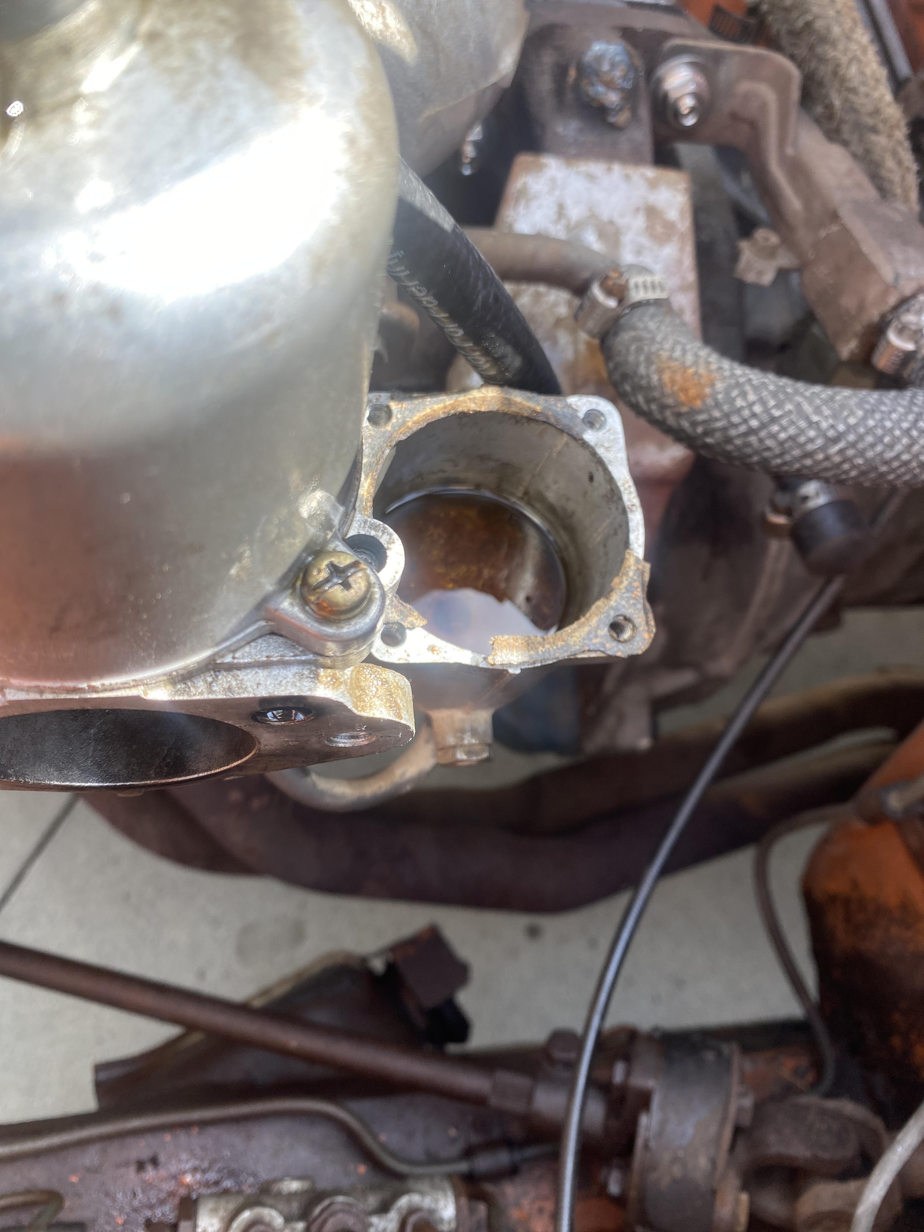

Here is the float on the rear carburetor and also the float chamber. Also forgot to mention that these are 4 screw SU. I did use the gas can before and that’s when I had it running. When I hooked it up to the tank didn’t run so well.
I think your assumption of the floats being out of tune was correct. Seeing that the fuel only filled a small portion of the chamber. I’ll go about adjusting it and see what I get. The more and more I open this carburetor the more I feel the need to rebuild it. I’ll let you know how it goes

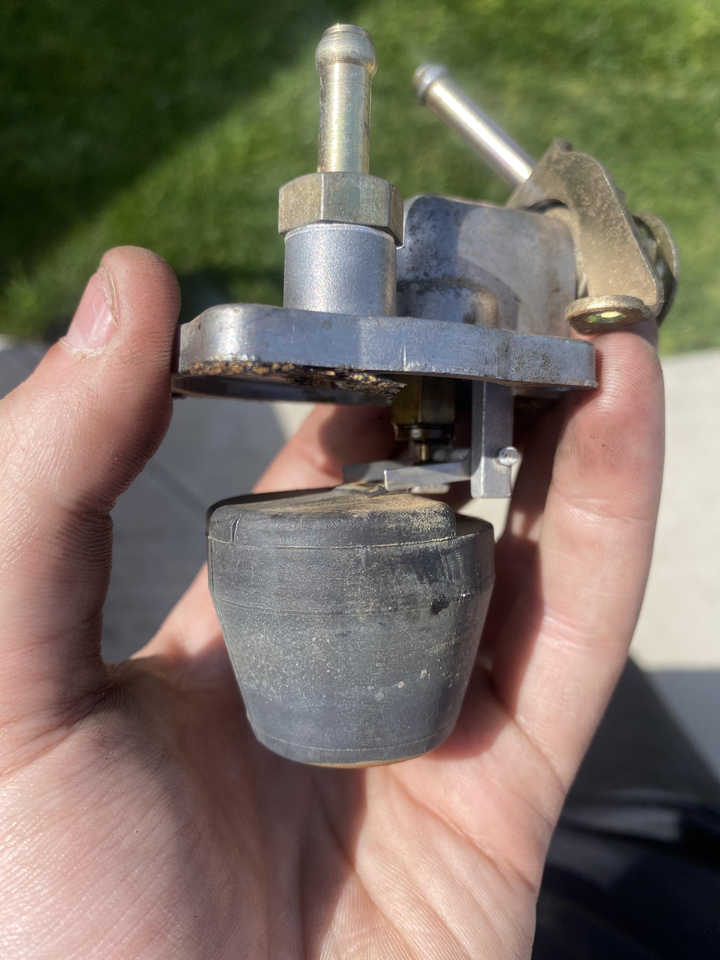

I adjusted it as you said but I’m still not getting any gas into the chamber. Pressure builds up and everything until it goes to line from the float chamber into the carb. Am I not having enough pressure in my fuel lines? I don’t think I have a vacuum leak. Only thing I didn’t plug up was the fuel tank evap into my cylinder but I doubt that’s the cause of anything. I put on another mechanical fuel pump but found out that one didn’t work well compared to the one I had. Pressure builds pretty quickly and I’ve taken apart the carb to inspect the needle and everything seemed fine. Not quite sure what’s wrong with the carb.

I bought new ones so they don’t cripple. Only issue it feels like is the fuel isn’t going into the carb. I can feel the fuel inside of the hose but it seems like no pressure is pushing it up. I did the straw method to test to see how much fuel is in and I saw the fuel spill off to the sides of the float chamber because my gasket is pretty much gone. Could this be preventing enough pressure to build up in the chamber to push the fuel into the carb? Do I have to cover the nozzle that connects the chamber to the air filter? I checked the jet and blew through it and the air flows through it just fine. The piston goes up nicely and falls down with a click. The floats are adjusted properly but one of the pin inside the front carb didn’t go back to the resting position but I took it apart and fixed it. Each chamber has 20mm of fuel in them. Did the drop test and it was fine. I’m just lost at what is the problem.
Edited by Alexg280z
 Have you checked the fuel filters inside the banjo fittings that are on the top of the float bowls? They could explain fuel in the fuel lines but not enough entering the bowls. Carbs really don't need much fuel pressure. They'll even run fine using a gravity feed.
