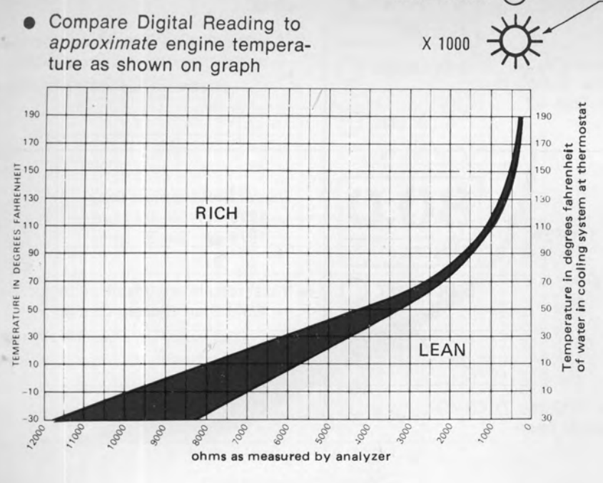

The other "extra fuel" thing is the cold start valve.  Somebody just had that problem.  Your resistance looks about right, chart below.  You can disconnect the fuel hose and plug it for a test.  It will have full fuel pressure behind it so be careful.
