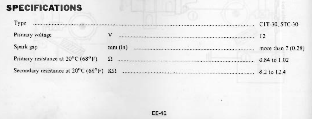

The 1978 ignition system uses a 0.84 - 1.02 coil.  It's in the FSM.  No reason to vary from that, it's a "high-energy" wide spark plug gap system.
Looks like everyone is consolidating on the label, and not the specs.  Those flames look cool.  OReilly has one that is supposed to meet spec. but they don't show the spec.  Rockauto is am option.  They have an NGK coil.  Coils are a basic electrical component.  The flames and colors really don't add much.  A 1.5 ohm might actually give you less spark power than a 1.0.  I like to stick with matched components if I can.

That’s excellent now that I know the range I know what to shop for
