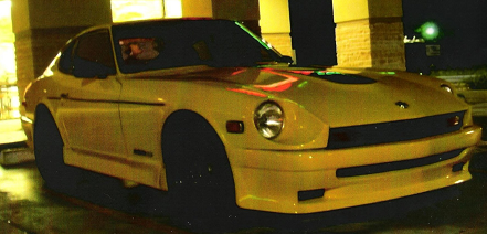

I'm 'restoring' my 280Z. Years ago, I removed the big bumpers and put on a full aero kit, as seen here:
I assume that this kit was designed to go over 240z bumpers, but I ran for several years with no bumpers at all.
Now I've removed the rear part and filled in the holes, and removed the sides, which I think contributed to rusting out the rockers.  But I think the front will still look good.
So my question is, should I fabricate a bumper to fit under this fiberglass, perhaps from tubular or angle steel?  I'm thinking it might provide protection to the radiator and A/C condenser in the event of a minor tap.

For what it is worth, here is my take on the subject of bumpers on the S30.
The chassis is 100% sheet steel, formed into a monocoque to support the suspension loads imparted while driving, while also carrying the engine, drivetrain, interior (seats, dash, wiring, spare, etc.) glass and the bodywork that doesn't contribute to the structural integrity of the car.
The early bumpers were flimsy at best, only included in the design to satisfy the safety regulations of the era. The addition of the 5mph bumpers changed the chassis little, primarily with the addition of reinforcement where the shock absorbing cylinders were mounted to the ends of "frame".
And then the bumper only needed to protect the car's occupants in a 5mph collision.
Look at any of these cars that has been involved in a collision even at relatively low speeds, such as 25 to 30mph. They crumple up like an empty beer can. And the bumpers are often lost in the wadded up sheet metal.
So to your question abut an inner bumper to support the aftermarket airdam/bumper. Absolutely, a close fitting tubular inner support would work great to reduce the damage done by inconsiderate jackwads who view cars as an appliance and lack any regard for awesome classic sports cars. There will still be damaged, albeit mostly cosmetic, a simple repair.
Hit it harder and as Charles points out, the impact loads are likely to transfer a great deal of the energy into the framerail and inner structures that share the loads in that area (remember,  monocoque).

It is your car so the final say is yours, so do what your best judgement dictates.

Yes!
