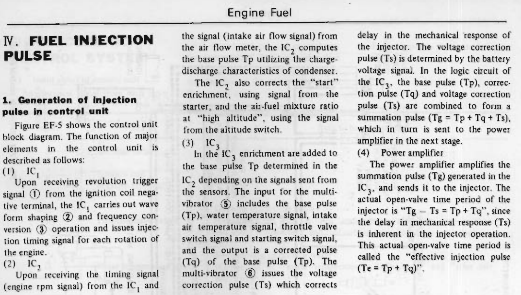

The ECU's are analog computers and use capacitors to control injector open duration.  No ones or zeros.  The algorithms are hard-wired in, no programming possible.  You can only change the characteristics of the inputs to manipulate the outputs.

You can measure the amount of air using the density sensor and air speed sensors, and the amount of fuel (approximately) using the fuel pressure and injector timing, then making some calculations to calculate the air/fuel ratio.
