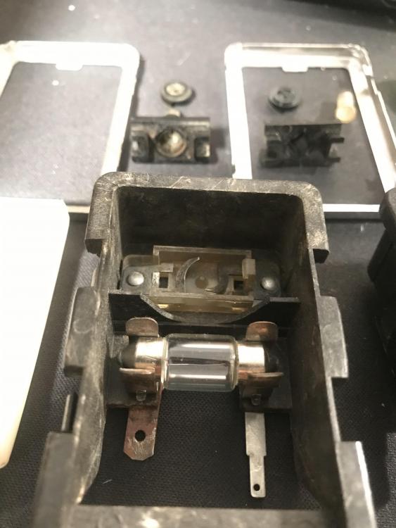

Has anyone repaired a domelight? I have 2 of them in pieces, the arm that holds the switch together snapped off, perhaps a more modern push button switch can be installed into the same position? I lost the spring that is used in the OEM switch, it must have walked off my desk at some point ๐Ÿ˜ž One of the metal tracks looks like it heated up real good, the plastic looks melted where it contacts the stripย

IMHO, there's no need for the switch to be a waterproof type. If you're limiting your search to switches that are sealed, you might get more results if you are willing to accept something that is not weathertight.
@Captain Obvious I was just looking for `push toggle switch on-off`ย  and this came up. The problem is trying to filter out all the round style ones, or the ones that have the solder leads in the wrong spot. I ordered the ebay weather proof ones because of the cost and it was pretty close to what i was looking for.
I agree with you about the weather proofing, its totally not required for this. We shall see in a couple days i suppose, otherwise back to searching...

Not sure what parts of the switch you still have, but I've had a bit of success in making contact and springy bits out of a sheet of phosphor bronze.
Negative on the plastic lens, i had to find mine online, i bought one ( and it was broken) They tend to deteriorate in the heat, so you might be better off getting a (newer one) I want to refurbish this one, its a bit yellowed likeย  old video game consoles. The price on these parts has been ~30 for just the plastic lens and $100 for the whole assembly...
Might be able to 3d print them if i can find a white transparent ABS material.
