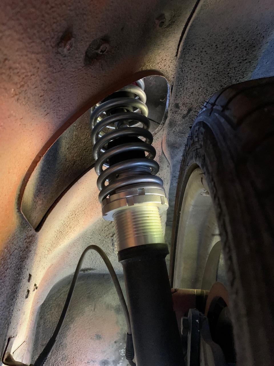

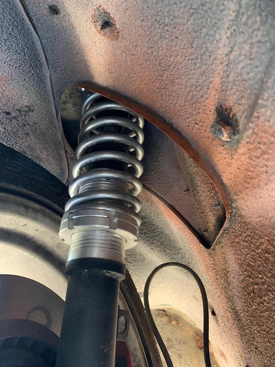

Here's some images of the QA1's with their springs and collars.  Don't know how the collars could have changed over two years.

Yeah certainly looks lower one side, maybe it loosened itself up. Try adjusting the lower side up to match the high side.

Didn't notice that they were adjusted differently until these images.  Looks like I'd have to jack it up, remove the front wheels for access, needs a special tool to loosen the collar jam nuts then turn the collars.  Which way would I turn the collars in order to increase ground clearance?  Towards the top of the shock or towards the ground?
You would want to raise the P/S coil up towards the top of the shock so it looks like the D/S, the proper collar tool is nice to have but in a pinch you could use a piece of aluminum rod and a hammer.  The bottom collar is the locking nut so once the top collar is adjusted properly you'll need to hold it where it is when you tighten the bottom one.  Clean any grease off of the mating surfaces of the two collars, that will help with the grip.

Progress has been made.  Got the correct collar adjustment tools, raised the passenger side collars up to where the driver side collars are.  Front cross member ground clearance has been increased from 3.5" to 4.5".  I'd like it to be another inch or so higher.
First tried to adjust the collars with some makeshift tools, only succeeded in marking up the aluminum collars.  Getting the right tool for the right job made the task much easier.
