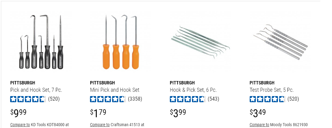

Is there any ways to take off the electrical connectors without breaking them. I can’t seem to find a way to take the little metal clip inside off
It's difficult.  Get some picks, a small screwdriver, a little piece of wire.  I think that anyone who has done a few has developed their own special method.
https://www.harborfreight.com/search?q=Pick And Hook
Yeah I ended up ordering new clips for almost everything in the engine bay.. they are really brital.. I’ll used those as well and it still broke
