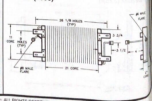

Sorry to revive a dead thread, but I think the original question is an important one. I haven’t seen anyone confirm that a S130 A/C condenser fits into an S30 of any year.
I’d like to know if one would fit in a 1973 240z. I’ve found the dimensions in inches for the 1979-81 280zx version:
If these or the 260/280 versions fit I may get one of these:
https://www.originalair.com/81-83-datsunnissan-280zx-parallel-flow-condenser-high-performance-parallel-flow

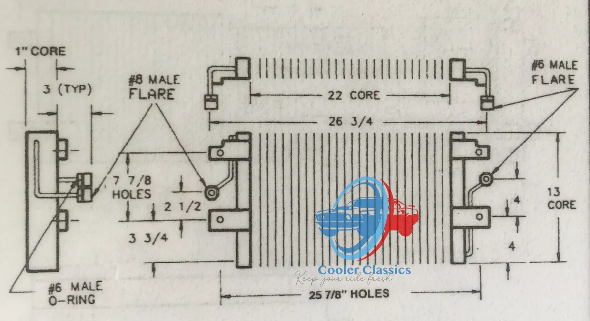

Update: I found the dimensions for the 260z 2x2 and 280z 2x2 Condensers. I am speculating that the 260z had the same geometry as the 240z for this.
260z:
280z:
