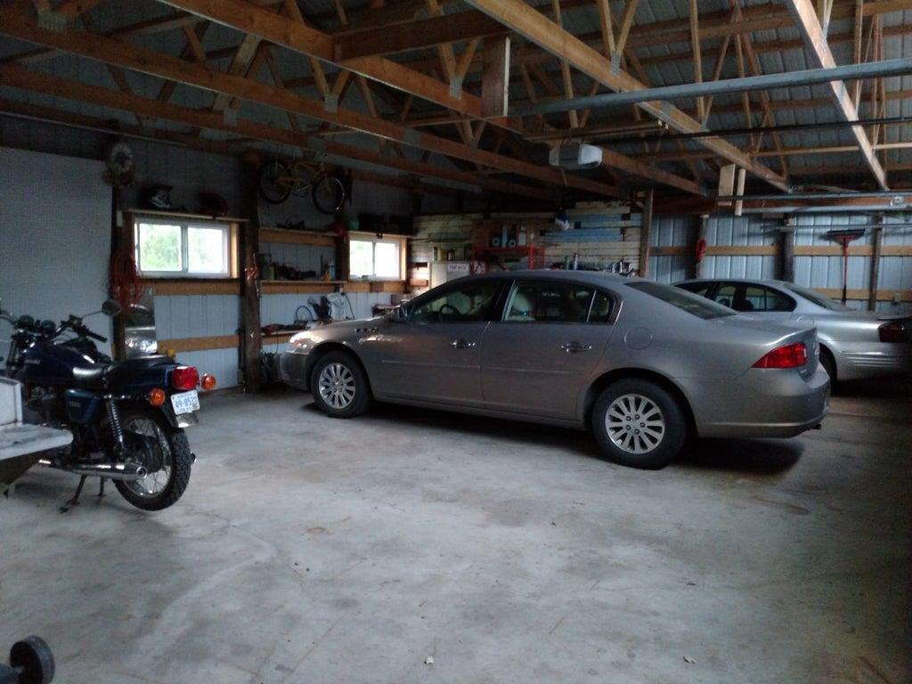

This project came about as I recently rebuilt my garage and found myself in need of complete lighting throughout.
I had two main objectives: I wanted bright/even coverage and I wanted to do it as inexpensively as possible.

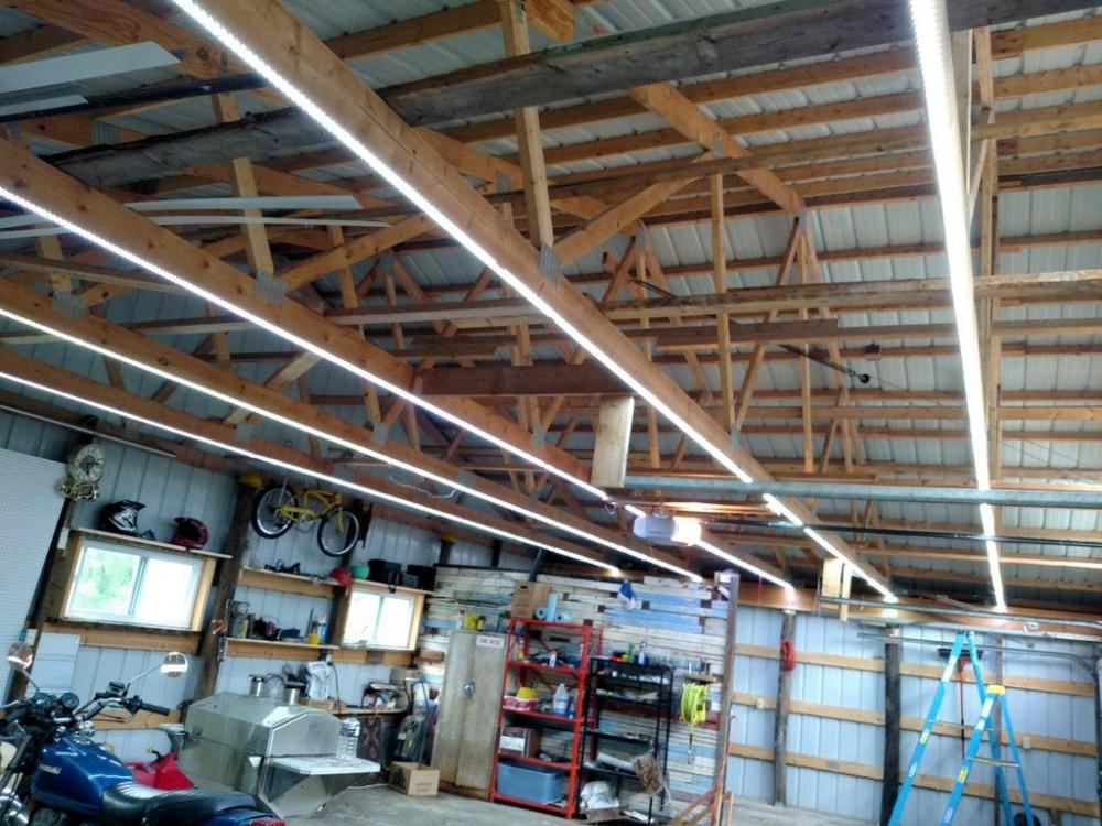

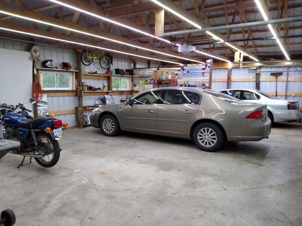

After a lot of thought, I came up with the idea of putting them directly onto my trusses. This would give me even lighting throughout and a clean modern look.

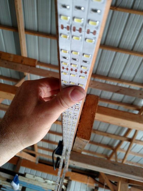

I found that one LED strip wasn't bright enough, so I added a second for more light. This is probably enough for general lighting but I wanted MORE POWER and added a third. Why not at this price, right? To give you an idea of the coverage, my garage is 24'x40'. I'm putting lights on 5 trusses and they are 8'6" off the ground.
The other piece of the puzzle is powering the lights. The LED strips run on +12vdc and require an external power source. You can easily buy 12v power supplies but I'm trying to go cheap, right? So I used old discarded PC power supplies. Cost? Free!
