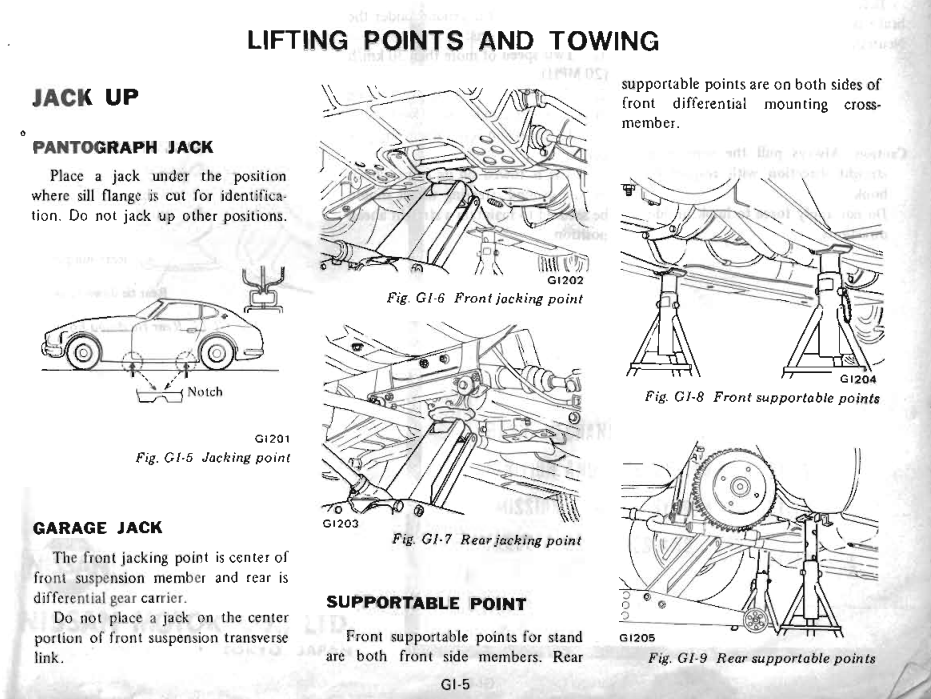

There are several points to jack from and support from.  This is from the General Information chapter.  You'll probably be fine.  The car is only tippy if you lift in the middle, between the recommended points.

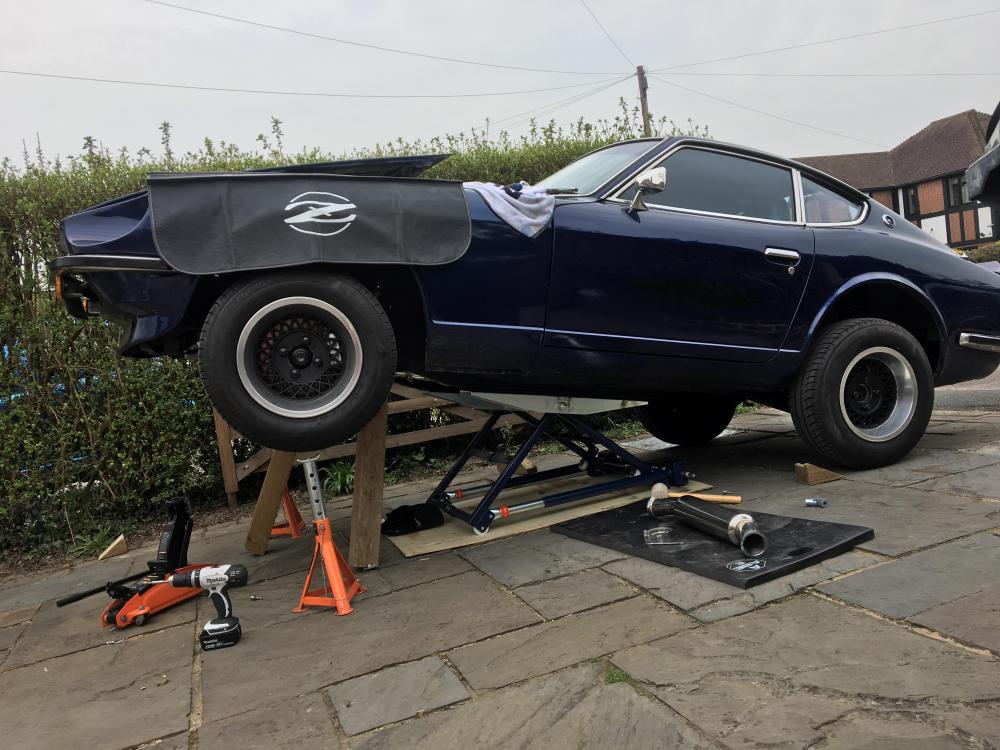

And then there is this ...
76ee1c895dec457393aef9e01a33fd54.jpg&key=4cb465bc140d7cc0b21117ec692c832db45d6024c613eed2cece5ad88a523f60
The lift was £450 and the best thing I’ve ever owned for working on the car! ;)
On removing the suspension thing, I found that doing it on my own, it was easiest undoing the bushes first, then taking off the strut nuts while you support the weight. But putting it back was easiest with putting the brackets / bushes on first then lifting the strut top into place. But if you can get someone else to help, then your world will be a nicer place! ;)
Can't really see it, do you have a separate link?  Looks like a giant scissors-type jack?  Blue?
$600 USD.
Edited by Zed Head
$600 USD.
It is a low rise scissor lift. Not too sure about using to only lift one end of the car though, all the ones I have ever seen are a pantograph type, and the platform rises and falls parallel to the shop floor.

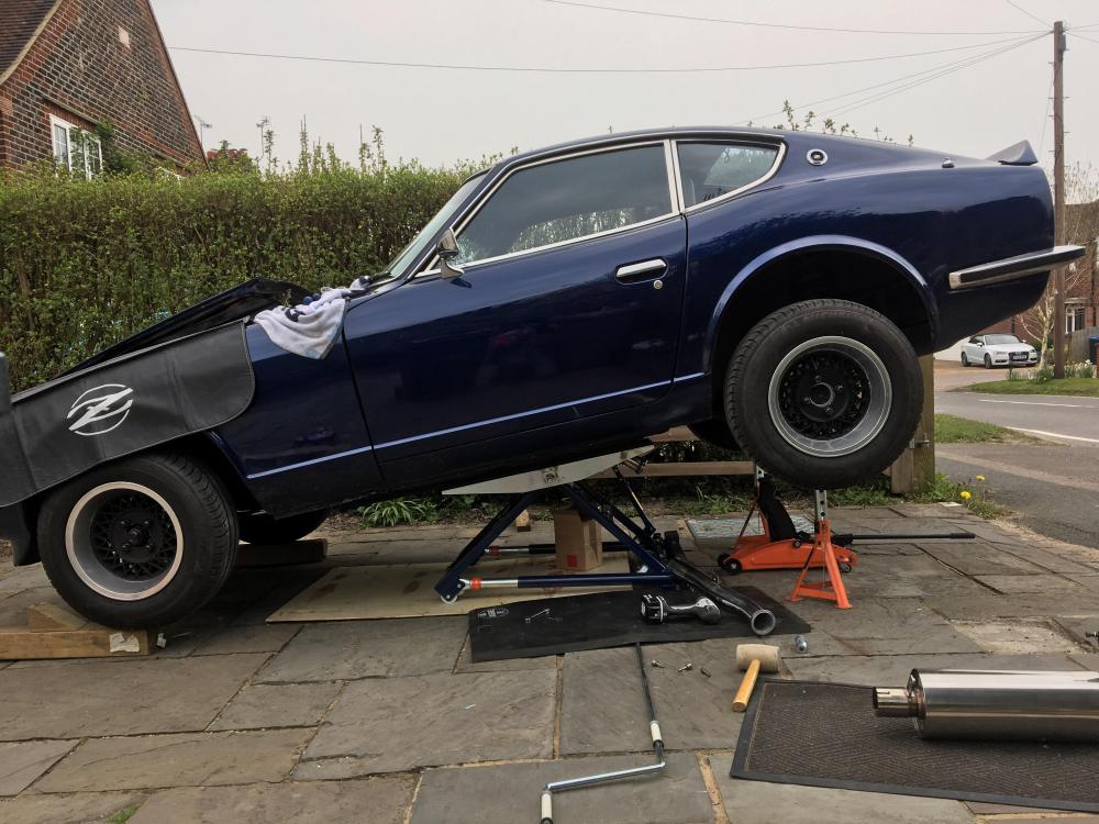

It’s a tilting scissor lift made by CJ Autos in the UK ...
https://cjautosheywood.co.uk/product/3in1-tilting-adjustable-car-lift-1-5-ton-cl01/
I haven’t needed to get it to max lift yet, but once at 75% and tilted, I can happily sit upright under the car and work.
97efd7920dac5846e7c3a50fbd5ef9fe.jpg&key=c91f69f583061e343644cb0f0f6bb26905f178584a11f56d20f95254a74100cf
The see-saw feature was particularly useful (and equally worrisome) when I was working on all the brakes and fitting the full exhaust system. The only thing it won’t be good for is a transmission removal.

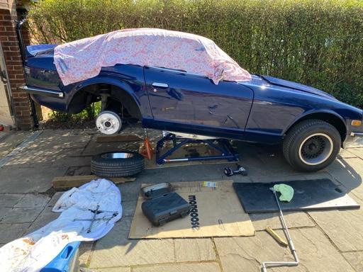

d5f345e5d7769dd8b13254368014f43f.jpg&key=86fca85f0930010dfce63d7379d58d10fbcc724a619e762034c74322a6a5910936d40b43140945ff44b6e943385d04dc.jpg&key=f0a0374bcde7da12063fd80edc2690e82cc73e21d14be2bd3beb77b13fc7dfa1
While I will never use it on anything other than the Z, if you keep two wheels on the ground, you can lift a car heavier than 1.5 tonnes.
