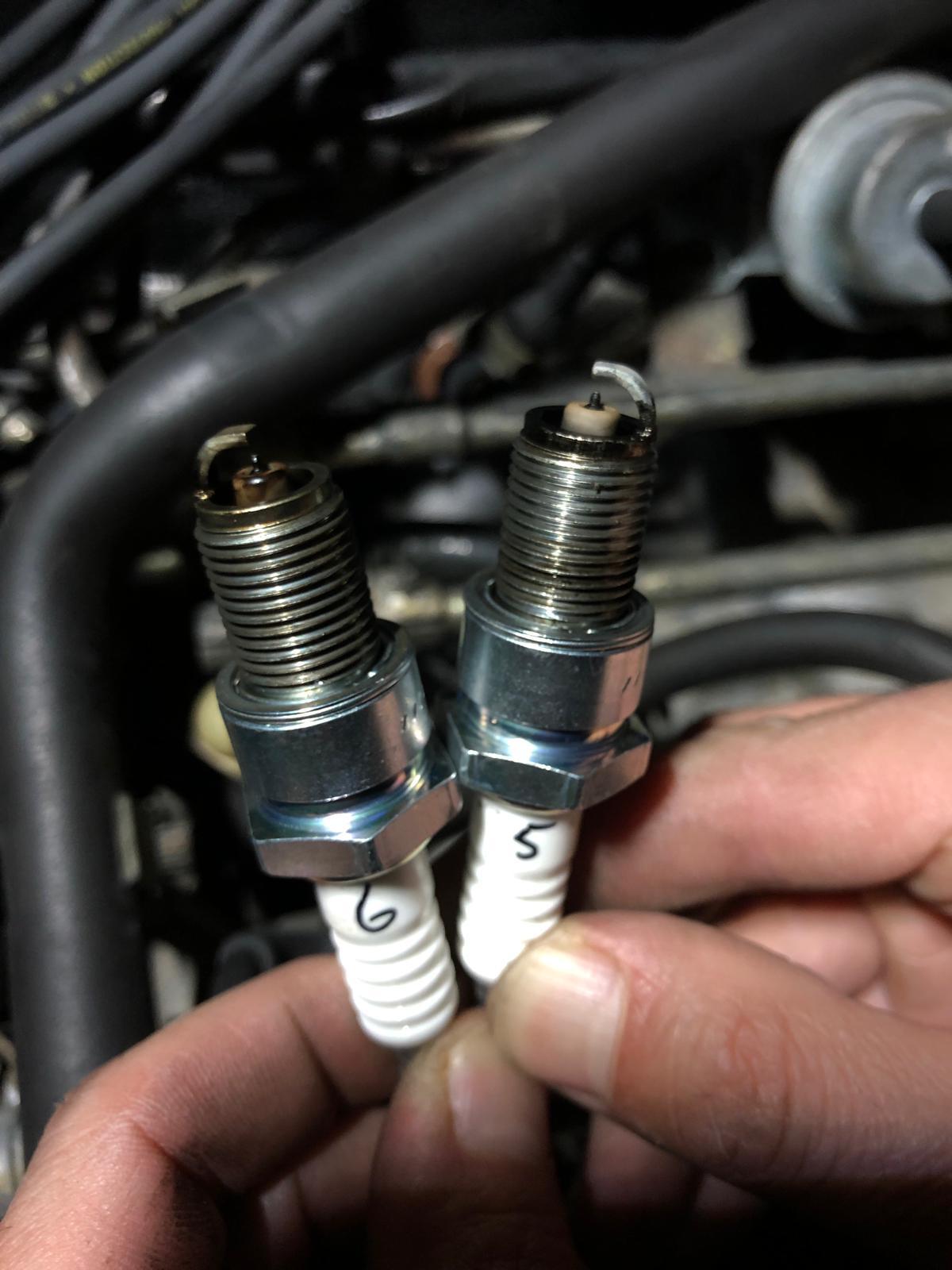

i do see an improvement in spark plugs when cap is elevated.  #6 still looks a little rich compared others.  the reaming plugs look a lot better than prev pics.
 see attached n let me know what you think PLS

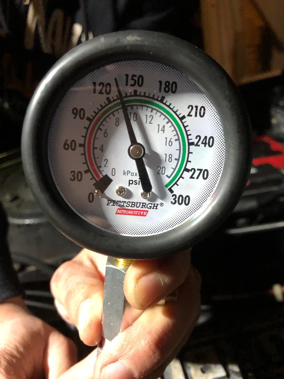

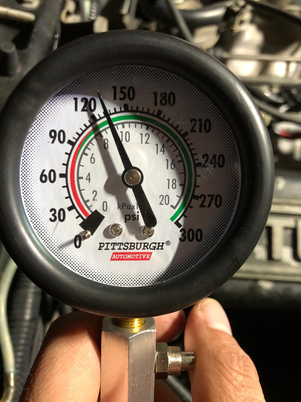

i also did a dry compression test.
#6 looks wet and like it has not been firing much.  The strap should be grayish-white like #5.  Does it smell like gasoline?
Something is not quite right.
i couldnt tell if i smelled gas.  given the exhaust smell in the garage and on my clothing my nose is shot
I can confirm the new injector is spraying.  so if the rest of spark plugs are looking better now, isnt that a good indication that the Dist Cap may be the issue?
i still dont know what would cause plug 6 to look like that if the wiring is good, compression is same across, and the injector is working, and the valves have been set to .008 & ..010 across the board
you didnt tell me, whats ur take on the compression being 125.  i heard it should be close to 150~180
Was the throttle wide open during the compression test? If not, that would account for the low numbers. If it was wide open, I'd adjust the valves and test again.

Hey Mark,
yes i made sure to push down all the way on the throttle, while my son cranked it over about 10 cycles   i noticed all pistons  it would get to that 125 range by 2nd cycle
Turbo engines have lower CR's.  And gauges vary.  It's the comparison of all six cylinders that really matters.
looking back at the pics, mine reported 130.  so i should im good there correct?
