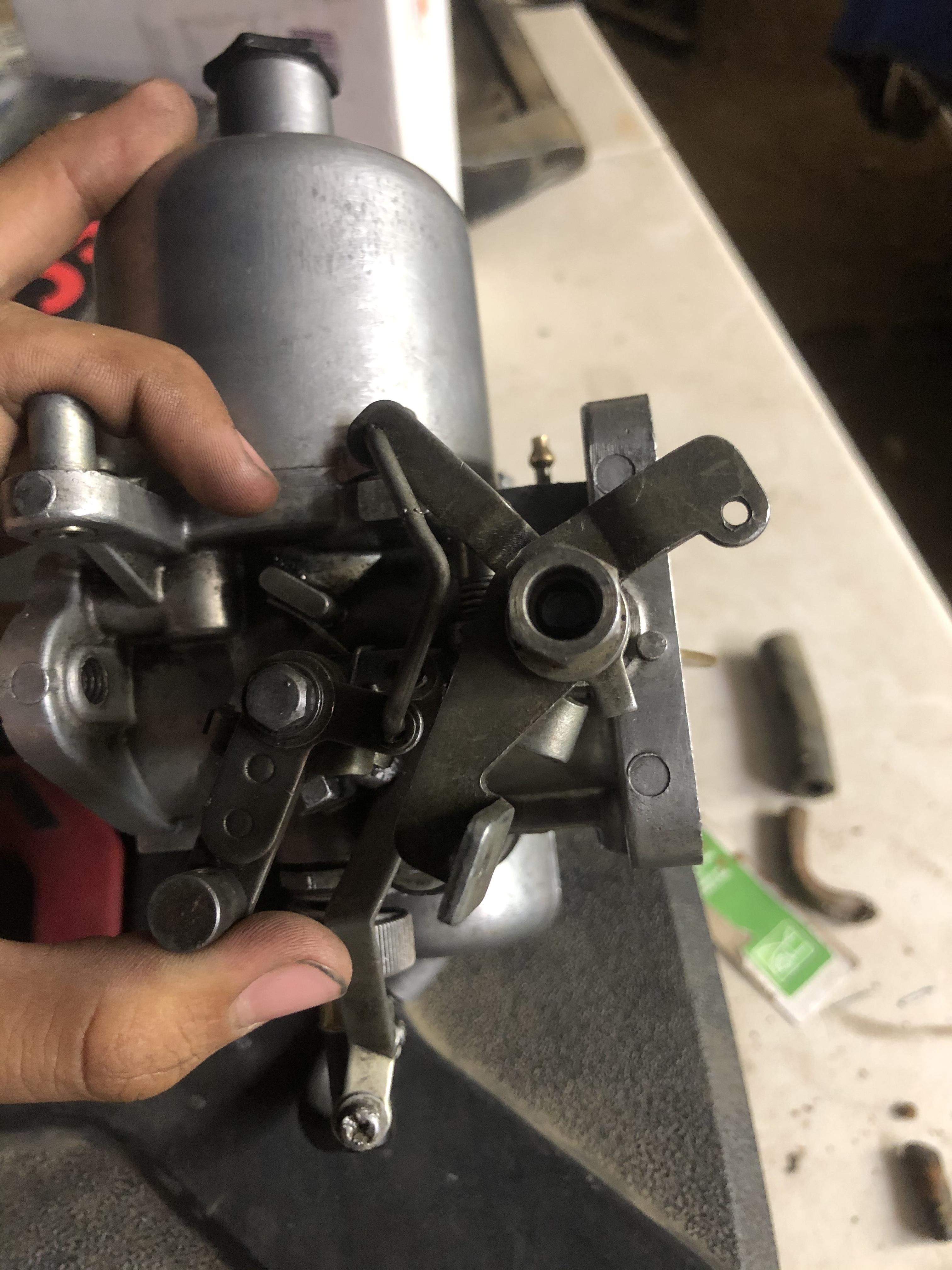

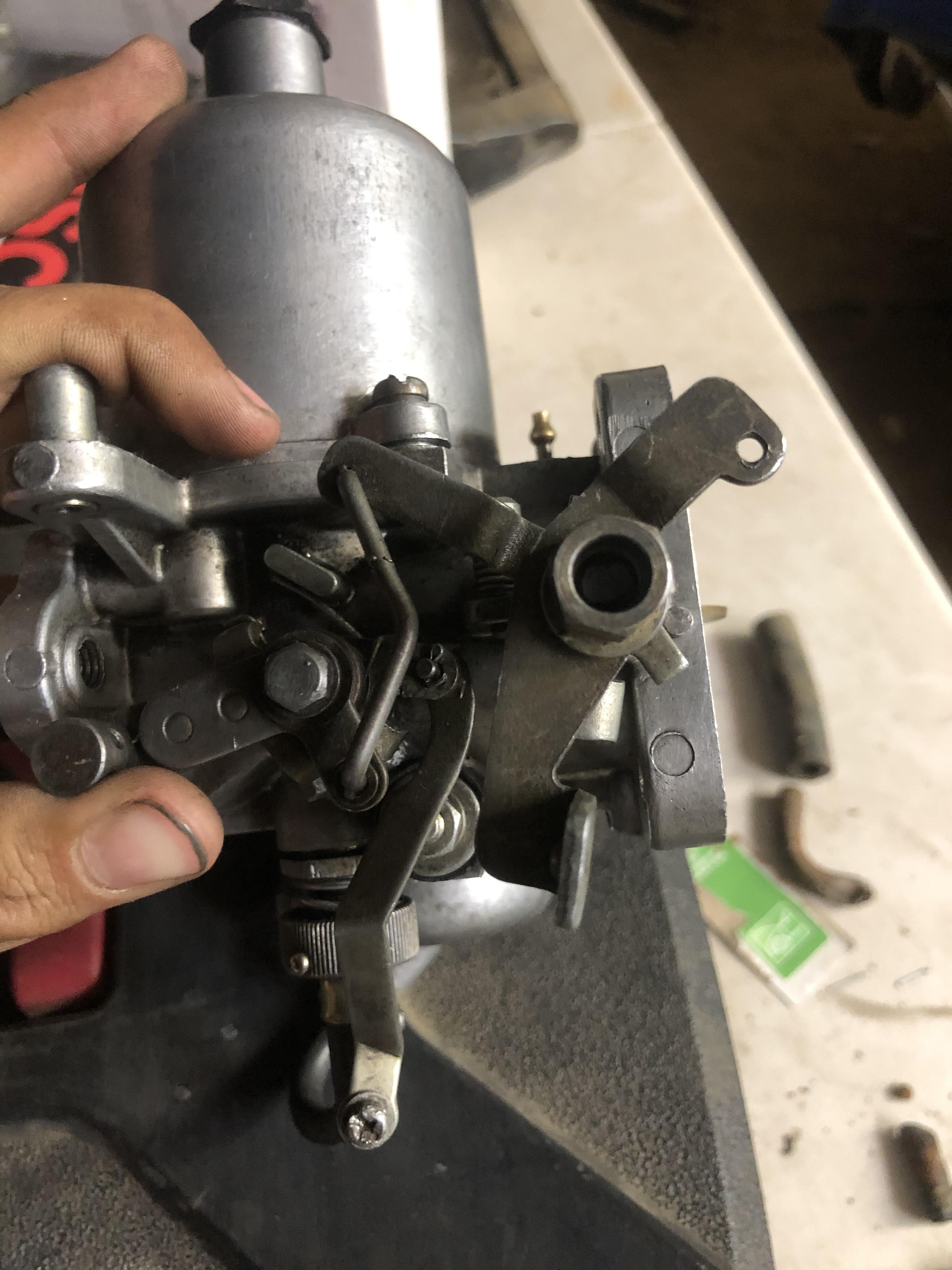

When I pull the choke lever, the throttle plate moves a little bit and it moves the linkage that goes to the nozzle but the nozzle doesn’t move. I can’t pull the nozzle out by hand either like I can with the other carb
It sounds like either someone put the linkage together wrong on that carb and it's binding up, or your nozzle is just stuck frozen in place.

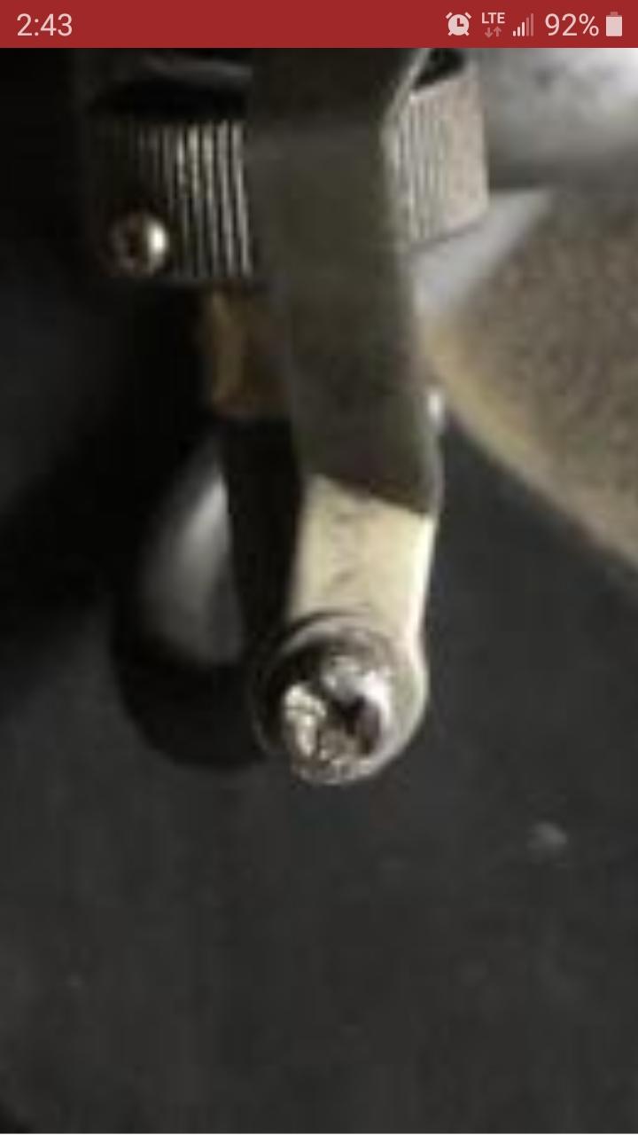

If you take out that little screw (the really chewed up one) out of the bottom of the nozzle and completely separate the nozzle from the linkage... Can you pull the nozzle out then, or is it still stuck?
The nozzle is still stuck after disconnecting the linkage.
Something els I noticed is that I can twist the nozzle and the thumb screw (adjuster?) and the hex closest to the carb body will all twist. On the carb with the nozzle that moves, only the nozzle will twist, the thumb screw and hex stay where they are.
If that makes any sense at all...
Yeah, there's something wrong with that whole nozzle assembly. With that little screw out, the nozzle should slip freely in and out inside the alignment nut. The get corroded and stuck sometimes, or maybe the whole thing is so badly misaligned that it's jammed up against the needle inside the carb. That bottom assembly should not spin. There's something wrong down there.
So what's the history of these carbs? It sounds like someone who really didn't know what they were doing had them in pieces and didn't do a good job of putting them back together. (Sorry if that was you.....)

I was able to get the nozzle free after taking it apart and playing with it for a bit. It was just gummed up and stuck.
Im still missing one of those bars that pops the butterfly open but I think I’ll still install the carbs and see how they work. I’m hoping starting and warming the engine won’t be too hard only missing a one piece of the choke system as long as I help it a bit with the pedal
