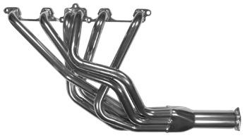

I already have the MSA 6-1 ceramic coated header with the 2.5" outlet.

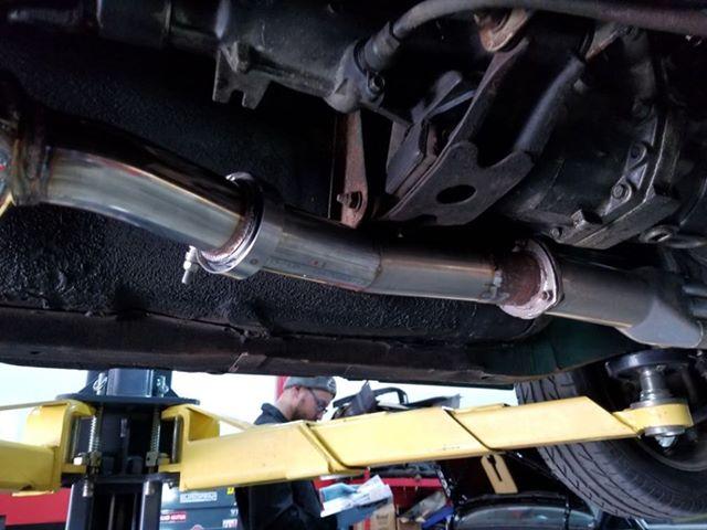

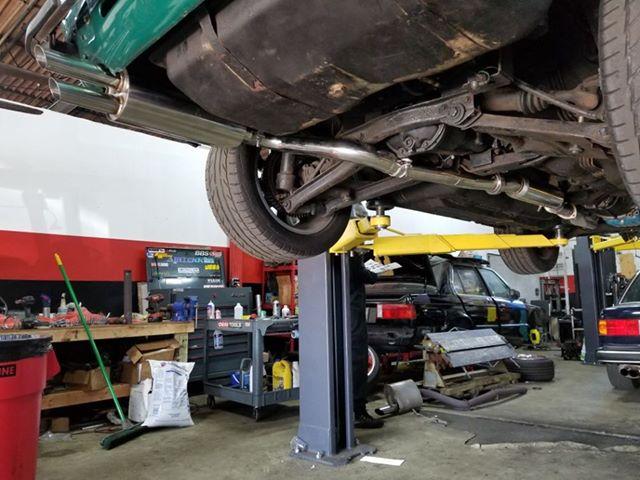

It's already been done by a client.

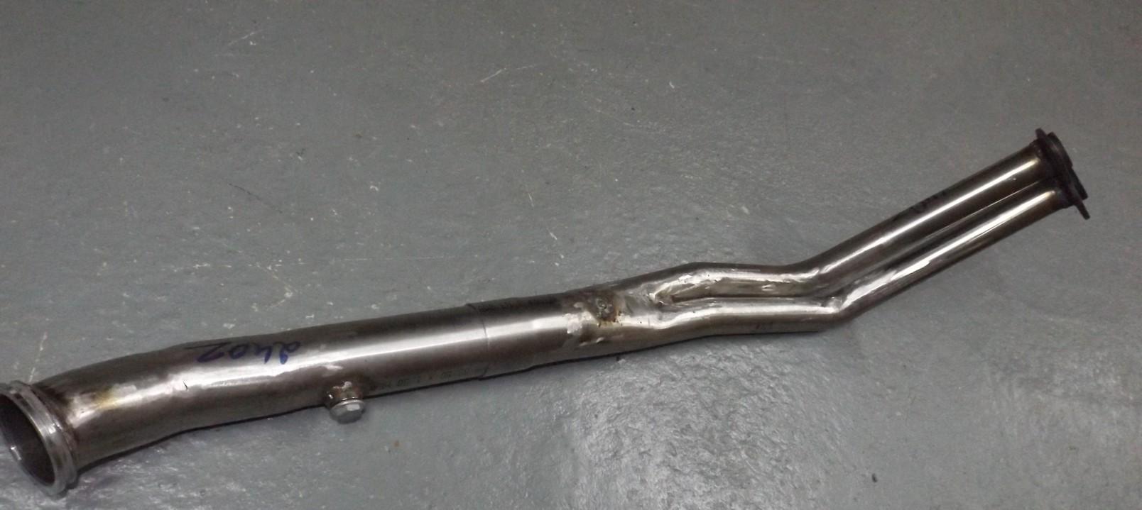

The only hurdle is to extend the 2-1 collector back to join with my line which begins with the reasonator at the rear of the gearbox. I would reccomend lengthening the twin pipes to finish as far back as possible and I will supply you, free, with an extra V-band kit so as to make a gas-tight fit or it might be possible to use one half of my new down-pipe kit (which'll be available in late March).

Thanks......and as stated, this has already been done : MSA 6-1 headers plus my line and rear muffler.😏
