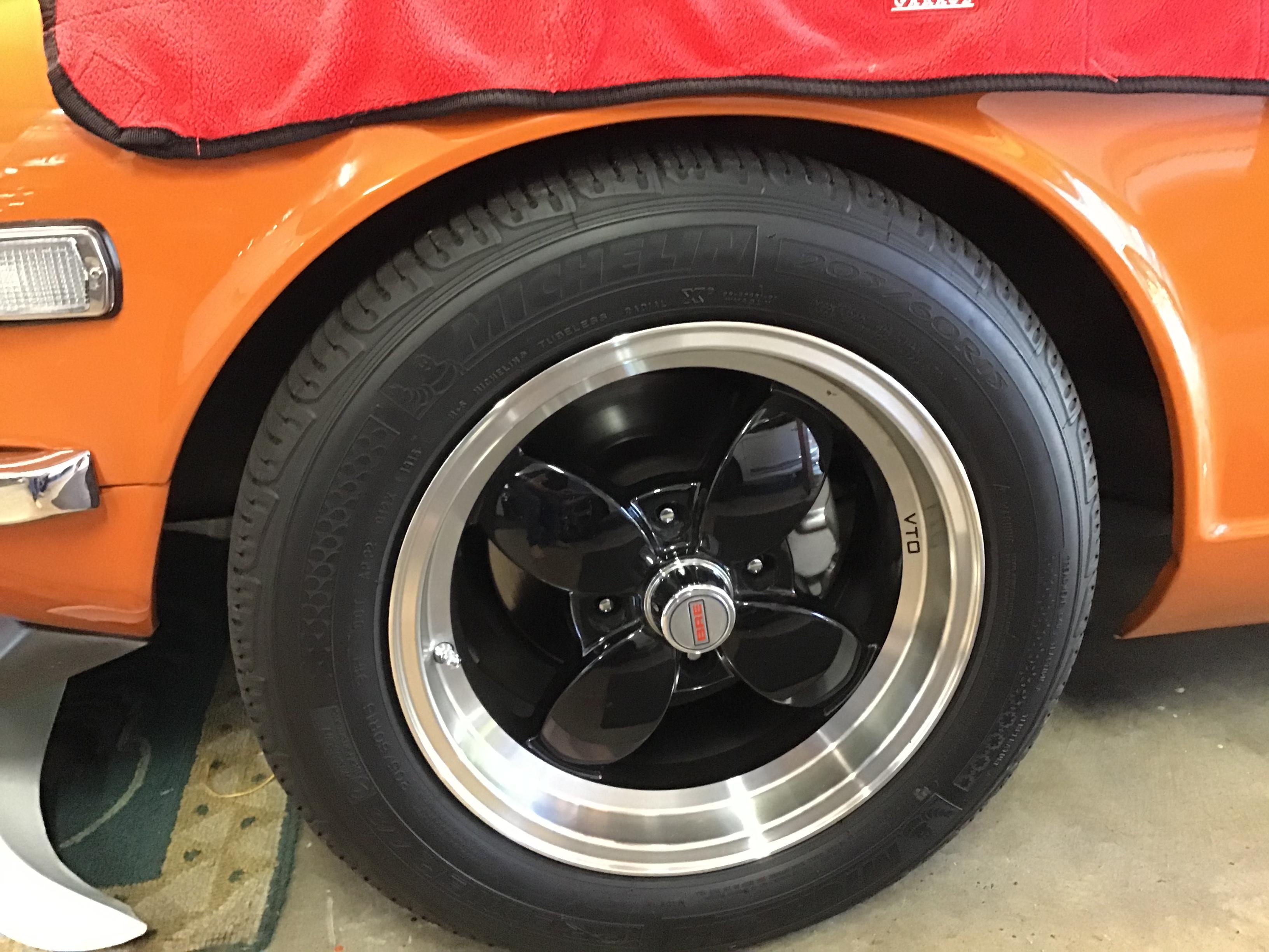

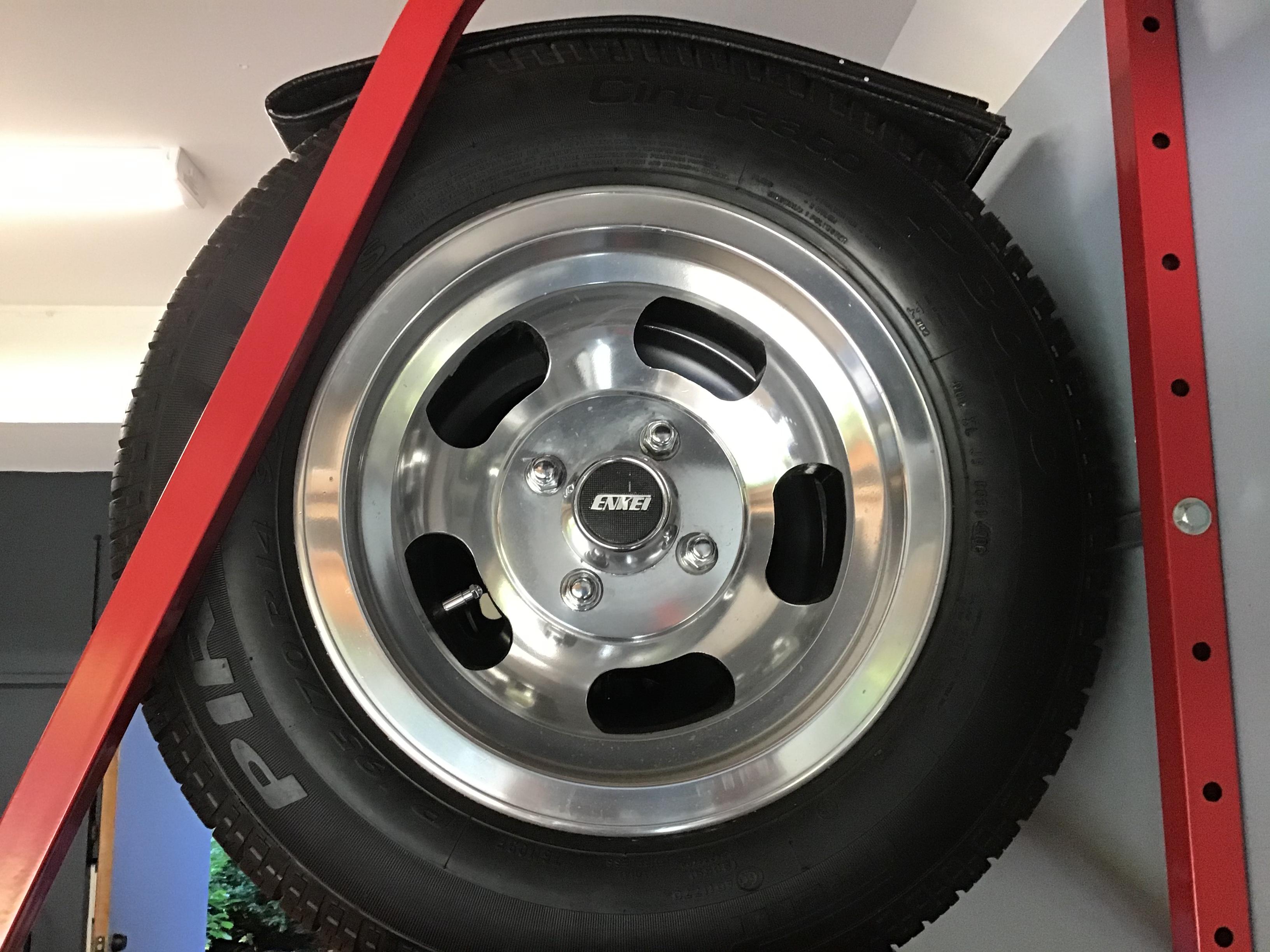

I ran 195/70x14 Pirelli tire for many years on 14X7 slotted wheel without issues on My lowered 71. Speedo was pretty accurate back then. Now we know with GPS that they probably weren’t.  Do not know the offset of  those wheels that were a dealer installed item. Currently I am running 205/60x15 on 15x7 VTO on the same setup. MPH on slightly high at the speedo. also an Close ratio 5 spd and 3.90 LSD
Which takes me back to what @zedhead said go with what looks good to you. B61A51F1-3B70-42EC-8992-14F4DA364FE1.jpegF910B850-6975-4867-9C63-953B1DAD3FF6.jpeg
