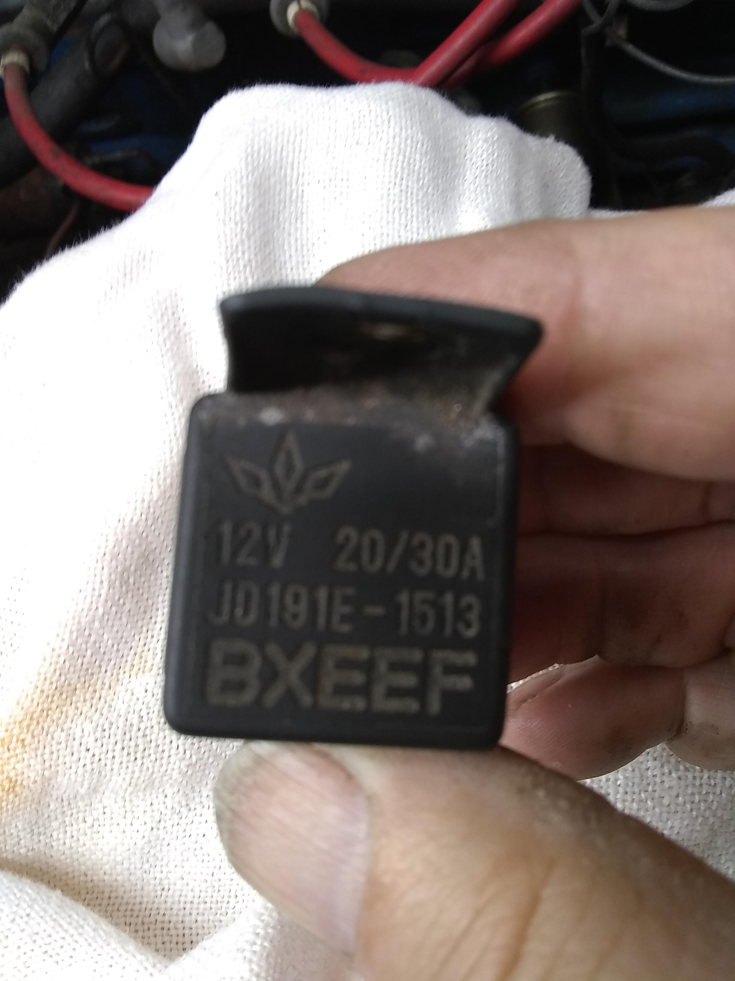

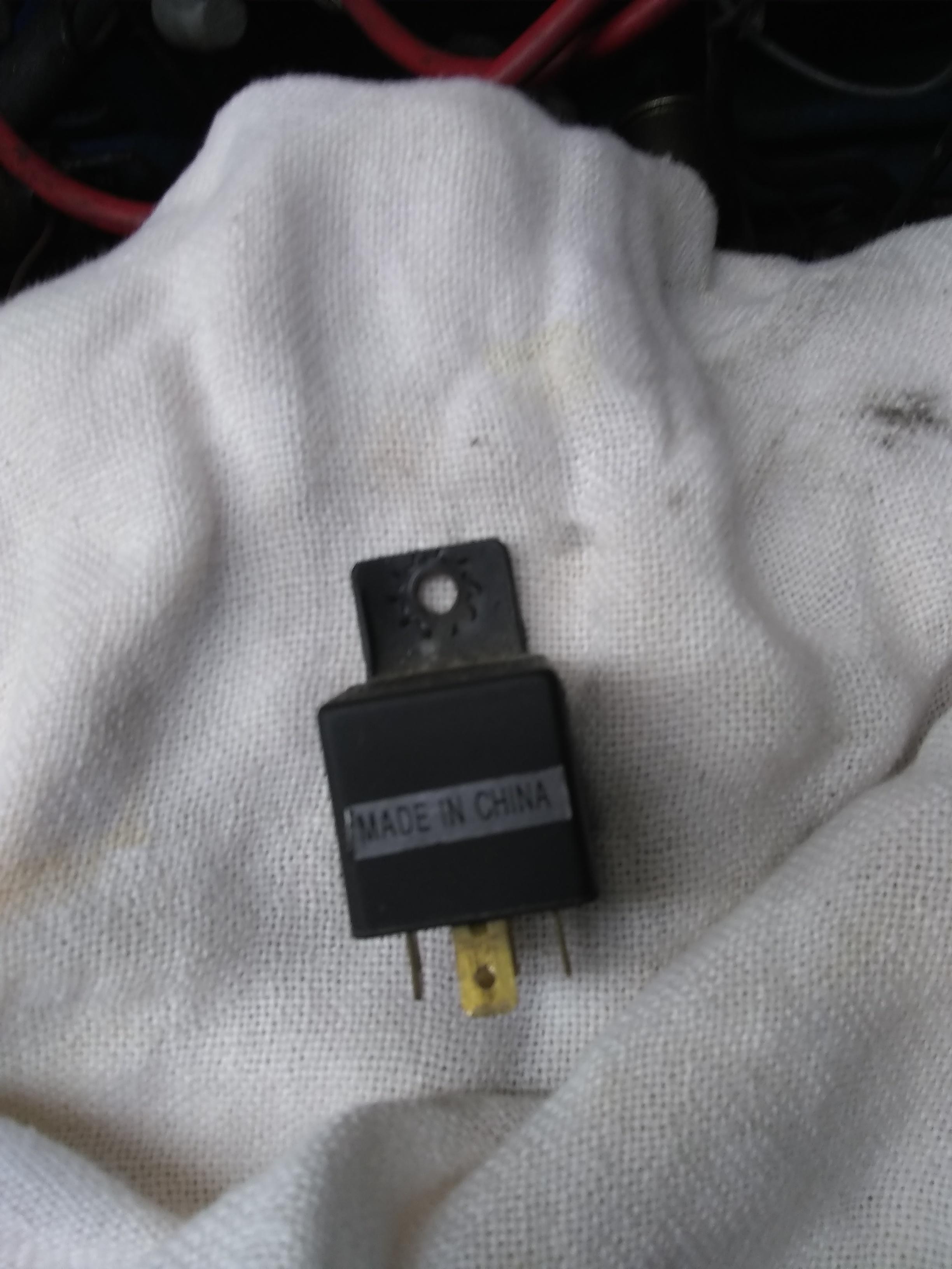

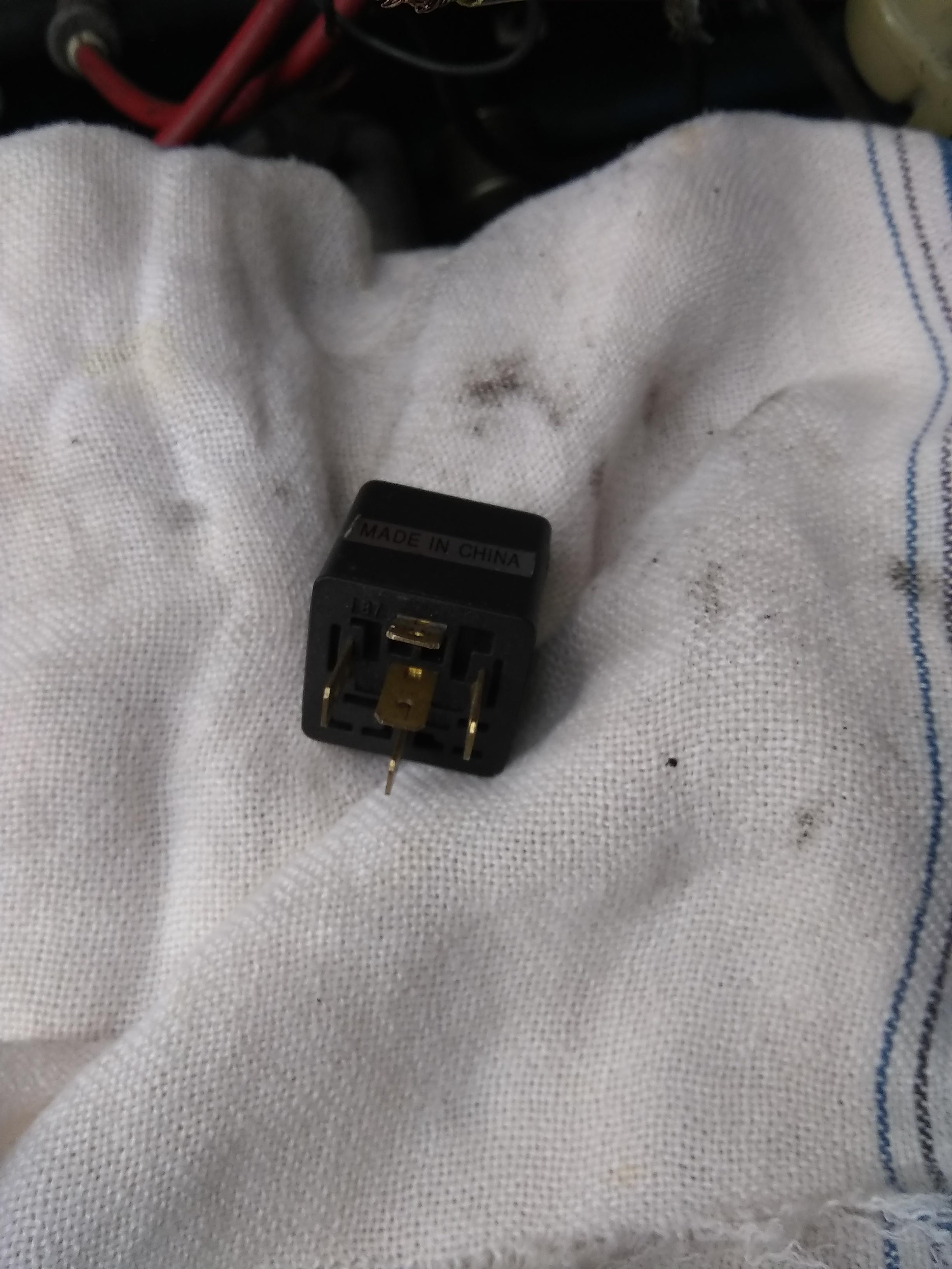

Could you post a picture of that relay?  A PO must have installed it for a reason.  Might be that they were trying to fix the problem you're having now.
Are you sure the car did not start life as an automatic?
I made sure the lights, turn signal, etc. work with key on/off as these all should.
For sure the relay is aftermarket "Made in China".
It had 4 wires, 1 yellow 18 gauge, 2 red 10/12 gauge one to battery connection on starter and one to the solenoid, 1 ground.  1 Empty pin. 1 Ground.

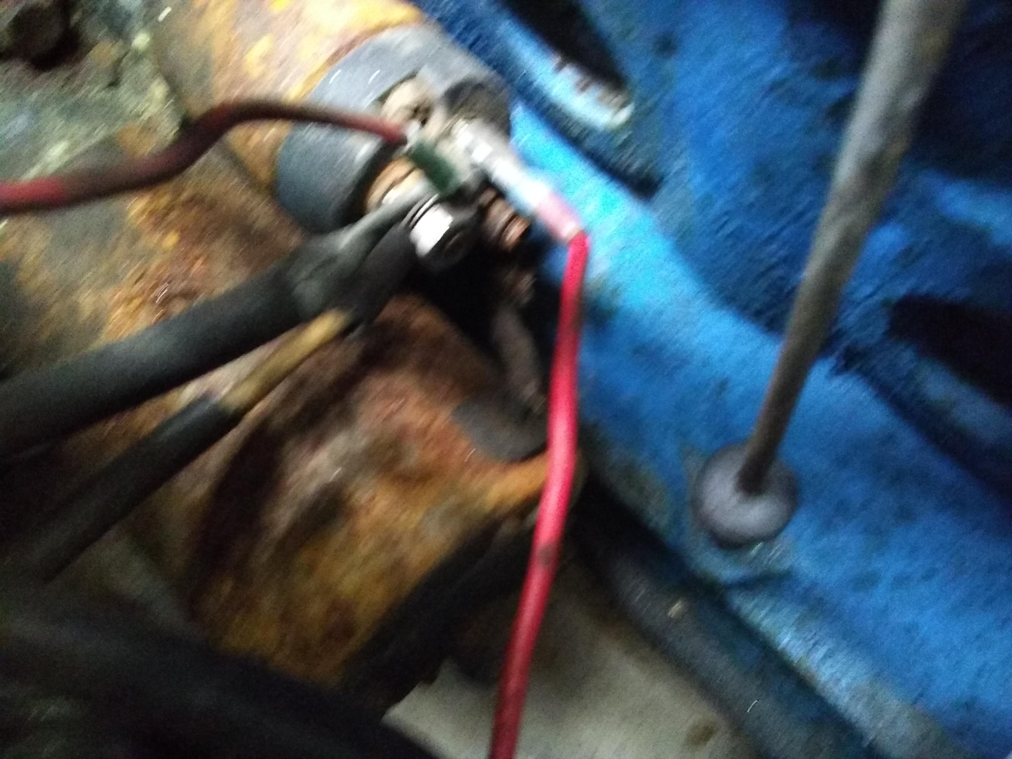

Wiring harness that runs along the side of the engine goes to a plug (pic #1) then close to the plug the oil sensor wire comes out of the wrap, up about 6" the yellow 18 gauge wire comes out.

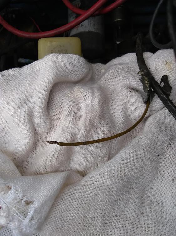

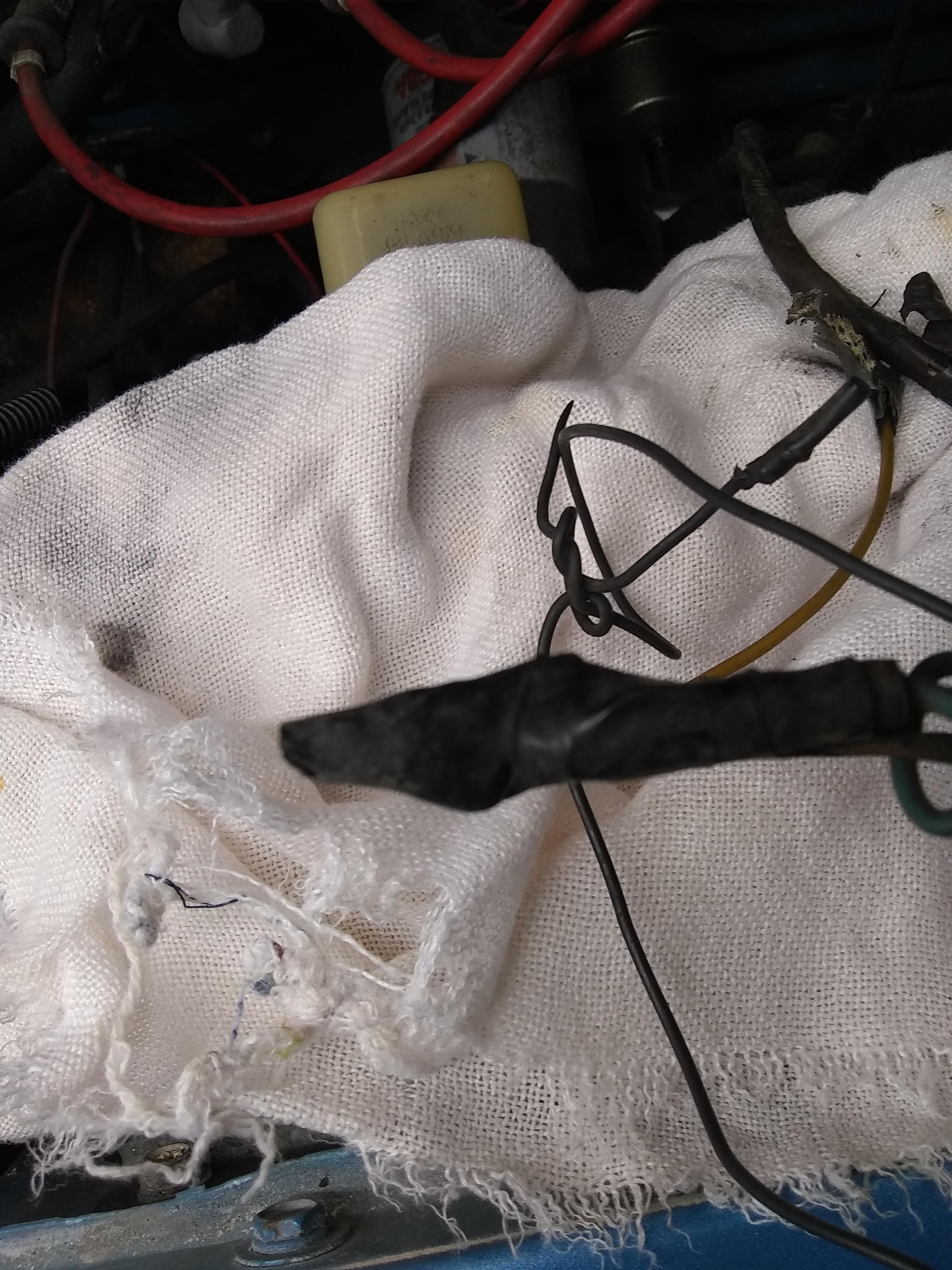

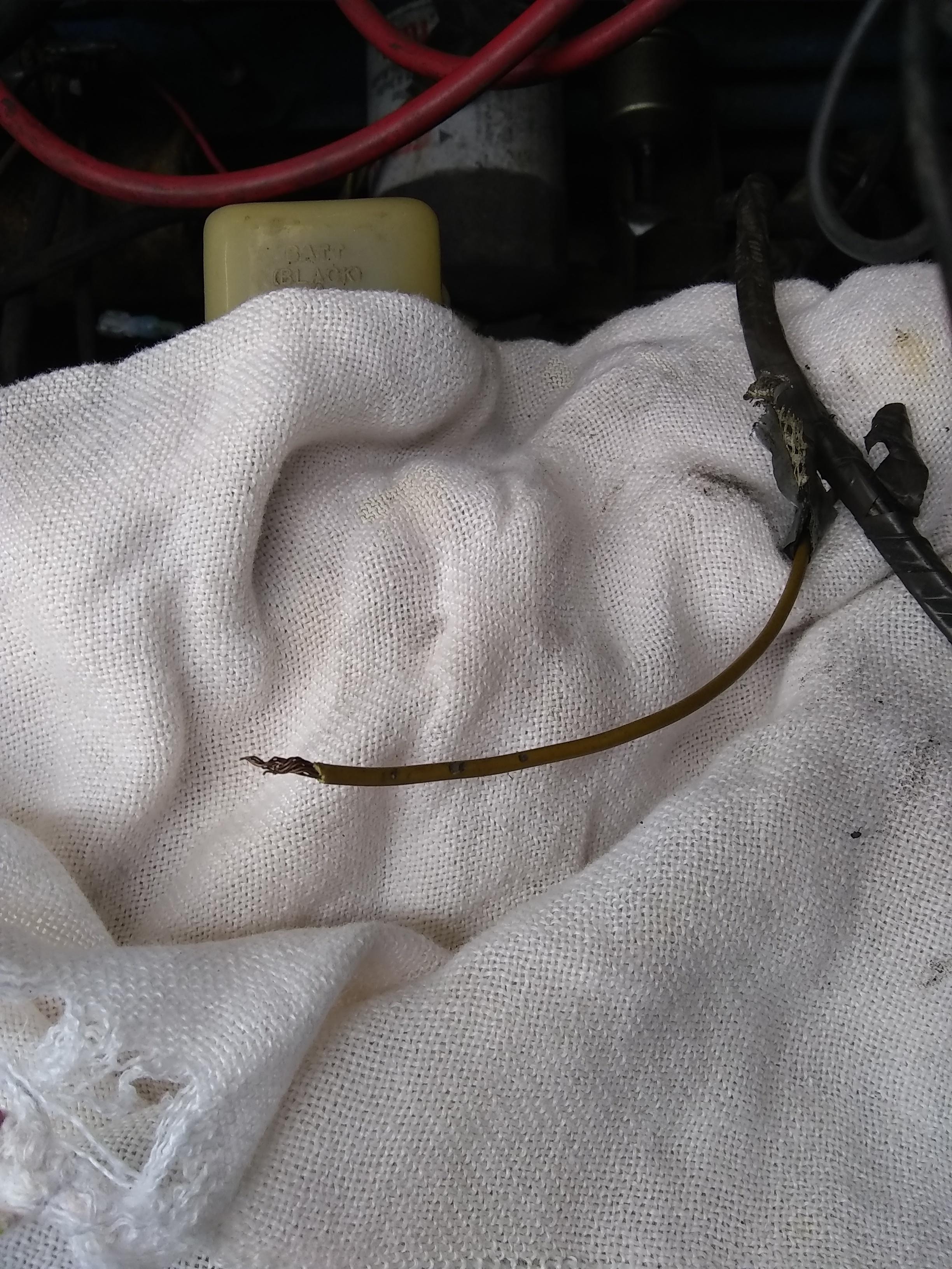

To save a bunch of writing is the Yellow wire that the end fell off the original solenoid wire (#2)?   It is about 18 gauge yellow colored.  IF so I can fix this part of the mess.
That ball of tape in #3 I think was a plug that was cut off for the MSD ignition.
See if it gets 12 volts when you turn the key to Start.
The early 280Z's have yellow wires that go to the brake check warning lamp and other places.  Do you see a voltage regulator?  Might be that somebody wired in an internally regulated alternator.
Looks like you're at the start of finally learning what a PO did to your wiring.  Condolences for the pain that's in front of you now.  If you have an MSD ignition it might be that your original electronic ignition module has been bypassed.  And, maybe, the PO decided to wire in a relay for the coil also.  It's looking like somebody just hacked in the wires needed to make it run.
