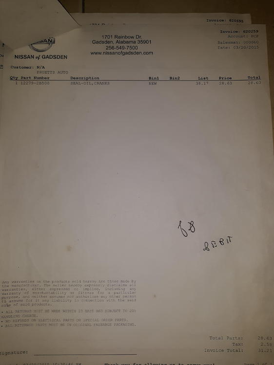

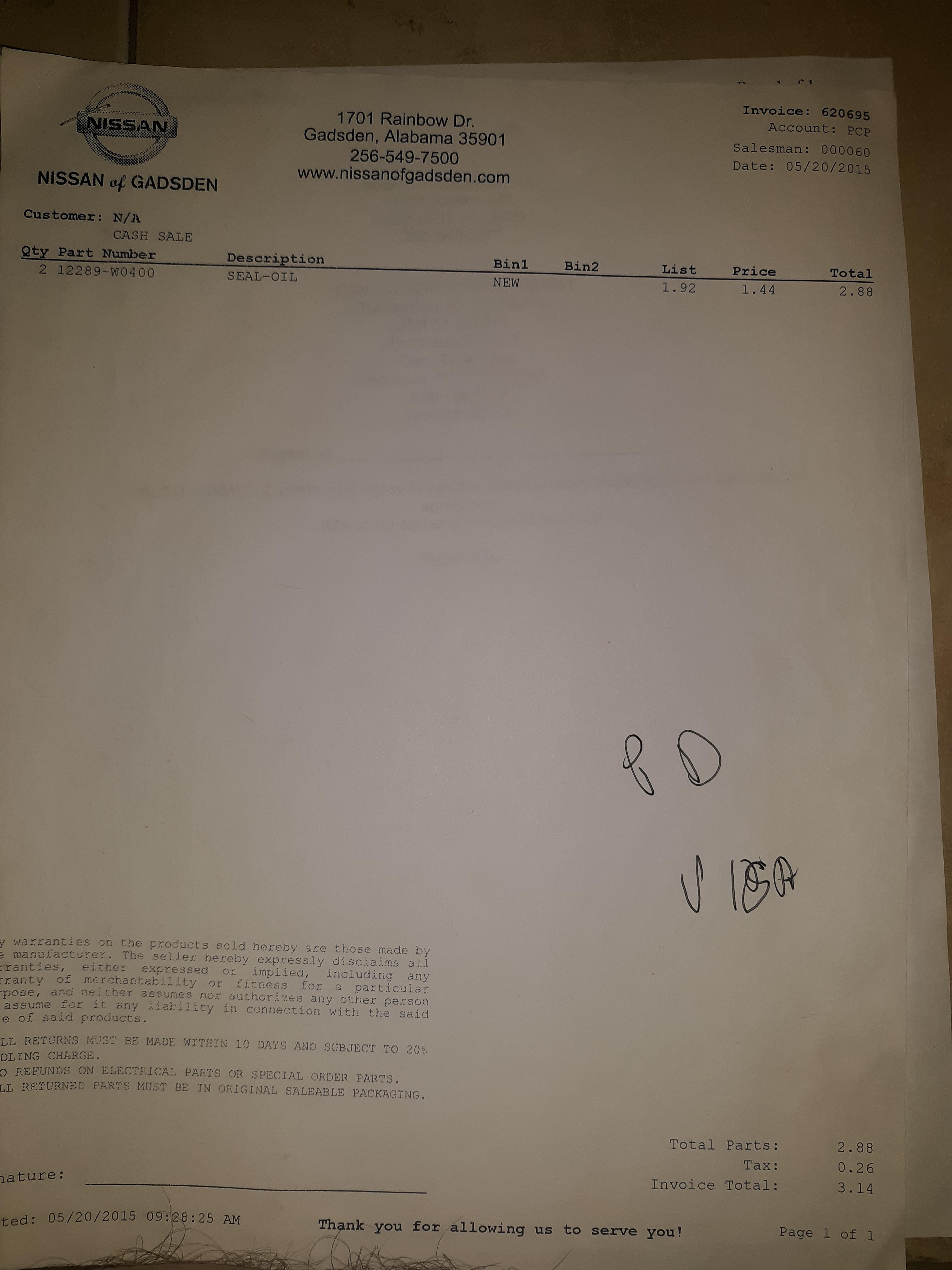

I used Nissan. Get the part number and your local dealership can get one overnight usually. Mine did.
Or buy online from Courtesy Nissan.
Oh yeah, you'll need the 2 side seals also. Again, Nissan has those as well.
