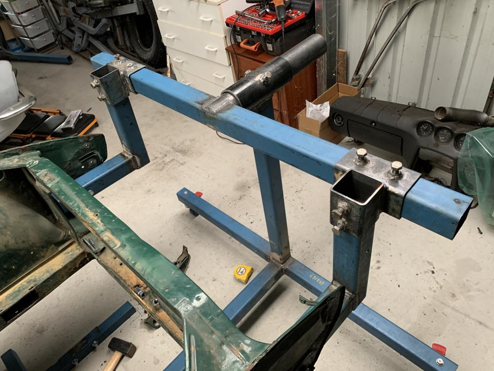

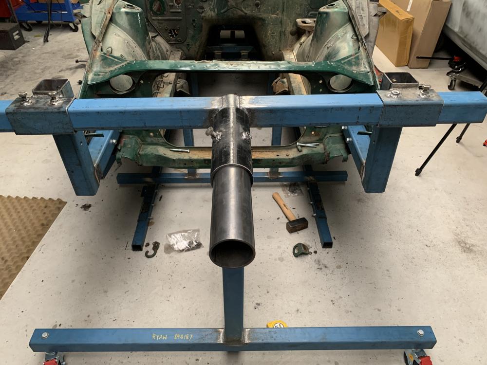

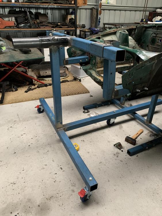

May 4, 20214 yr Author comment_621044 I decided to plough on with the rotisserie build as I won’t be attempting repair on my front end until I have the car blasted and up to replacing frame rails/removing radiator support.  Progress is coming along nicely. I realized that if I flipped my mounts and drilled new holes I wouldn’t have to cut and reweld. So now the mounts clear the nose. I love humanities proneness to be lazy. notched pipe and mocked up horizontal joiner piece. welded up brackets and jam nuts. My welding is slowly getting better, soon I’ll be able boast about stacking dimes 😂 mocked up front base, notched upright for the pipe to fit into snuggly. Next on the list: - tack everything together and add extra supports to the base -install castors - do a mock install from jig to rotisserie, My goal is to be able to transfer the shell between jig and rotisserie with minimal fuss and effort -all going well, weld up front frame and base and move onto  the rear. Link to comment https://www.classiczcars.com/forums/topic/64416-240zbuiltbyme-1971-240z-hs-001063-project-georgia/?&page=14#findComment-621044 Share on other sites More sharing options...
May 4, 20214 yr comment_621049 It's just as well your front supports extend upward. The balance point for the car is on that side of the bolt holes if I remember correctly Link to comment https://www.classiczcars.com/forums/topic/64416-240zbuiltbyme-1971-240z-hs-001063-project-georgia/?&page=14#findComment-621049 Share on other sites More sharing options...
May 4, 20214 yr Author comment_621061 1 hour ago, Patcon said: It's just as well your front supports extend upward. The balance point for the car is on that side of the bolt holes if I remember correctly I’m basing my design loosely off Kent’s @ConVerTT and trying to go on what he said in his thread which is front mount is 3 inches below the axis of rotation and rear is 5 inches below. though not exactly sure where he took that measurement from Link to comment https://www.classiczcars.com/forums/topic/64416-240zbuiltbyme-1971-240z-hs-001063-project-georgia/?&page=14#findComment-621061 Share on other sites More sharing options...
May 18, 20214 yr Author comment_621743 Nearly knocked off the front section of the rotisserie this week, so close! I keep stressing that my progress is too slow. But I try to remind my self it’s one tiny task at a time, every little job complete is one little job less on the list. The old how do you eat an elephant thing.... Base and pivot point welded up and complete, castors installed. Next on the list: -weld in supports on the base and pivot - due to the damage to the bumper mount section on my car I have decided to add additional tie in points, I will be using the front tow points, however the bolts had snapped on all the points so I will need to tackle that before hand - move onto the rear of the rotisserie ryan   Edited May 18, 20214 yr by 240ZBUILTBYME Link to comment https://www.classiczcars.com/forums/topic/64416-240zbuiltbyme-1971-240z-hs-001063-project-georgia/?&page=14#findComment-621743 Share on other sites More sharing options...
