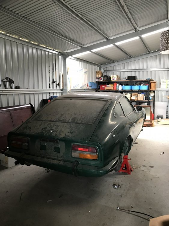

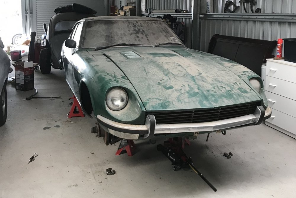

Here are some photos just before I started stripping it
