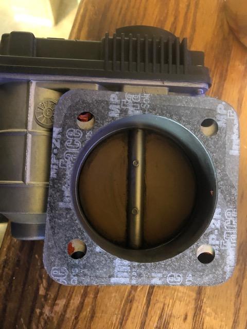

Second, the ETB 350Z came today and it is in really good shape. But...
Nothing can be easy with this project so I'll have to fabricate a spacer to put this on the L6 manifold. Oh well... I understand the matching pedal will mount to a vertical firewall so there is that!
LOL! So the mounting pattern is not the same. Bummer. I was trying to dig into that for you, but didn't come up with anything concrete in time.
So is there enough meat to file the holes on the TB so you can get it to mount? Or is it just too far off?

Looks like there is enough to work. I will run it by Rex, a 510 guy and machine shop manager Monday. It looks like it’s aftermarket because all the 350Z ETB’s I’ve seen have “Hitachi Nissan” cast into them. This one, nothing. We can try to make it fit and if we break it, we chuck it!
Ok, even though I'm retired with the Covid situation, my anesthesia skills are in demand so I do a day or two a week of work at the hospital. The reason that is relevant is that I have not had time to examine the 350Z throttle body to see if I can just redrill it or if I need an adapter plate to make it work. My conclusion? I think I need an adapter plate. And frankly, as long as I have to make an adapter plate, I think I'll just make one that accepts the aftermarket 350Z 75mm ETB's that are out there.
I just don't think there is enough meat in the stock 350Z ETB to drill it out for the bolt pattern on our L28 intakes.

Gotcha. Of course it's impossible for me to tell from just the pics, but from my end of the screen it doesn't look like there's enough meat.
