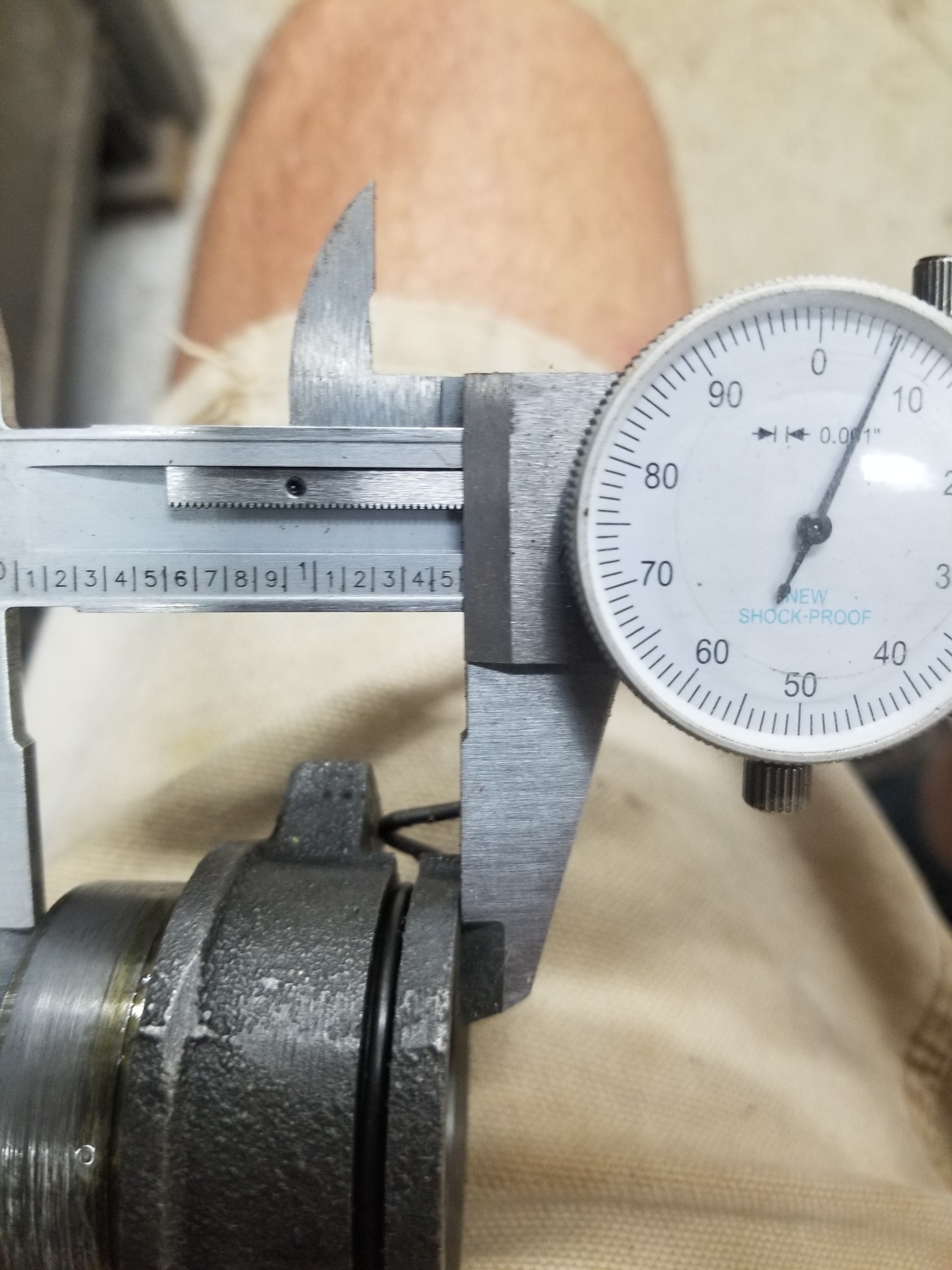

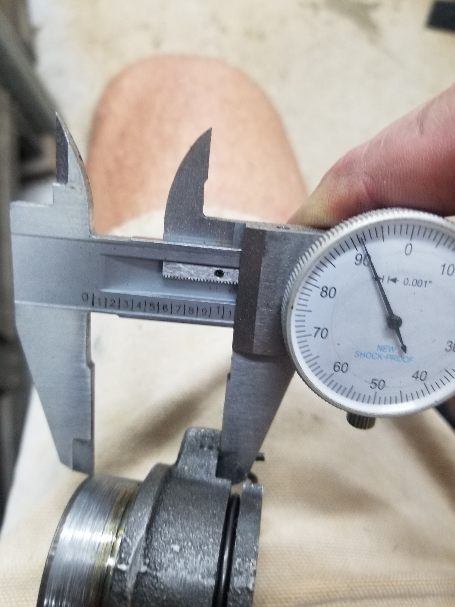

August 12, 20231 yr comment_655877 Current collar: 1.506" ( 38.25 mm) OA height 1.091" ( 27.7 mm) from the top to the milled flat So smaller than all 4 in post #130 If I went to the ZX collar I would theoretically gain 15mm. Making my stack up about 92mm. Does anybody have one? @Terrapin Z? Link to comment https://www.classiczcars.com/forums/topic/64212-clutch-fork-throw/?&page=14#findComment-655877 Share on other sites More sharing options...

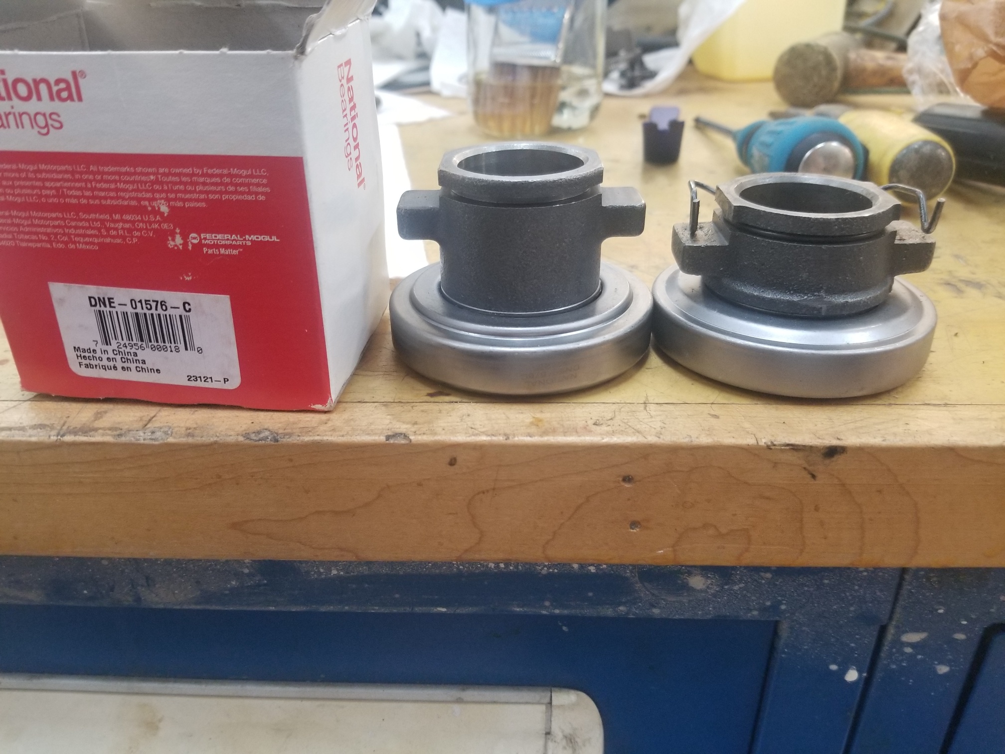

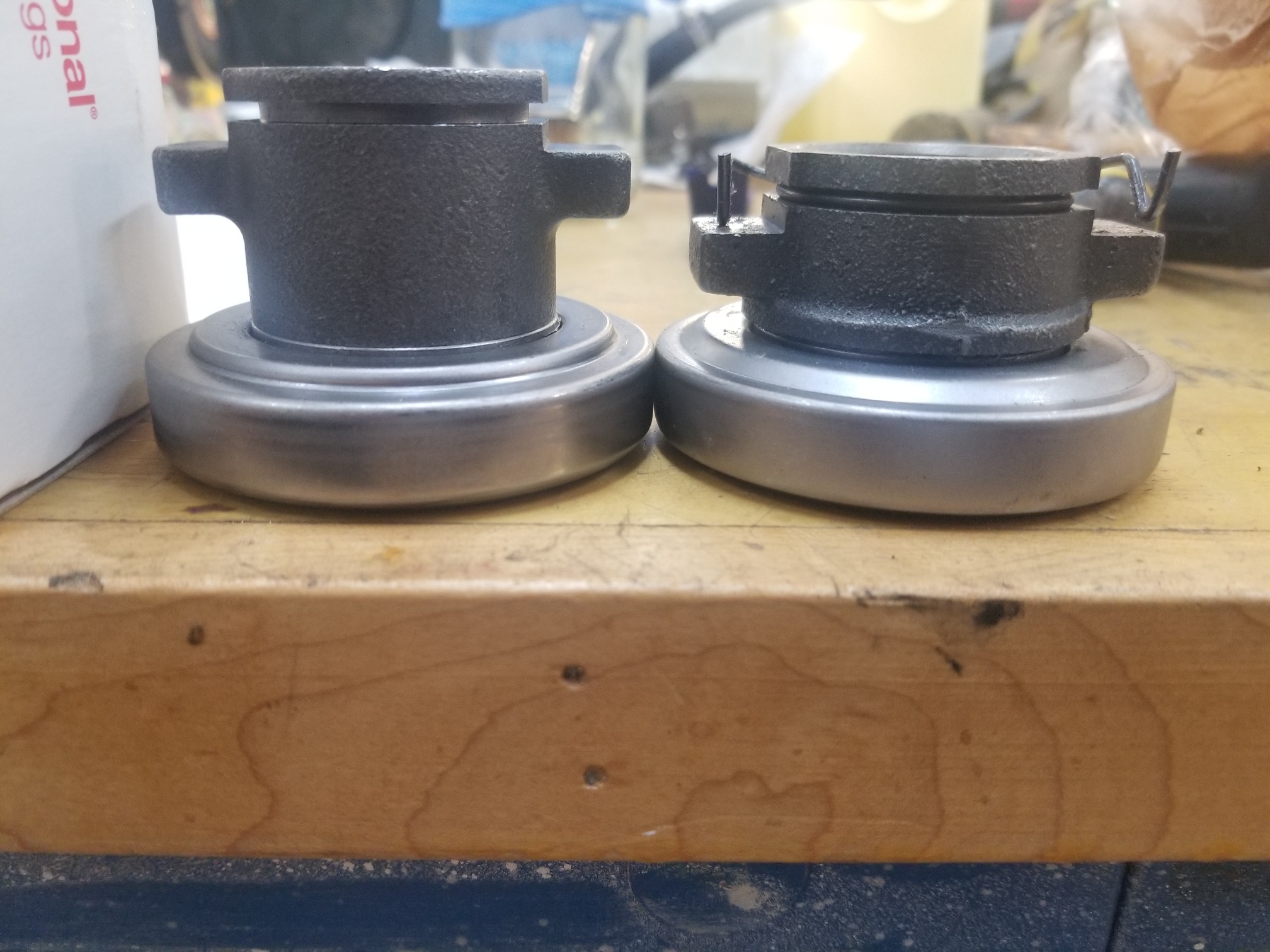

August 19, 20231 yr comment_656101 So I received the new collar yesterday I ordered a different one but it was out of stock. I selected another product and Rockauto shipped it for the same price as the cheaper one. Which I thought was cool! It looks to be about 10mm taller. I might go over to Cody's tomorrow and check out the total stack height Link to comment https://www.classiczcars.com/forums/topic/64212-clutch-fork-throw/?&page=14#findComment-656101 Share on other sites More sharing options...

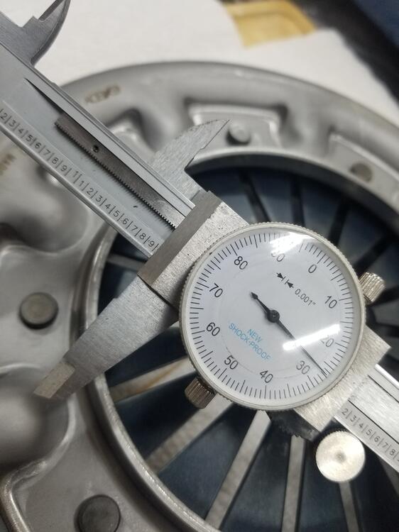

August 21, 20231 yr comment_656178 So measured the Exedy pressure plate The Luk pressure plate was 44.3 mm The Exedy 06030 is 1.927" or 48.95 mm With the new collar and bearing it's 92.4 mm to the ears Link to comment https://www.classiczcars.com/forums/topic/64212-clutch-fork-throw/?&page=14#findComment-656178 Share on other sites More sharing options...
