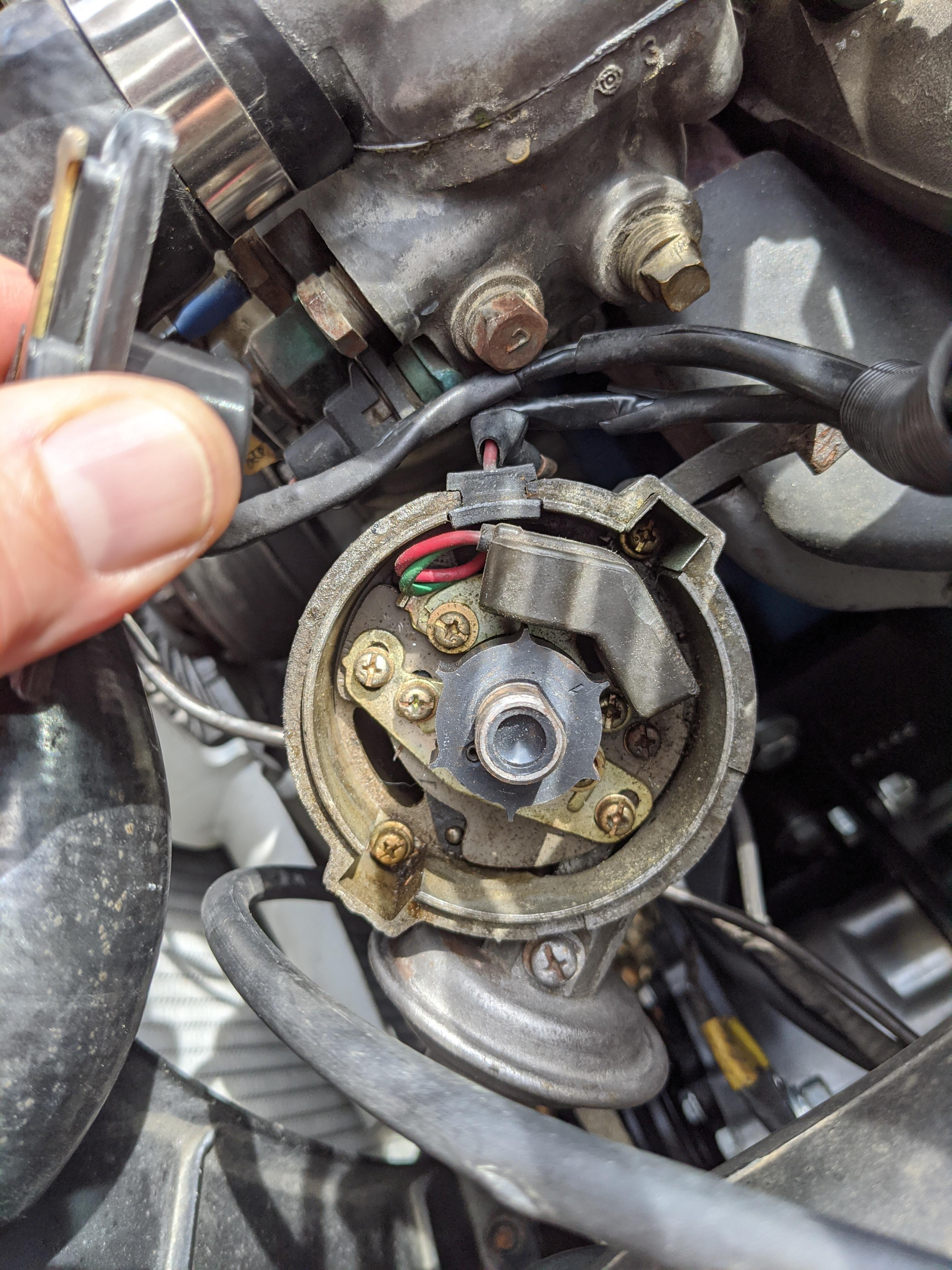

The points were replaced with electronic ignition. Pertronix ?
The coil is an Accel Super Stock.
Spark plugs and wires appear new and in good condition.
Here is a photo album of the car, with pics of the engine bay and close ups of the distributor and coil.

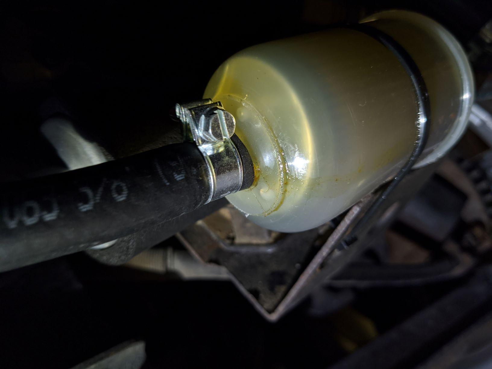

I've had crud inside my fuel tank that would let them run intermittently like that, it's a real pisser. Put a clear filter coming out of the tank and see what you have.
Good write up here, http://www.atlanticz.ca/zclub/techtips/fuel/g3filter/index.htm
A very good suggestion. See attached photos.
There is crud in the filter and it also appears to be leaking fuel.
The previous owner said the person who redid the car coated the inside of the tank, and suspects that coating is a weak point in the fuel system.
Maybe replacing the tank is the way to go. What do you think?
And how would I know if the crud made its way to the injectors?
Thanks
They used to cost about $10 so for maybe $15 I'd buy a new metal filter that goes up front before the fuel rail, passenger's side fender. Hacksaw it in half and see what you find. I very much doubt any crud would get past that filter and make it to your injectors.
The tank liner I used was Red-Kote and you would see red slivers in that rear clear filter. That looks more like trash to me? Anyhow it shouldn't leak if you have it right out of the tank, before the high pressure fuel pump. You wouldn't want that after the fuel pump's 35-ish psi output in my opinion.

In case anyone missed it.  It has a Pertronix under the cap, apparently.
Another sign of ignition problems is the tachometer needle behavior.  Watch the tach needle when the problem happens and see if it's following engine RPM or if it's acting crazy.  If the engine dies and you're in gear the needle should still follow RPM as you coast down in gear.  If it does you have spark, but no fuel.

Is this a stock transistor distributor or Pertronix? I'm new to this car and may have provided some incorrect info about the dizzy
