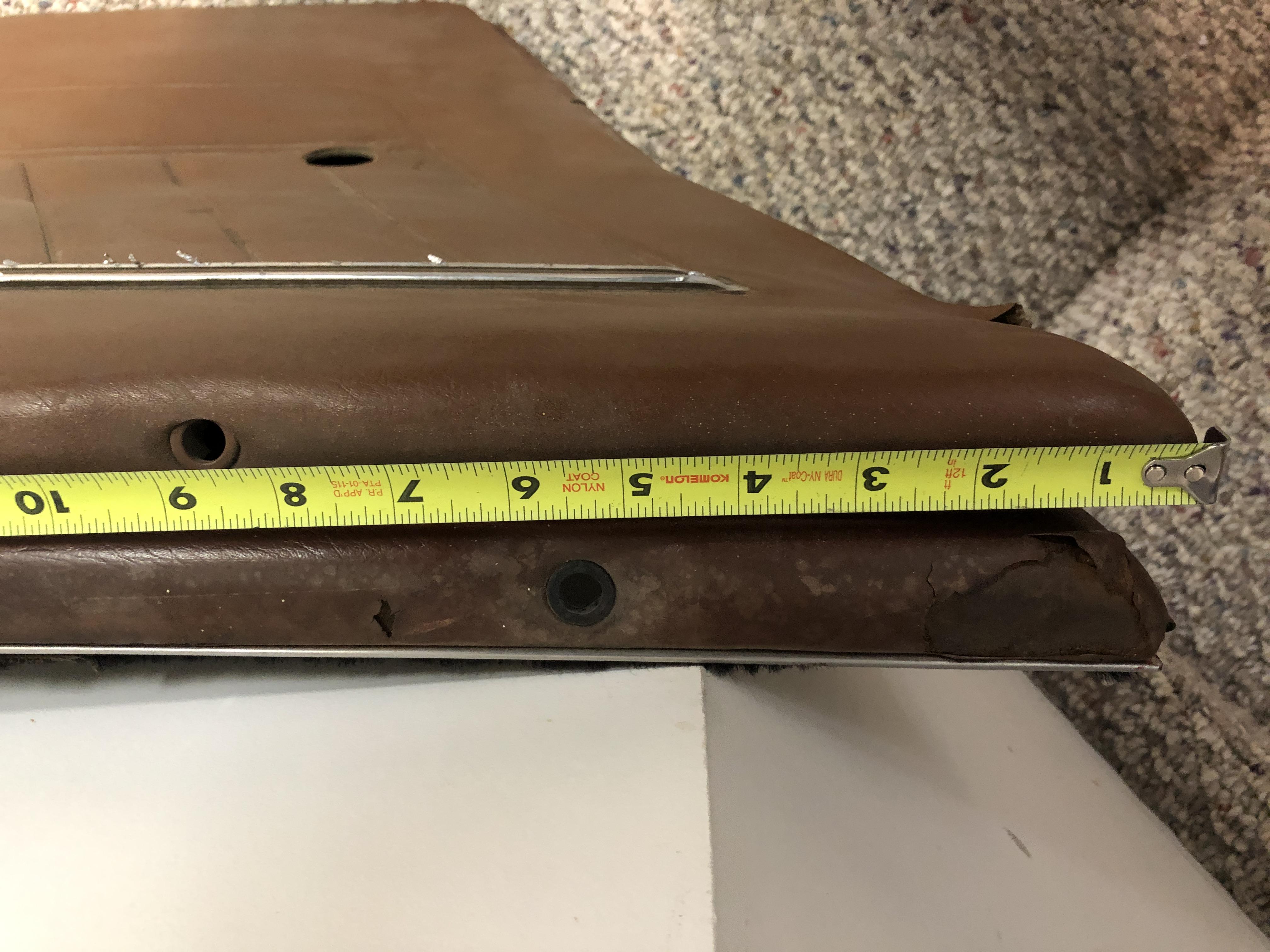

They are in very nice condition. I would ask that you measure the distance from the lock button hole to the end of the door card. If they are nearly 9 inches, they are not suitable for a North American 75 280z. The lock button position needs to be at 6”.

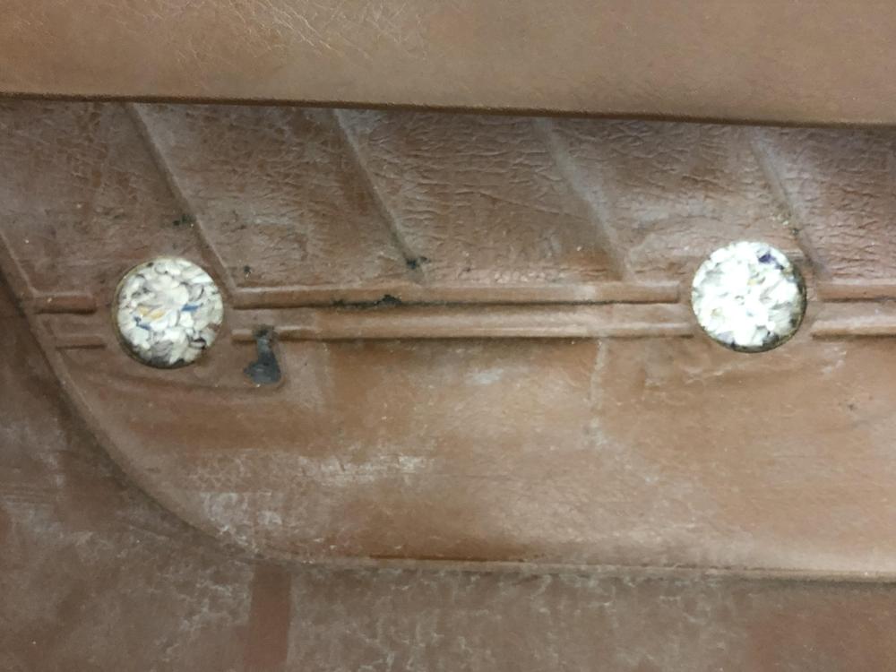

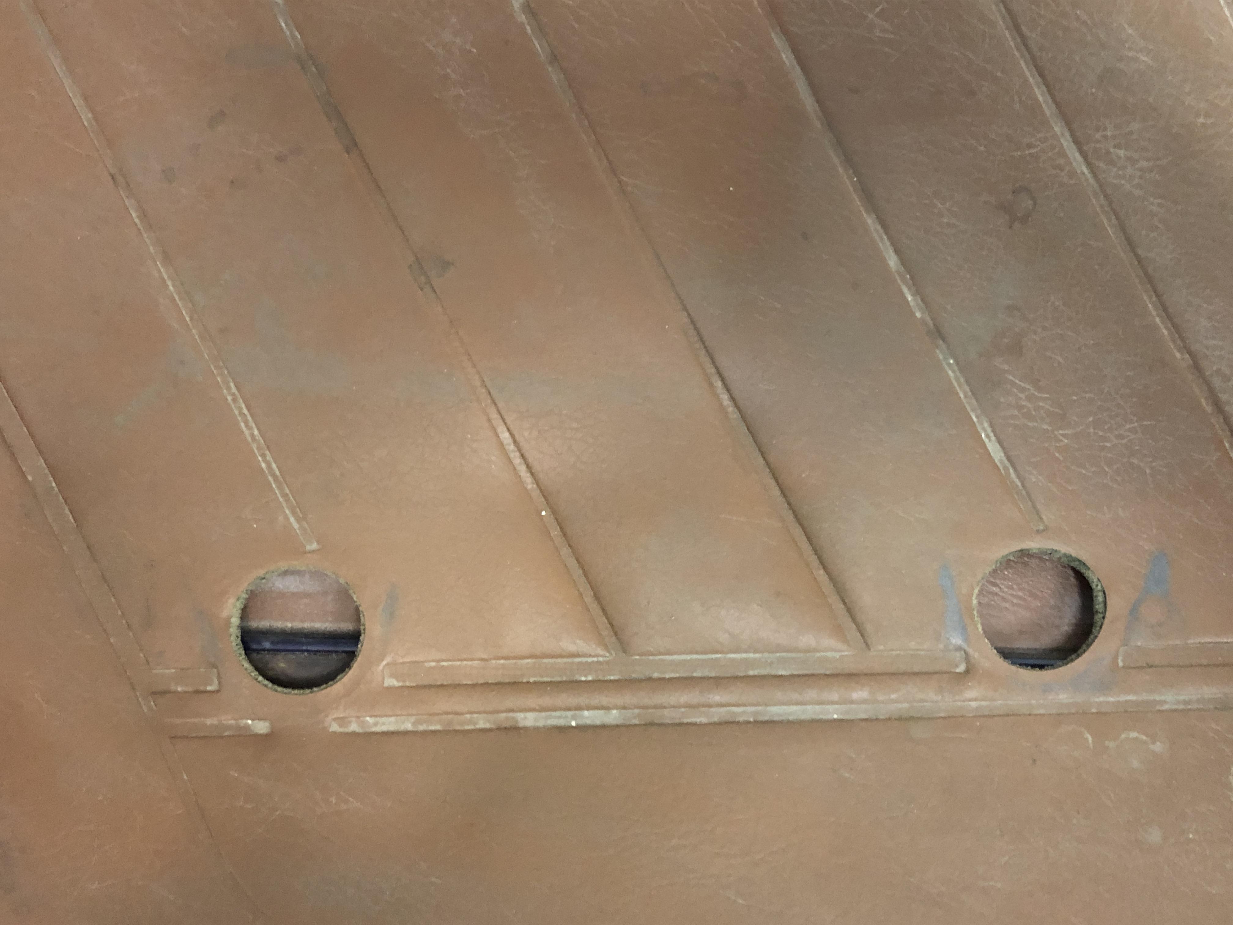

The other thing that I observe is the location of the two large holes where the arm rest mount through.
On the 74.5-76, the holes are lower and slightly back compared the later ones. You can compare them to the embossed lines as well.
74.5-76 the holes are on top of the pair of horizontal lines, while the later ones;
the holes are above/touch the upper horizontal line and don’t touch the lower one. You can use this to year ID any door cards when you can’t see the location of the lock button in any pictures you might see.
Here are two door cards with a ruler to show the lock button location. 77-78 on top.
Edited by zKars
This is the same set I looked at a year ago. They are not tight for the 75/76 model. They are the 76/78 style.
